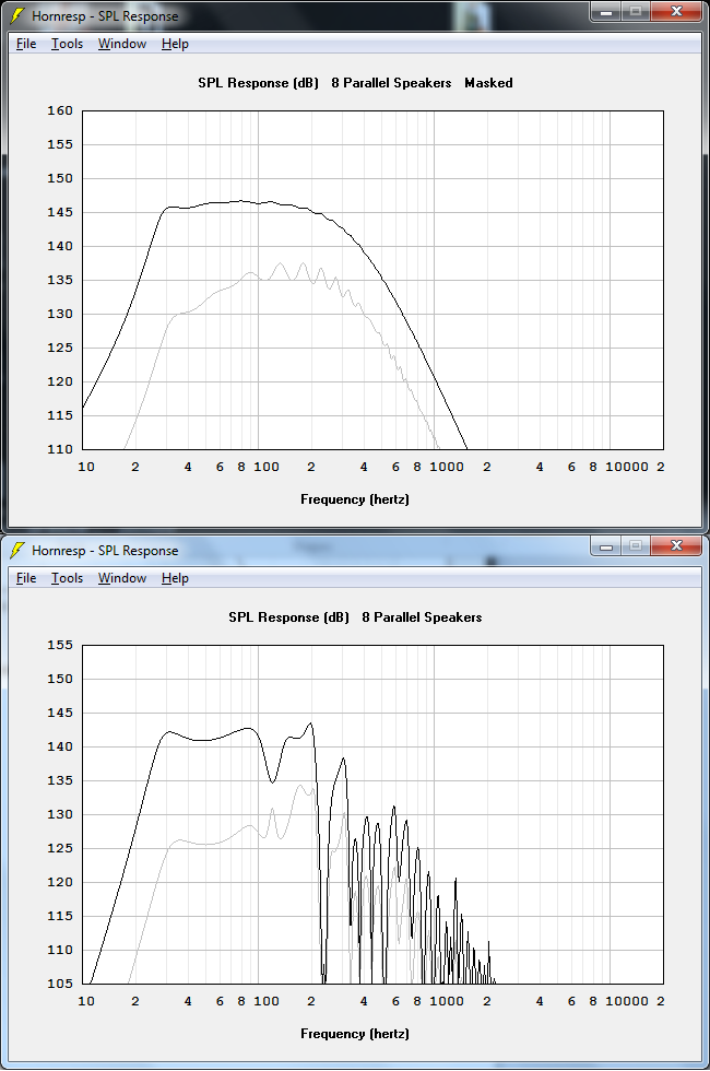

Pictures help a lot. This illustrates what I was trying to say.
First pic shows a single front loaded horn (light grey line) and a stack of 8 of the same horn (dark black line).
Second pic shows a single tapped horn (light grey line) and a stack of 8 of the same horn (dark black line).
In the tapped horn the dip caused by stacking multiple cabs isn't a big deal... unless it's in the usable passband.

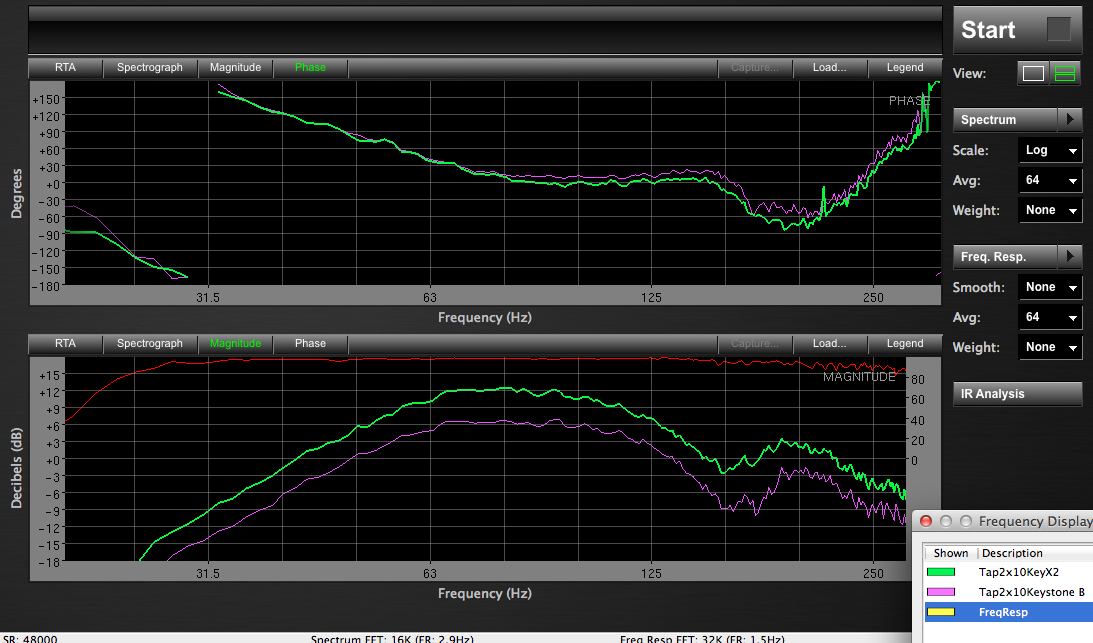

Hi just a guy,
Your example of "the dip" you described is the result of a compromise of the multiple speaker function in HornResp. The model used by HornResp to calculate the multiple speakers is based on the same model as two drivers in one large enclosure!
What that means is that in reality "the dip" in multiple coupled cabinets wouldn’t be that different from a single enclosure, if not better, just like weltersys showed you.
Another example;
Another example;

Hi just a guy,
I can't see how this would make any difference. I'm not a programmer and I don't know the math behind the Hornresp model but as far as I know, it only concerns itself with the axial path length and csa at points along that length, so one big box with multiple drivers or several small boxes is the same thing in the sim and in reality.
If what you are saying were true, it would be the same as saying if you took a tapped horn and added a solid line of bracing down the middle, all the way along the horn length, the response would be significantly different than if you didn't put bracing in. This doens't make any sense to me.
Another example;
The dip you are referring to in this pic is not the same dip I'm showing in my pic. In my pic, the first big peak shown in all tapped horn models turns into a big dip as more and more cabs are added.
In the pic you show that same peak is at 70 hz, and as you can see, as more cabs are added that peak starts to go away. Same as I showed (but in your pic the peak turns into a little pimple instead of a huge hole.)
The dip you are referring to at 120 hz in your pic is way higher in frequency than the first big peak I'm referring to, it correlates to the big dip at 220 hz in my pic. It doesn't matter much if that dip fills in or not, it's always going to be outside the usable pass band.
To be more clear about which peaks and dips are which, consider this. All tapped horn sims will show the first really big spiky peak (at 70 hz in your pic and 110 hz in my pic), then there will be another double peak a bit higher (at 90 and 100 hz in your pic and at 190 and 200 hz in my pic) and then there will be a big dip right above that (at 120 hz in your pic and 220 hz in my pic).
What I'm showing is a big peak in the middle of the passband turning into a big hole when multiple cabs are added, what you are showing is a big hole outside the passband being filled in as multiple cabs are added. Two very different things. And you example shows the same thing mine did but to a much lesser extent.

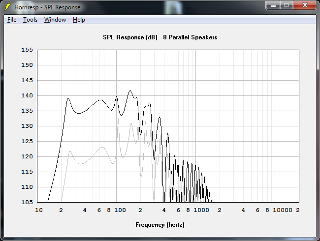

Here's another pic. This design is much closer to the way DSL designs tapped horns, and much less like the way the typical DIY'er designs tapped horns.
The light grey line is a single tapped horn, the darker black line is a stack of 8 of the same horns.
As you can see, this one doesn't have the big hole in response as multiple cabs are added but the peak at 100 hz is still greatly reduced even in this design. This proves that the problem is not Hornresp, the problem is the design. And since most people don't design like Danley does, picking a random tapped horn design off the internet and stacking it in multiples isn't the best choice.
(You might argue that this response doesn't look like Danley's measured results, especially the peak at tuning, but if you add some stuffing to the throat and mouth areas this would measure with the exact same response curve shape as the TH-Spud and DTS-10.)
The light grey line is not a simulation of a stack of 8 horns, it is a simulation of one circular exit of 8 times the area as one simulated cabinet.The light grey line is a single tapped horn, the darker black line is a stack of 8 of the same horns.
To come close to that in half space, a stack of 8 would look something like the diagram below.
