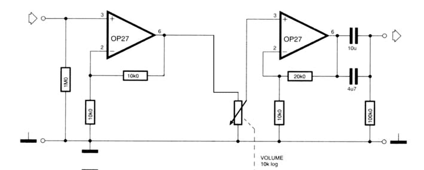

Consider this schematic. so is it better to leave it like this or put a buffer instead of unity gain?

It depends which one of the 2 x OP27 you mean and they're both not unity gain configured. If you replace the 10 kOhm for a wire at the first OP27 and remove the 10 kOhm from pin 2 to GND you'll have the (input) buffer. Same counts for the second opamp but then you have no gain anymore. I learnt that a buffer has the properties as described by rayma but with 0.99x gain. In short a gain of 1x. In most applications with normal 2Vrms sources you'll need very little gain and 2x or 3x is more than enough otherwise things might get nervous with normal gain power amplifiers like too high volume at 10 o'clock. It is better to add an input cap at the signal inputs in case the source has DC offset but beware for sources that already have an output cap -> 2 caps in series!
If you have normal 2Vrms sources it is even better to omit the first opamp alltogether, leave the second OP27 with a gain of 3 and just add an input cap and 100 kHz RC lowpass filter before the potentiometer. Filtering input signals is a good habit. Check your sources if they're DC coupled, it will make clear if you need input caps or not. A slight DC offset (that will be amplified 2x by the first opamp in the original configuration) can be enough to make the potentiometer scratch annoyingly.

With op amps, things are a little different. The op amp (+) input has relatively high input impedance,
and the op amp output has relatively low output impedance. So it acts as a buffer itself in many cases.
Most op amps can drive a 2k load well enough without taking any further measures.
The first stage has a voltage gain of x2 (+6dB), and the second stage has a gain of x3 (+9.5dB).
However I would reduce the 1M input resistor to a lower value, depending on the source, and
the value of any DC blocking capacitor present in the source.
You may be getting at gain structure considerations. For this you also need to know the output voltage of the source,
and the power amplifier input sensitivity. The idea is to drive the power amplifier to full output, without clipping any
of the previous stages, and without excessive noise.
