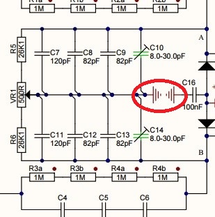

Perhaps adding a photo of other PCB side and how compensating capacitor are arranged (under resistor divider) would make even more clearer (if your device is still apart).

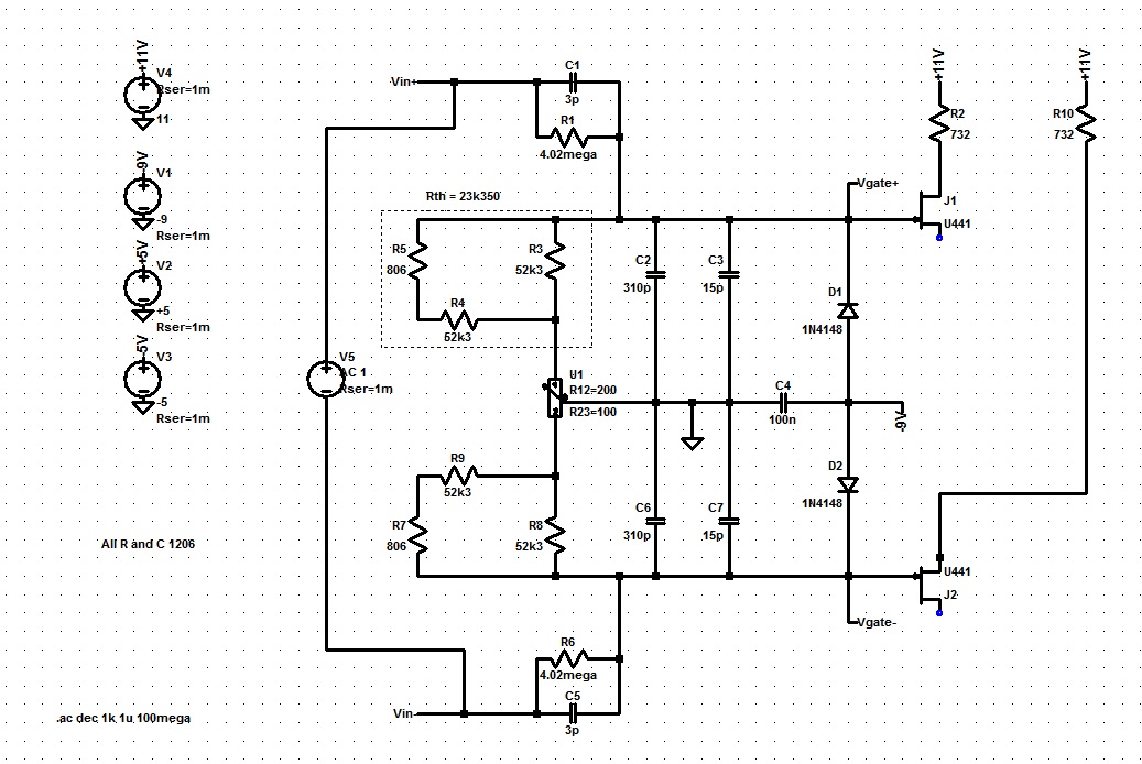

I am not sure about the 2200 pF in parallel... Checking the SMT version, reducing impedances to Zth, it seems like this: (just front end)
![simul1.jpg simul1.jpg](https://www.diyaudio.com/community/data/attachments/579/579746-4e10b62427ff22215b3d18e59c469352.jpg)

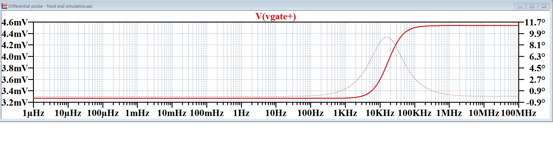

AC sweep analysis with 1V gives:

C3 and C7 are the variable capacitors.
At DC, ratio is ~ 150:1.
That seems odd for a 25 MHz spec. What am I missing?
C2 C3 against ~~26K is 9.6KHz, essentially as your graph says.
Counting on thumbs, C1 times 150 means C2 C3 and Silicon should be 450pFd. I see 325pFd. It seems unlikely the Silicon adds 125pFd. I think C2 could be bigger, and trimmable. Specially since C1 will have large uncertainty being so small.
