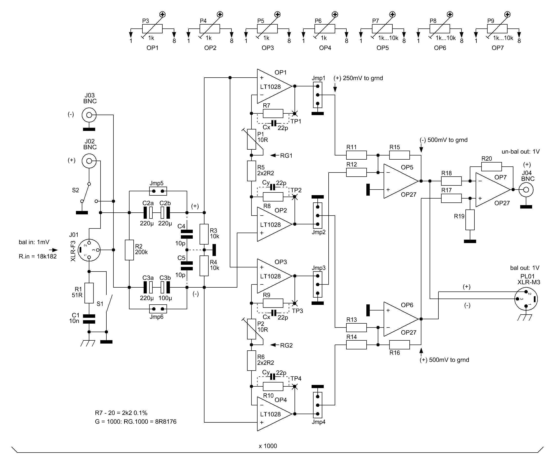

Here is part of the design I am working on currently. The bias is done differently, but the basic principle is the same.
I expect to use gains of 6dB, 16dB and 26dB.
The difference is very small, the two resistors sample the same average current of both FET's. The multiple CMRR trims look like a pain but if you want 100dB everywhere maybe necessary.

The reason for the discussion is the need of a sacrificial front end for the AP and QA400, and an HP403B. The AP is 100k/185 pF which is too low for vacuum tubes. I will build mine out per Sams PDF with the CCS he showed in the LA article, and include the option of pre-charging the DC blocking capacitors (a la the Tektronix 7A22N diff amp).
I think you should clearly define what you need that frontend for (or you'll get random "solutions" throwed at you). I assumed you're looking for a preamp with differential input to measure very low noise sources. If the task is to do THD measurements at high-voltage tubes you need something else, probably.

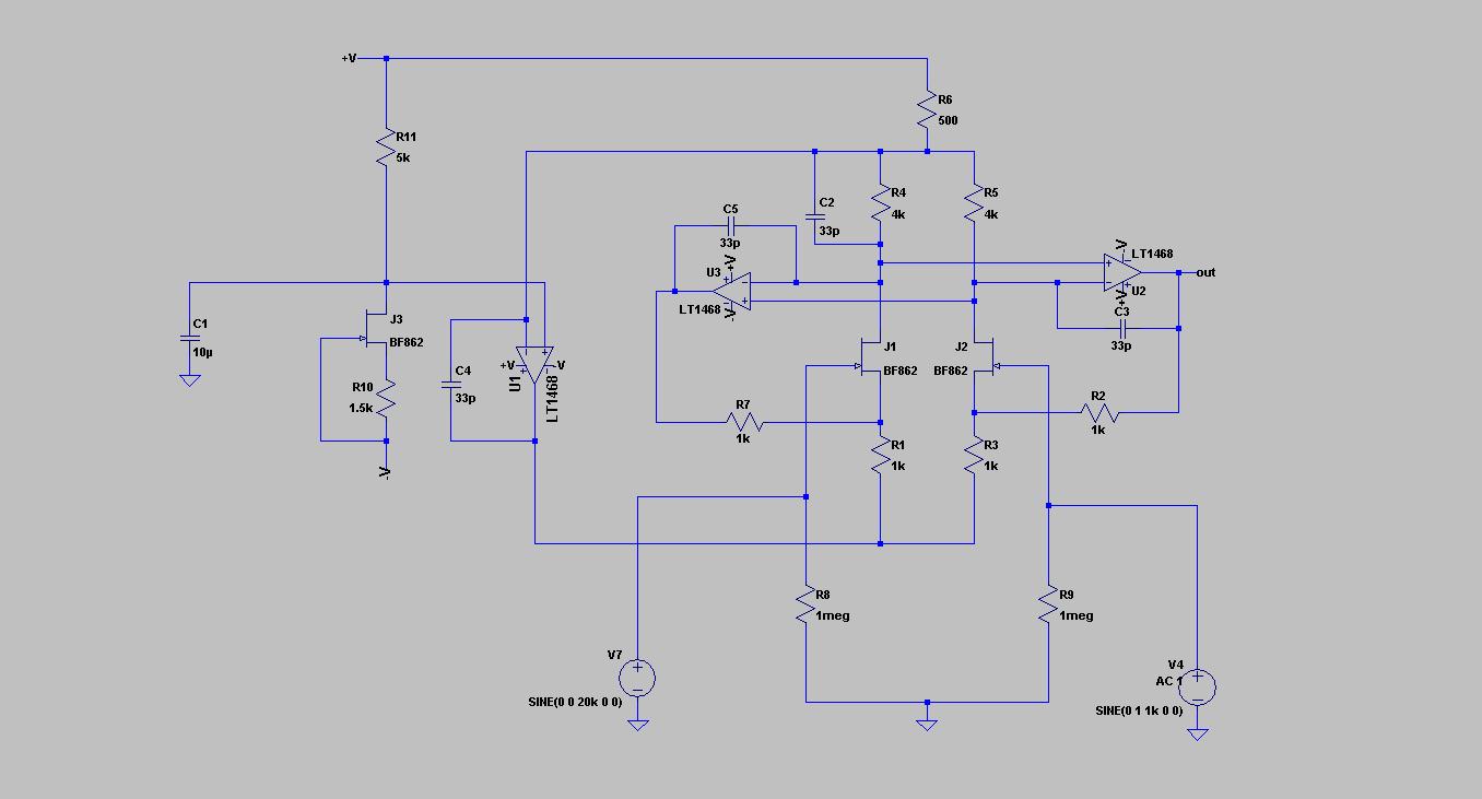

I've built Scott's diffamp but it keeps railing.
I've built 2 or 3 without a problem. Offset problems?
Input not ref to ground return?
it sounds to me like you have the feedback polarity swapped somewhere. It can be a bear to figure out.

This is an important point. Jen's application is the imput of a high performance ADC for measurements. Jackinnj's application is looking inside of a tube amp. They share some aspects but have some different requirements.
To optimize the design you need to address the following:
Input noise requirements
Distortion maximum
Gain options?
Maximum common mode requirements
DC or AC coupled
Max output swing
Input impedance requirements
For jen's application I'll add some numbers to focus the task:
Input noise requirements: approx -130 dB below full output in a 20 KHz band (equal or better than the SNR of the best available ADC)
Distortion maximum: -125 dBC for any harmonics (to be better than the best available ADC)
Gain: 6, 26 and 46 dB
Maximum common mode requirements: unknown at this time? Clearly limited by the power supplies.
DC or AC coupled: Both?
Max output swing: 4V (the next stage is differential so it really should be a differential output)
Input impedance requirements: very high and very linear so the input won't introduce distortion on the output of the source if the source is not low impedance.
These are some pretty challenging design requirements.
One comment on these designs; When used with a single ended source the common mode will be 1/2 the signal level internally. This means the opamp U1a output swings at approx 1/2 the input and needs to do a pretty good job.
Sorry I didn't think of it till this morning, but the common mode op-amp needs a common mode range near the plus rail. The SR circuit less so for the same result (but two more matched resistors). When I reduced the resistor values and voltage drops the op-amp is marginal unless it works .5 V from the rail, there are plenty of choices these days but it is easy to overlook.
