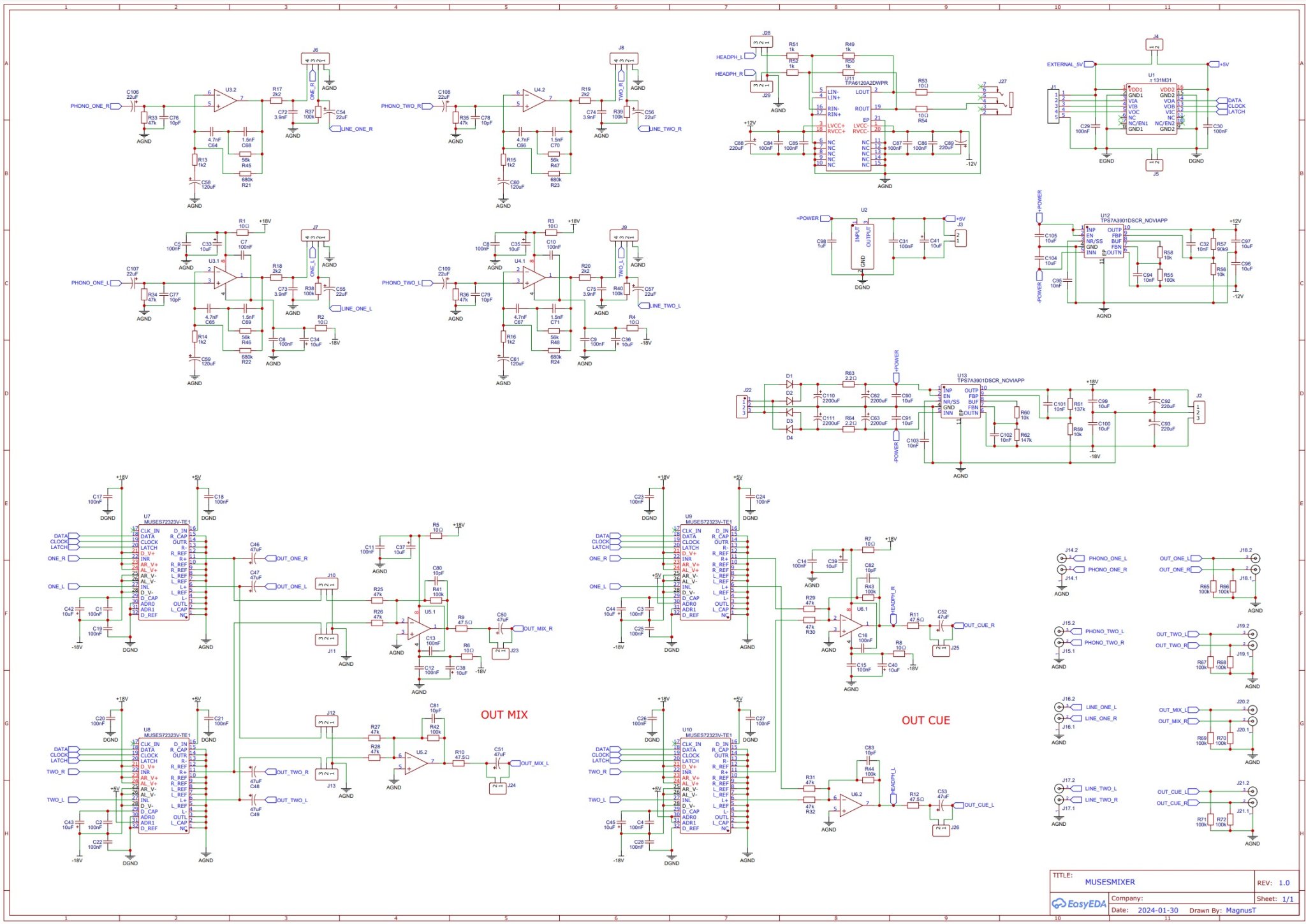

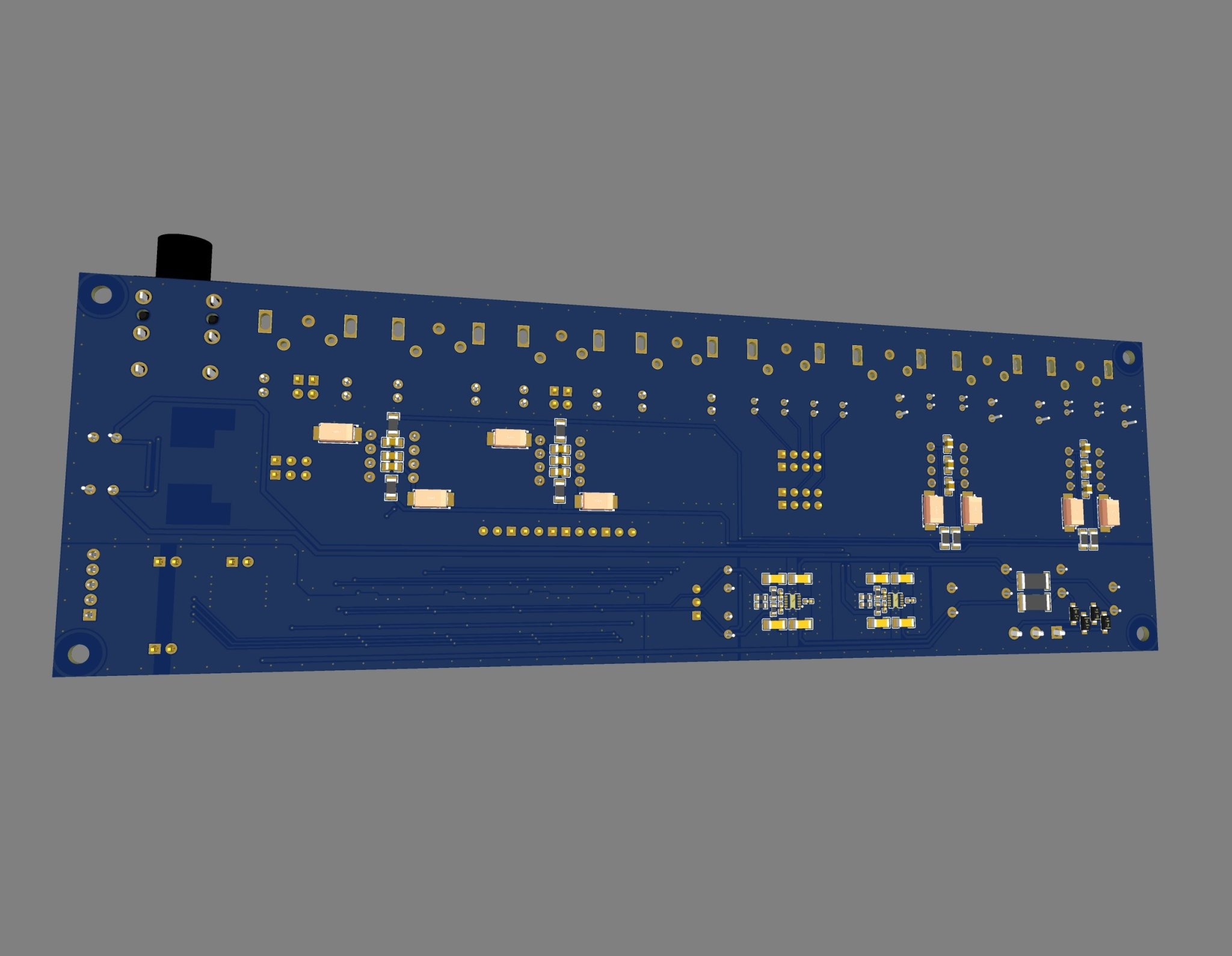

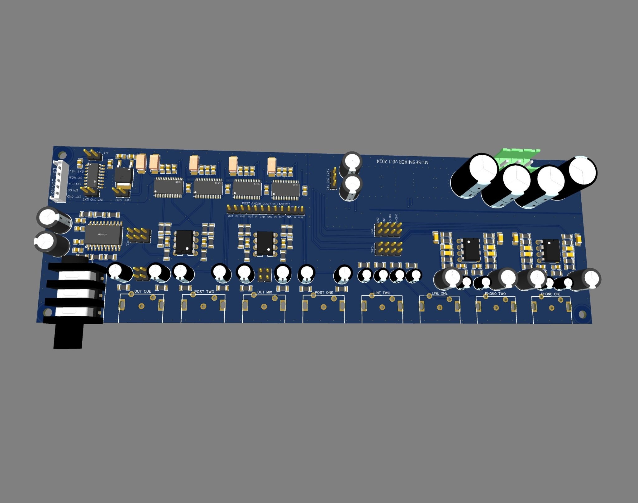

Since the board has 200+ components, mainly smd, I ordered assembled from JLCPCB, no way I'll do 200 by hand . Shipped today from China.
It's a fully "MUSED" DJ mixer, all control will be done with four MUSES72323 chips. Since you never know if you get things 100% right the first round (one rarely does) I tried to add many "good to haves", like room for power decoupling components in multiple configurations so i can try different OPAs, pin headers if I want to add tone controls, patch in effect boards, use other RIAAs, power supply stuff done so I can run it from either DC or AC sources trying different configurations out and so on and so on.... Even before getting the boards (minimum at JLCPCB are five boards where two are assembled) I've noticed two mistakes, one is just a mislabeled text saying 24V where it should say 18V and... I missed connecting AGND and DGND at the spot where I was planning to do it. That's an easy fix though, let's see what I find out more when I get the boards
Yesterday I wrote the bulk of the software to control everything from an external (isolated) ESP32 that uses a mix of pots, rotary encoders and a veeeery special crossfader.
Here's the schematic and a first version of the code. Comments are welcome, have I forgot something totally essential or done something stupid? 40 years since I last had fun designing analog audio stuff
Wow, that's a courageous undertaking, @MagnusT. Four Muses chips + OPAs! I'm guessing it's more for pro audio use than for audiophile HiFi.
What kind of visual feedback are you using (screen)?
Edit: I've just noticed that al 4 Muses chips are addressed together with the same latch pin. Interesting. I would have thought that you might want to set volume separately, but I don't really understand what the project does.
Edit2: Why are you using 18V? So far I've seen other projects use 15V. I know that the Muses chips can accept 18V, but was under the impression that it is the maximum, and that it's safer to use a bit lower voltage.

The idea is sort of an Audiophile DJ mixer I recently bought a cheap Behringer DJ mixer to do some rebuild/experiments on. It's built around 4580, 074s and a 2164 VCA. But I was shocked of the surprisingly awful sound quality so I decided to experiment on something more proper.
- the chips are addressed with their chip address pins ADR0 and ADR1, four combinations in total available, perfect for this project
- as with everything in this experiment/project, 18V is a starting point that I can change depending on what OPAs I use and so on. But with 12" singles generating very high output levels from MM cartridges in combination with man handling the vinyl while the needle is on it I thought the best head room possible wouldn't be a bad idea. But I am not 100% sure if 18V is "absolute max" or "a normal max to use" for some OPAs and the MUSES. So you have a point.
