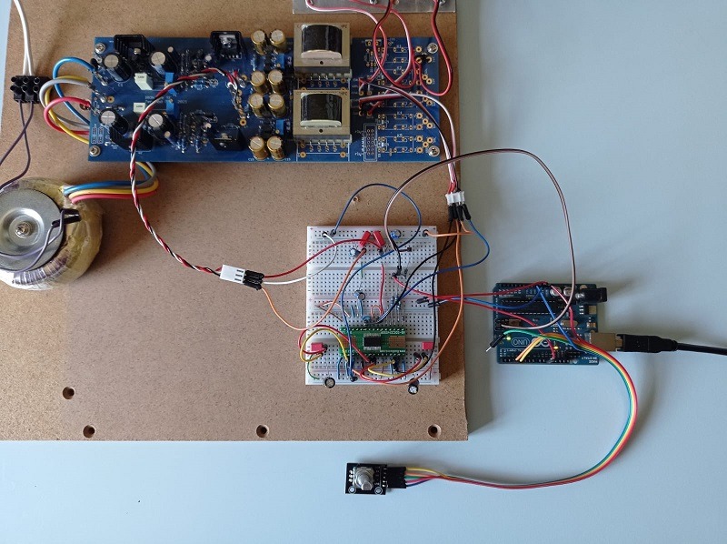

Did you manage to get a display to work?Good news; I managed to get the Muses72320 chip working on an Arduino Uno, with and without a library. The best result is with Christoffer Hjalmarsson's Muses library: github.com/qhris/Muses72320
Attenuation goes from -1 to -135dB which is very quiet, but not completely off. Setting attenuation to -447 is basically "mute".
The @alexcp code also worked easily on Arduino, but I can't get it to go very quiet, although Alex confirmed his setup does go very quiet. Maybe there's an error in my code.
I'm also pleased to announce that I managed to make the Muses chip work on the binary PSU supply of the IronPre. That means I don't need an external +-15V supply; just 5V for the digital block of the Muses. The "trick" is to separate the GND's of audio and the digital block. My gratitude goes to Zen Mod for steering my attention in that direction.
I'm now looking for a way to use the ESP32 for controlling the Muses... In its current form, the library doesn't even compile on the ESP32. Does anyone know how to port the library to ESP32?
-135db is apsolutly mute, you might miss gain configuration bits, take a look into datasheet there is not much number of registers and it is easy to configure without a need for any lib,
When I wrote: "Attenuation goes from -1 to -135dB which is very quiet, but not completely off" I actually meant that I can feed the library values from -1 to -135. Whether it corresponds with dB of attenuation or not, I'm not sure or convinced because at -135 I can hear very, very faint sound on 96dB sensitive speakers.
I'm happy to work with that because in my application I want to go from 0 to 100, therefore I'll use the map() function to convert the range.

I should mention that my project is still on breadboard so that I can easily make hardware changes if needed, but I think the Muses circuit is close to perfect as it is now. For mounting the Muses chip I used the adapter board shown in post #1. It has been working flawlessly for three days and I'm listening to music through it while I'm typing this.
PS: The unconnected green jumper cable is for the switch on the rotary encoder, which I don't need at this stage.

My code works as advertised, with level going from -111.5dB to 0dB in 0.25dB steps, then from 0dB to 31.5dB in 1dB steps. This was tested with my board and confirmed to you in a private message. BTW -135dB is not achievable with MUSES72320; it goes down to -111.5dB, below which is only MUTE, see the datasheet.The @alexcp code also worked easily on Arduino, but I can't get it to go very quiet, although Alex confirmed his setup does go very quiet. Maybe there's an error in my code.
Also, I have a more advanced formware which is not public yet. I posted a video of that code working a while ago.
I have no doubt that your code works fine for your boards, Alex. The 0dB to 31.5dB gain is achieved with external opamps, and not inside the Muses chip. I suspect that your code didn't work 100% for me because I am not using opamps for gain, while your code addresses opamps on your boards. I'm using the Muses with the Iron Pre which already has 6 or 12dB gain (selectable with a jumper), thus I have no need for opamps. I suspect your code would work for me if I could eliminate the gain instructions in the code.
Sorry for the misunderstanding around the "-135dB". The Muses library addresses the -115.5dB attenuation, which is native to the 72320 chip by multiplying by 2 so that the attenuation steps can be addressed with integer values. l realized that last night after delving into the library code and saw that inside the library, the integer value gets multiplied by -0.5, effectively halving it again. I erroneously called those integer steps dB in one post and then someone picked up on it and repeated it. It is NOT -135dB as you rightfully pointed out. The library accepts integer values from 0 to 223, which is 115.5 * 2. At -135 (not dB, but steps), attenuation is enough that sound is barely audible.

Here is my short analyse and short example, hope it help for understanding how to control Muses, the rest of mathemnatics keeping for you : )
Code:
volume:
#define VOLUME_BYTE_MIN 16
#define VOLUME_BYTE_MAX 239
if (volume_byte < VOLUME_BYTE_MIN) volume_byte = 0;
if (volume_byte > 0 && volume_byte < VOLUME_BYTE_MIN) volume_byte = VOLUME_BYTE_MIN;
if (volume_byte > VOLUME_BYTE_MAX) volume_byte = 255;
if (volume_byte < 255 && volume_byte > VOLUME_BYTE_MAX) volume_byte = VOLUME_BYTE_MAX;
gain:
#define GAIN_MIN 0
#define GAIN_MAX 63
if (gain_byte == 64) gain_byte = 0.5;
if (gain_byte == 80) gain_byte = 16.5;
if (gain_byte == 96) gain_byte = 32.5;
if (gain_byte == 112) gain_byte = 48.5;
formula:
0 - ((volume_byte x 0.5) - 8) + (gain_byte x 0.5) = volume_db
example:
0 - ((17 x 0.5) - 8) + (9 x 0.5) = 4db
0 - ((0b000010001 x 0.5) - 8) + (0b00001001 x 0.5) = 4db
0 - ((0b11101111 x 0.5) - 8) + (0.5 x 0.5) = -111.25db

Look at page 12 first, you should notice 16 bits D15 to D0, every D represent bit value and what every each mean, so in short explanation you need to set the right control data bits (see table what each bit mean), when you set right control bits you need to send it to Muses. Its allways writen in 16bits (or two bytes). Post above is just for how to calculate volume level by setting booth gain+volume, you will need to understand it first and add your own loogic for it, I'm just wrote few examples which you can compare with tables from datasheet to understand, my hope it is easy for you to understand that configuration bits and in the same time gain+volume settings of the Muses. I never using any libraries, instead I always writing my own logic by looking into datasheet : ) Writing this because I do not found complete Muses library on the net, expecialy didn't found any logic for step=0.25, my examples with a further mathematic work might help for completing those libraries.
I really appreciate you taking the time to explain how it's done. I will certainly study your posts and see if I can do it.

Question: If I don't want any gain, but just want to set volume, how do I write that into the registers? Is there a separate command for writing volume? In other words, is it possible to ignore gain and just set volume?
I guess I'm asking if the 16-bit command structure is made up of gain + volume or are they set independently?
Sorry, I realize these are very much beginner questions, but I have to start somewhere. 😵
Yes, see my formula! Volume is sum of (0 - volumebyte + gainbyte). You can even set step 50, or step 100, or step 1, just right D bit configuration need to be set! And a bit of mathematics too is need : ) . Thats easy to understand if you look into page 12, try to understand each D bit first! Writing to Muses is always in 16bits, so for example you want to set volume_db=-111.25db for example to left channel (take a look into bits D5 and D4 on table on page 12) you need to set bitD4=0 and bit D5=0, also you need to st cont1, cont2... every other bit from D15 to D0, for example to get volume level for left channel=-111.25db (see my example) you need to set all bits for example like this:
11101111 (D15-D8) Lch Volume Control (Att.) in my example its volume_byte
0000 (D7-D4) address for Lch Volume Control (Att.)
0 (D3 is always zero)
000 (D2-D0) hardware pin address configuration
so now you have all 16 bits which you need to write to Muses:
11101111 00000000
for example if you convert 11101111 to decimal you getting 239, use formula from my example. Configuring everything is trought right D bit value, for example if you need to set right channel just change corensponding D bit value in our 16bit container. Whole formula from my example post need to be reverse enginered, for example you should use volume_db in your mcu code as a changeable value, you just need to define step size, and reverse enginer my formula for volume_byte and gain_byte which you need to write to corensponding D bit register. A bit of more work is need for mcu code, but my hope example I have gaved is easy to uderstand including explanation about D15-D0 which you need to understand from datasheet. Understanding bits from datasheet is helpfull for understanding every other ic without a need for any library.

Fantastic, I understand all of it so far. The 16-bits contain all the info to send to the chip, from the volume D15-D8, the channel D5 and D4, and finally the chip address with D3-D0.
So, reverse engineer means taking the desired dB and calculate what D15-D8 should be and adding the remainder of the D bit values?
yes! : )

Great. I'm looking at your example formula: 0 - ((0b11101111 x 0.5) - 8) + (0.5 x 0.5) = -111.25db but I have no idea how to code that calculation. Is it done with the itoa() function in C++ (for Arduino)?
Obviously one has to stay within the MIN and MAX constraints of what the chip can handle, set by the if statements you gave previously.

0b11101111 is binary value, use 11101111 and put in converter I have gaved, you can use hex, dec or bin it is the same when using formula! Writing in binary form is better for understanding when you looking into D15-D0 from datasheet : )
0b11101111 is the same as 239 is he same as 0xEF
0.5 or 111.25 is a float value, whole formula is an float value
You can predefine an hardcoded 16bit value for test in your code without any math, use math trought google, for example predefined 16bit value looks like this
