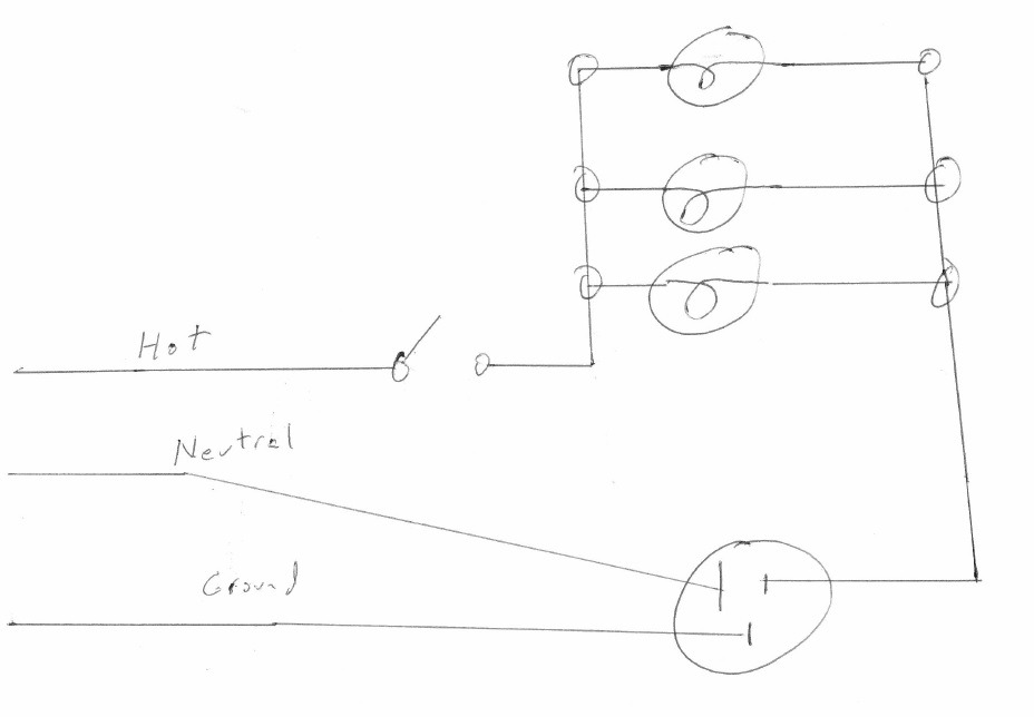

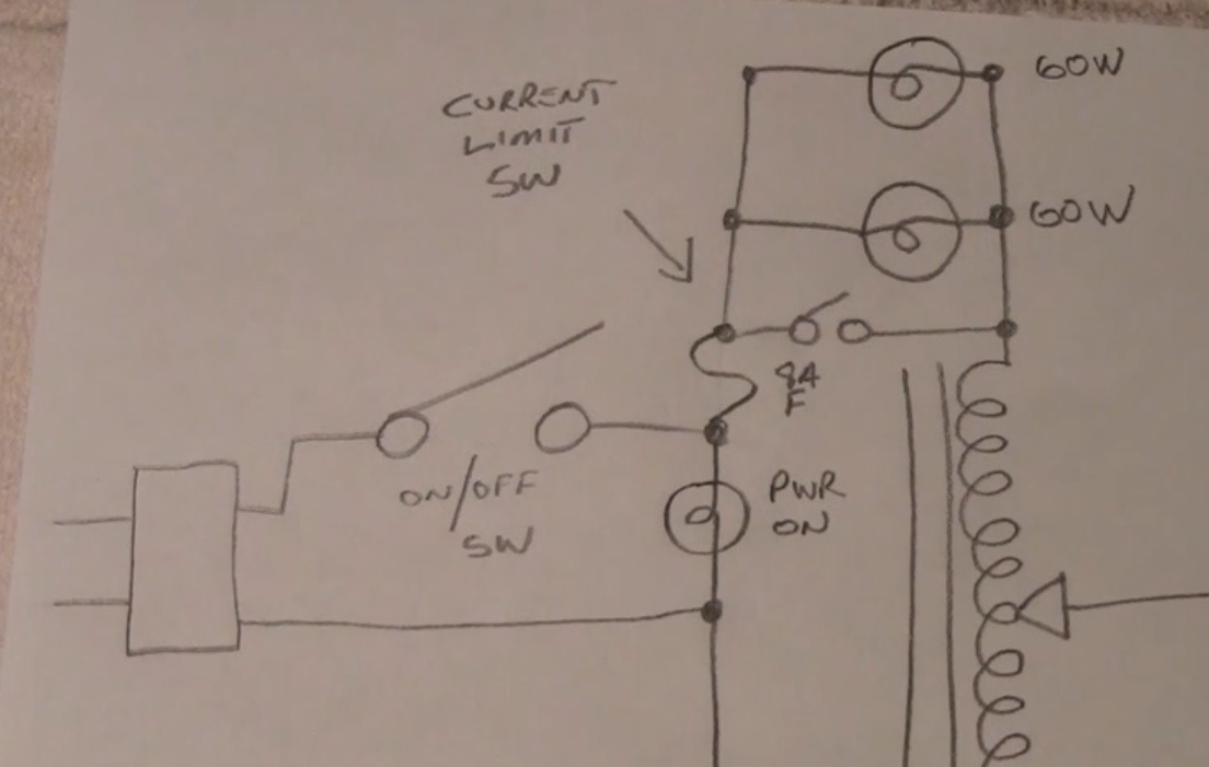

I have a QSC PLX3402 that has been in storage for a couple years. I recently powered on another amp that was also in storage and it promptly went "BANG!!" as soon as I turned it on. I'm in the process of troubleshooting that one. I have since learned about Dim Bulb Testers and I'm going to make one. My question is what wattage should I use for the bulb? The manual for the PLX3402 says it uses .9 amps at idle. .99A x 110V = 99 watts. If I use a 100 Watt bulb, wouldn't that allow all the current the amp needs and therefore not offer much protection? Or am I completely wrong on this? I have read that 100W is good for "most amps" but I'm not sure if this amp falls into that category. So what would be the best wattage to use here? Thanks

No. The lamp and the amp will be in series and share the voltage between them. Neither one will receive the full 110V.The manual for the PLX3402 says it uses .9 amps at idle. .99A x 110V = 99 watts. If I use a 100 Watt bulb, wouldn't that allow all the current the amp needs and therefore not offer much protection?
Unfortunately, it is not easy to calculate how the 110V will be divided between the two since neither one is a linear device and they behave differently when they receive less than the full rated mains voltage. Two 100W incandescent bulbs will receive 55V each but the situation is different when you connect different types of appliances in series.
Maybe you should start with a lower wattage bulb. That will limit the current to a lower level and produce a smaller bang if the amp has a serious short circuit. If nothing blows up, you can step up the bub wattage.Or am I completely wrong on this? I have read that 100W is good for "most amps" but I'm not sure if this amp falls into that category. So what would be the best wattage to use here? Thanks
Remember that you must use an incandescent bulb, not LED, fluorescent or some other type of device.

I hope I'm not opening a huge can of worms here, I'm honestly just trying to find a safe way to power this thing on. Here is a video of a couple high power class D amps and he is using the dim bulb tester when powering them on. The link is time stamped: Dim bulb with Class D amps
With a SMPS (Switch Mode Power Supply) neither a Dim Bulb Tester nor a Variac will accomplish much.
With a SMPS, if the line voltage is low it just draws more current, to reach it's steady state value.
If the line voltage is high, it draws less current. It acts some what like a negative resistor.
