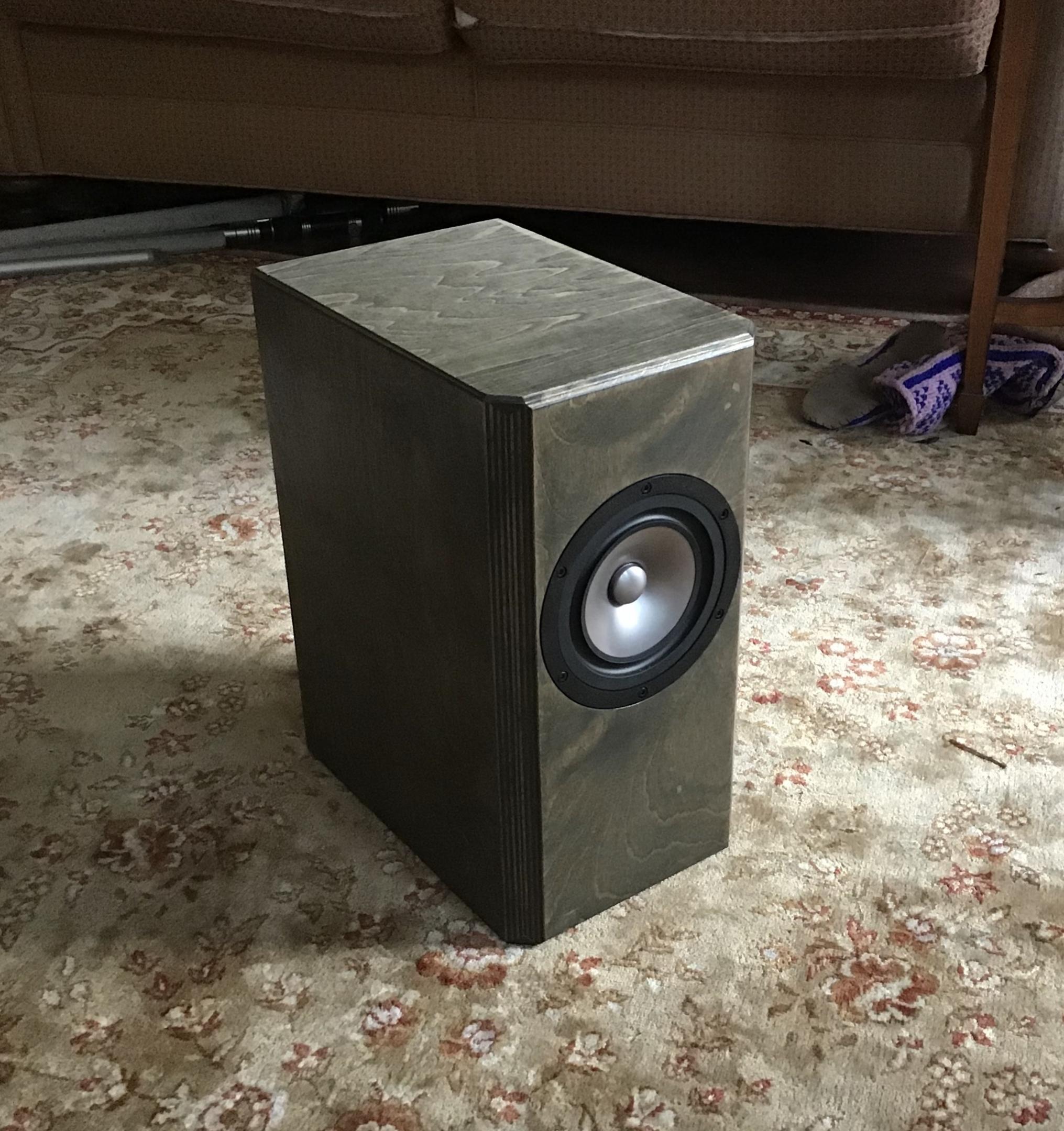

Often, it helps to start somewhere manageable, with a simple but great project. This gives you a point of reference to know what you want from a larger project. It may equally bring you just what you want, leaving you with the dilemma that you want another project but have no justification for it!
As an example of a simple project would be a single driver, full range speaker with no electrical cross-over. It’s also an example of something that may open your eyes to the sonic benefits of simplicity from which you will change your future direction. It might equally be an end point, it has the potential to be that good.
I’ve built a few speakers (Audio Nirvana 15” and smaller) and can strongly recommend a high quality birch ply bass reflex box around the MA Alpair 10.3 or Alpair 10p. It will be tough to beat these even by spending more money.
