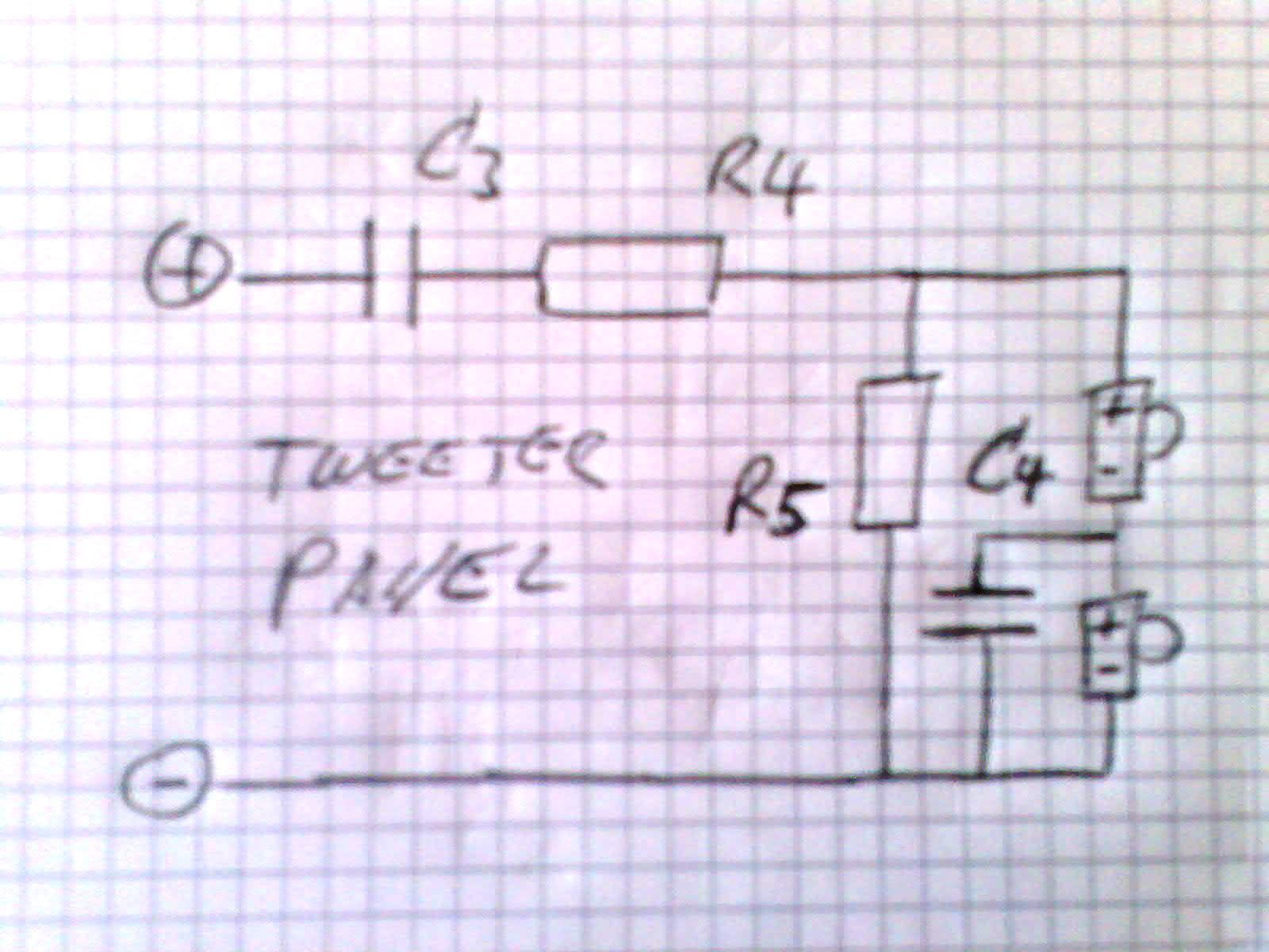

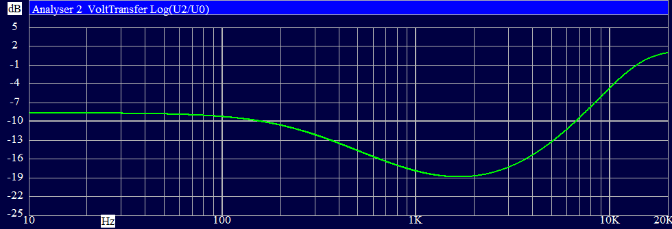

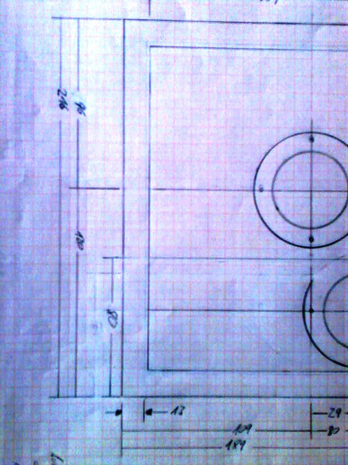

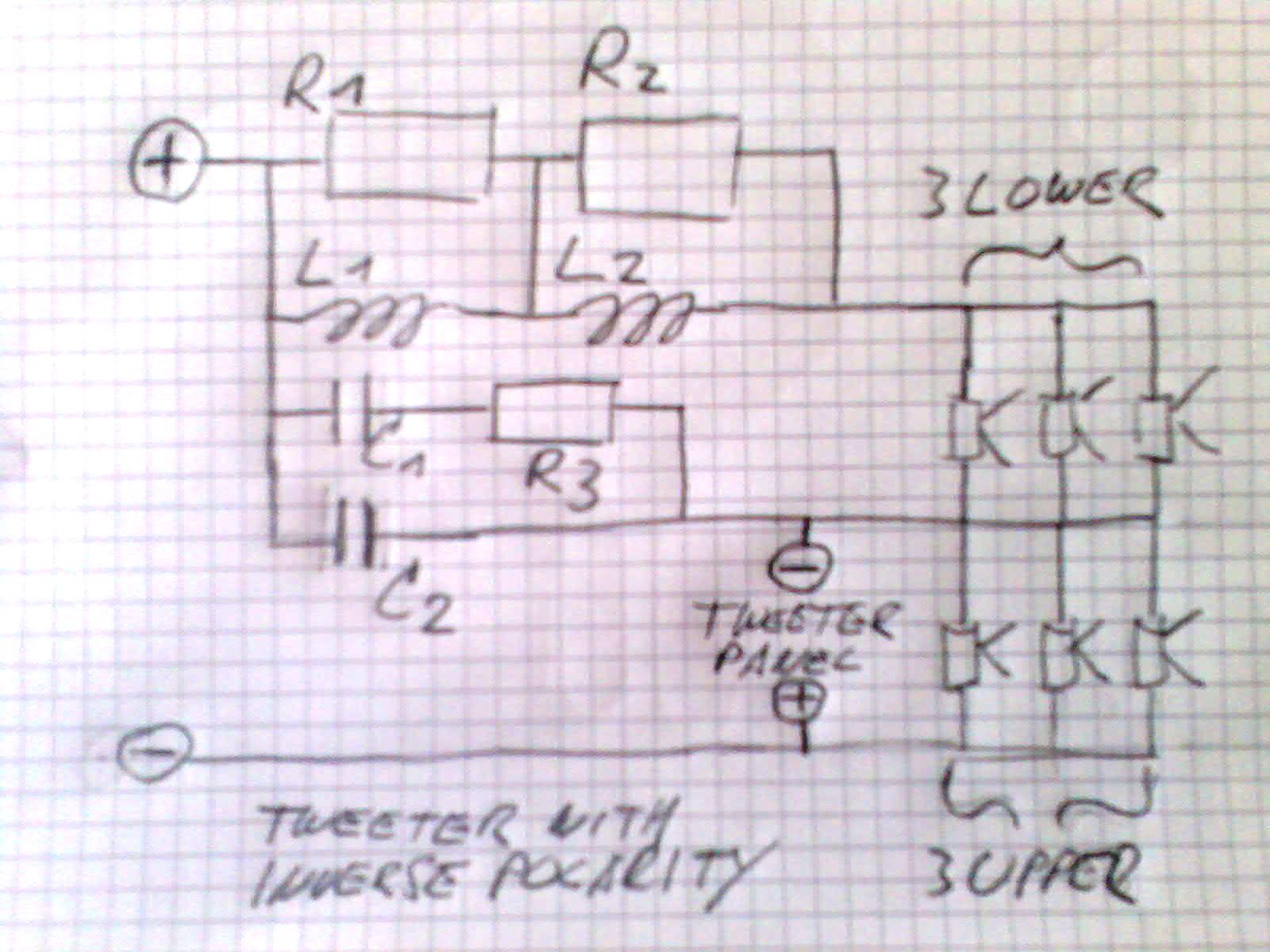

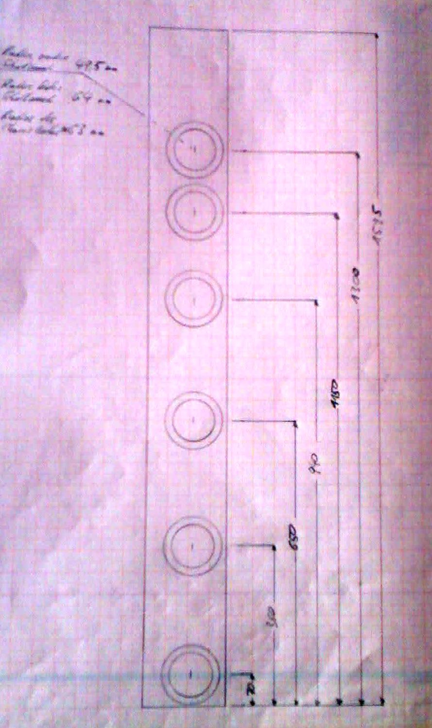

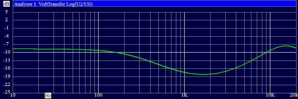

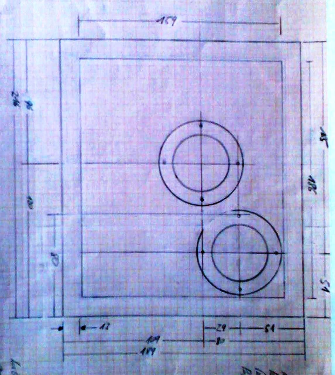

Hello,
for DIY'ers who would like to build a "dipol 08" style
speaker for private use, i decided to post some raw
sketches (of the baffle dimensions at least) and a list of
crossover parts as a start.

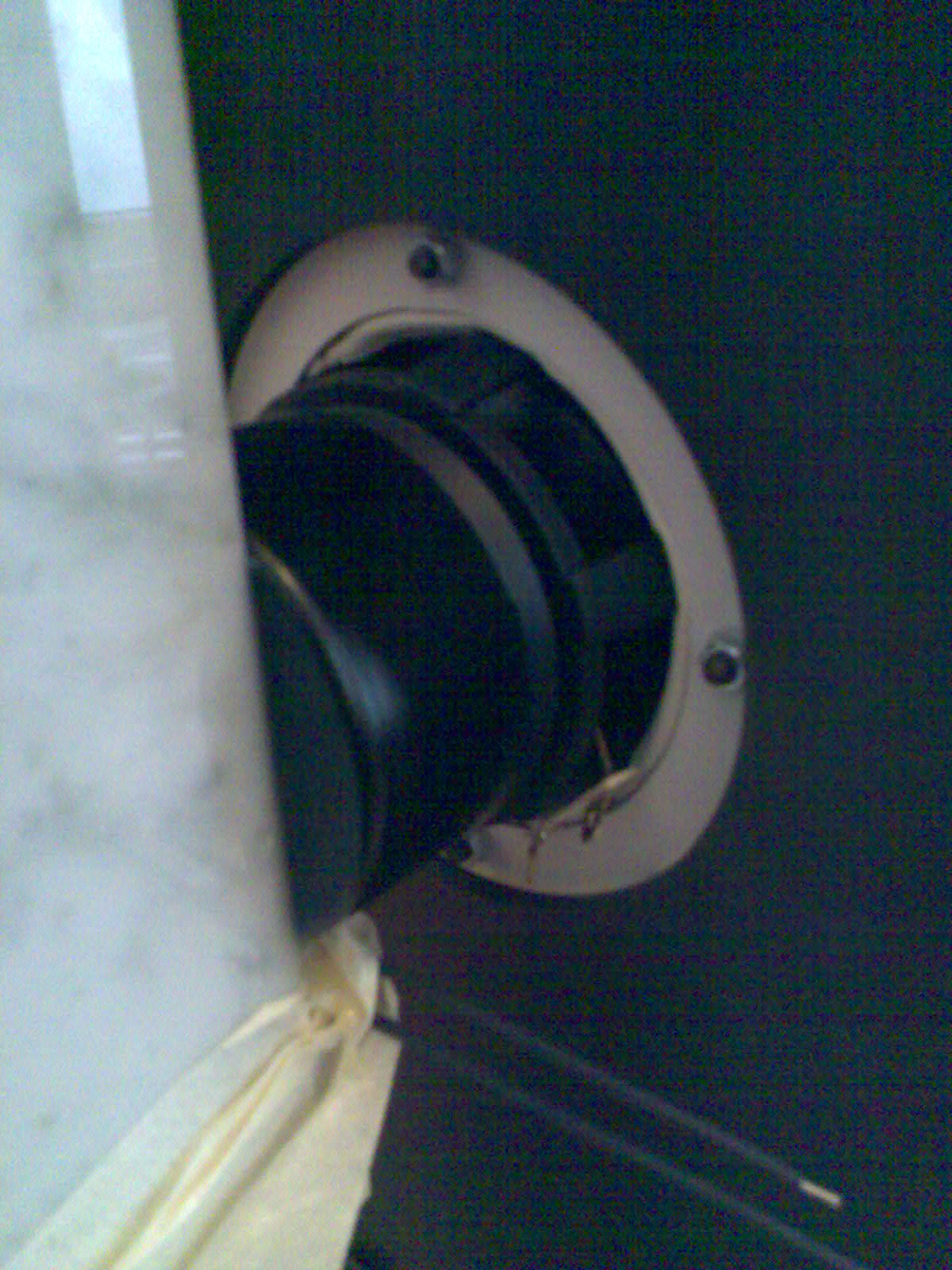

The baffle should be executed with conical driver cutouts
on the rear and be as rigid but thin and highly damped as
possible. I used a composite with a constraint layer
damper inbetween.

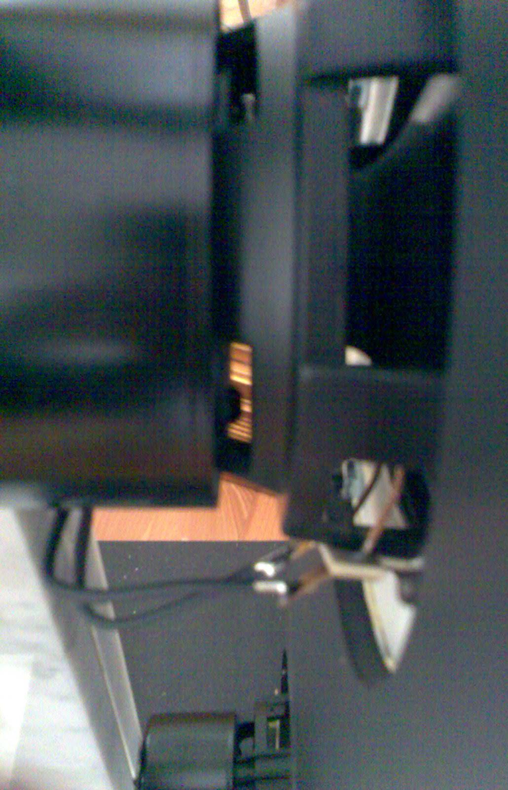

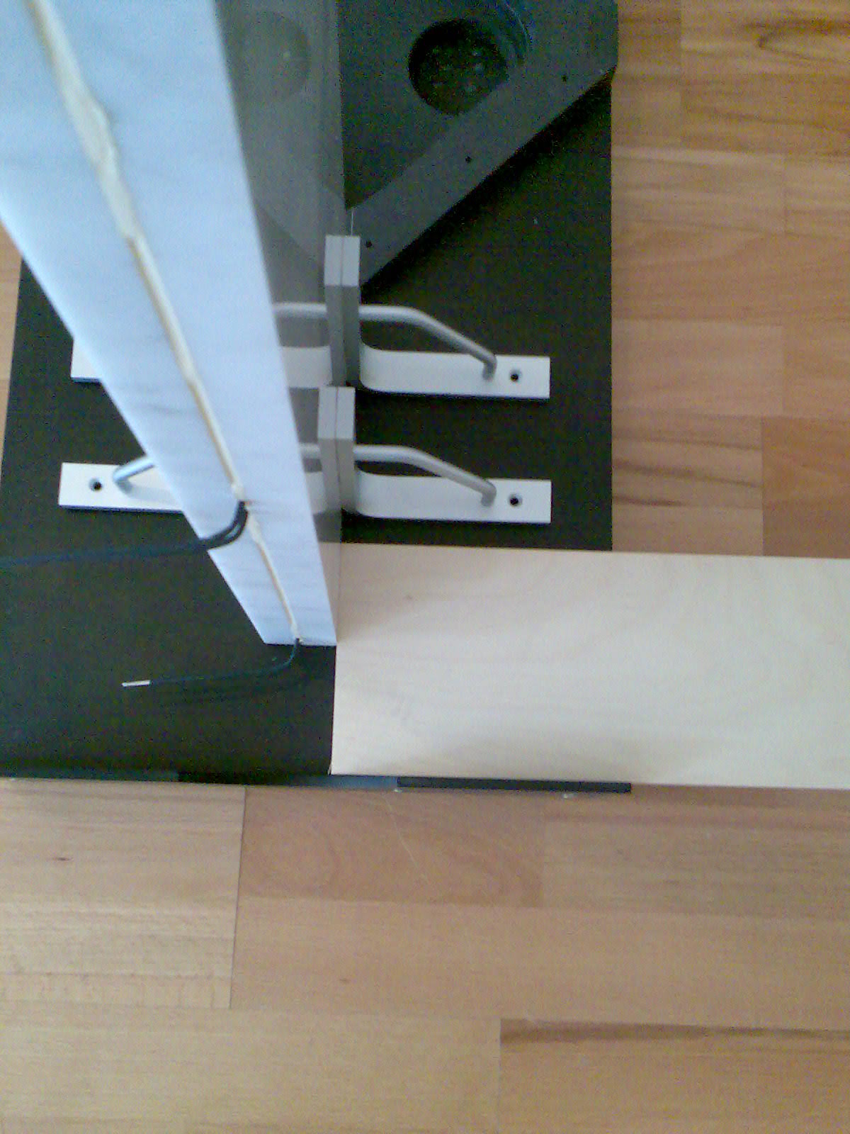

Many variants are possible including "omitted backbone"
for less effort or "reduced size lady edition" ...
Nevertheless, the backbone damper including magnet
mounting of the drivers improves the quality of bass to
midrange reproduction a lot and makes up a good part of
the fascination coming with this speaker.
The backbone is mouted flexibly and damped to the foot
and has a resonance as a "standing pendulum" of approx.
5Hz in my version, when the foot is "clamped" to the
bottom (which is not done usually during operation).

Dipol 08 is easiest crossesd in using a 1. order passive line level filter
("PLLXO") at 80Hz. Fullrange operation is possible, but dynamic headroom
is less. Without subwoofer only some chamber music and few jazz recordings
are enjoyful to my taste ...

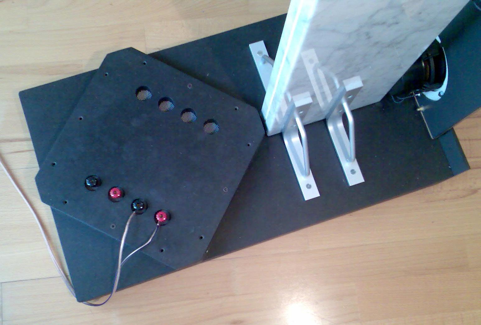

Since the driver positions are badly readable on the picture
of the handsketch, please refer to the attached text files.
Kind Regards
  • Dipol08_TweeterProperties.txt
  • Dipol08_CrossoverPartsAndBaffleSize.txt

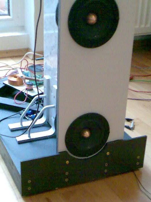

I used 2 sheets of High Pressure Laminate
(6mm thickness each) with about > 2mm dampening glue
inbetween.
Rear sheet with larger driver cutout .... to make it more
"open" to the rear.
That is not an optimum material, but since the excitation
is very low - achieved by the magnet mounting - it is
OK. Without backbone it would also be too floppy due
to it's height ...
I would try something different in the next one ...

Ed, i am with you in most points.
But please do not forget the excitation of the baffle
due to sound pressure, having opposite sign on front
and rear ....
Dipole 08 has kind of purely magnet mounted drivers,
if you knock against the driver baskets from the front,
excitation of the front baffle is close to nothing.
A rather soft, highly damped but dense baffle material
like some rubber granulate e.g. is surely interesting,
but even for pure magnet mounting
("baffle gasket only") you will need at least some
stiffness to withstand deformation due to sound pressure
at low frequencies ....
And we still need that stiffness without the baffle being
extraordinarily thick.

Thank you darkmoebius,
and here comes the first correction:
1) The 1st picture (Baffle Sketch) shows the LEFT speaker.
The text said otherwise ... sorry, uploaded a new version.
FR is more balanced - as in almost all OBs - when
the shortest path between drivers an baffle edge points
inwards while listening.
The tweeters are placed accordingly:
Shorter path to the edge inward pointing while listening.
2) Remark: Since there is only one of the tweeters
playing to the top frequencies, its position would
normally be chosen closer to the uppermost fullranger.
I decided to do different, as the more asymmetric
position of the lower tweeter is likely to produce
more unwanted reflections with the backbone.
So it is the upper tweeter, reproducing the
highest frequencies, which can radiate more freely
with the given backbone confguration.
Cheers

Wiring of the drivers could be simplified now,
but as the crossover design was not settled
is was easier to have the to connectors of upper
and lower drivers group accessible separately
in the croccover ...

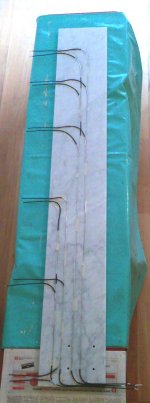

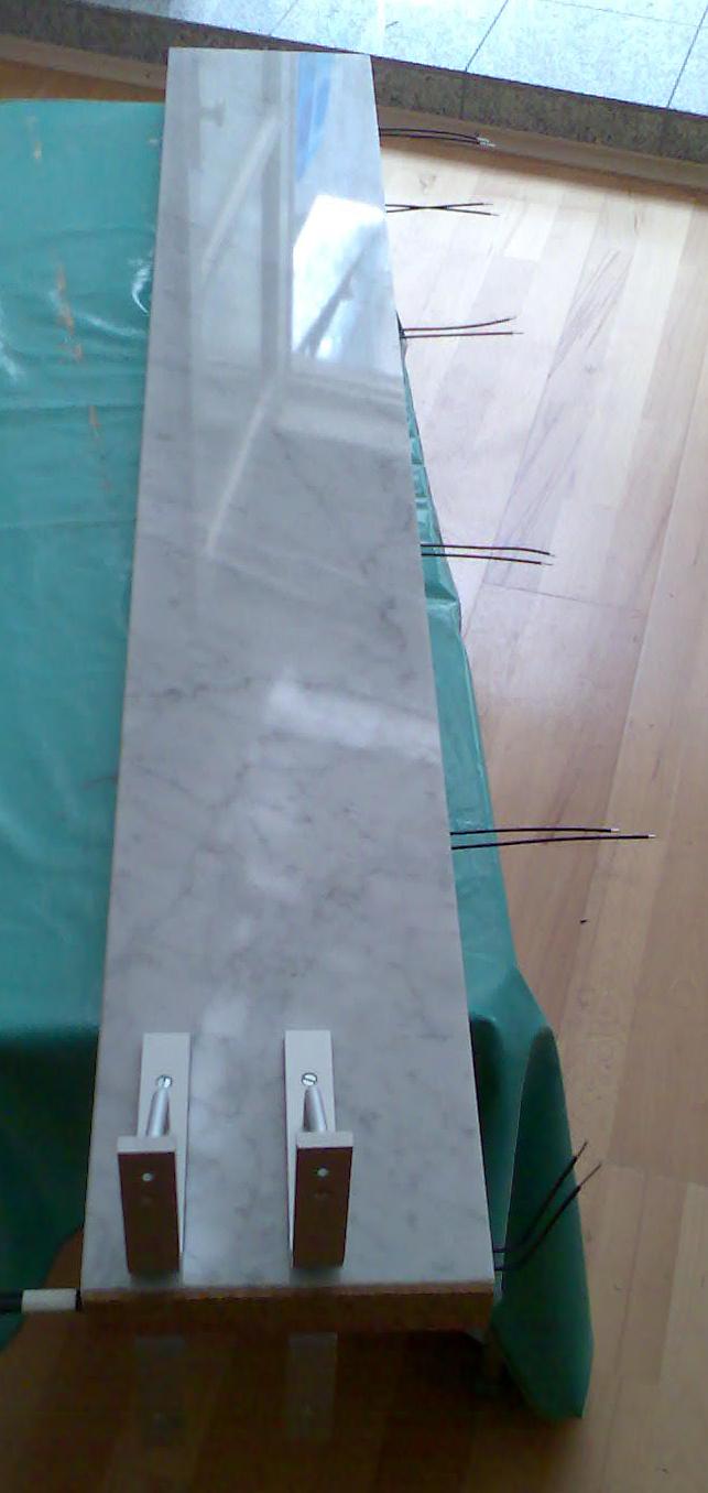

Mounting of stand and spine ...
Left speaker being built,
optional rear muffler,
first crossover tests,
crossover cover closed with
1st version of crossover builtin ...

Hello CLS,
nice to meet you here ...
i observed something - which may point into that
direction - when i was tuning the rear tweeter panel.
I decided for that tweeter panel, because asymmetry
in dispersion of upper presence and brillance region
led to inconsistencies.
When tuning the speaker to have sufficient "sparkle"
to be experienced at all "useful" listening positions it
turned out that it sounded unecessarily sharp or
"beasty" with some music.
The drawback of rear radiation dropping in the highs,
could not be compensated with the front radition.
That was why i made the rear tweeter panel, but
since i did not want it to spoil homogeneity i listened
very carefully while tuning the tweeter panel's
crossover and i also listened at very low levels ...
In that situation the tweeters could also be driven
"fullrange" (mind the L-Pad), so i omitted the
capacitor "C3" for a while.
I experienced, that the subtle effect of the tweeter panel
was improved at low levels, giving slightly more detail
at very quit music passages.
The effect was so subtle, that i normally would not
make a big story of it, but my personal impression
was stable - even though i know that it might be
close to "subliminal".
I suspected the capacitor to cause the loss in detail ...
and tried different types also making it so large that
a change in frequency response caused by presence
of C3 could be excluded.
What i believe finally is, that it was not the
capacitor causing the subtle change, but the low
frequency components causing motion of the tweeters
even at low levels - thereby possibly mitigating those
effects you mention above.
If you observe a cat before jumping, it will not stay
motionless before the jump but preparing to it by
slightly "rocking" herself ... i like to take this as an
analogy.
There must be friction, which causes relatively increased
nonlinearities around the rest position of a vibrational
system. And i think distortion measurements point
towards increased distorsion at very low levels too.
In the end i decided to include C3 in a very large and
high quality version as a compromise, for reasons of
durability of the speaker ... most of my speakers will
be used by other persons and not by myself, so
durability and robustness is always a priority.

These two diagrams show a simulation of the voltage
transfer for the upper and the lower trio of drivers
respectively, to illustrate the concept of the equalizer/crossover.
Loads are assumed as 2.33 Ohms (3 drivers in parallel) and
130 micro Henry VC inductance in series, to represent each group
of drivers.
The real object differs slightly.
The falling slope compensates the rising efficiency
of the OB and also vertical directivity, whereas the
lift in the highs is mainly due to falling energy
response of the fullrangers and the upper trio
getting more dominant in the highs (power tapering).
The frequency dependent voltage shift between the
driver groups is very smooth, so you cannot really
detect which fullranger reproduces which frequency
range from usual listening positions, the array sounds
as being centered subjectively around the 2nd driver
from above as a consequence of the combined effects
of distance weighting and power tapering.
For those who already used an FR 125 S, this is a
configuration which makes the driver sound sufficiently
present and gives real sparkle, but is in no way overbright.
As the directivity is less varying than with a single driver
in a monopole box, the insufficient energy radiated in the
highs gets very obvious here and must be compensated for.
Left: Upper driver group
Right: Lower driver group
