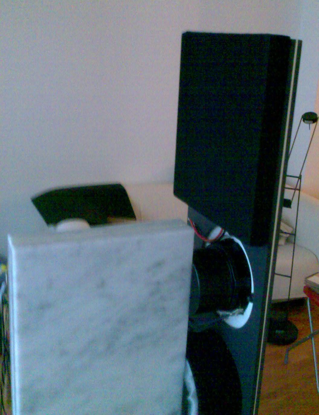

Hello Oliver,
Nice project!
Let me ask some questions to understand the design more:
1) How and where the tweeter panels are placed with the main panels? Got any picture with the tweeter panels installed?
2) How high the 6 fulrangers play with the cross over? I see a treble boost. Does it mean there play the top range as well?
3) Have any measured acoustical responses of the lower and upper triples separately with the cross over?
4) And the tweeter measured responses with the cross over?
The long list of questions indicates I may have missed the essentials of your design :D
- Elias
Hello Elias,
1) Maybe the attached picture helps ...
2) Yes ... the tweeter panel is only for correction
of the polar response to the rear.
Under free space conditions or in very absorbent
rooms the contribution of the tweeter panel is
less important. In usual living rooms it is
advantageous ...
The upper trio of fullrangers gets dominant above
4Khz, as you can see from the voltage transfer
curve of the filter i have posted.
3) I have no "isolated" responses - in fact there is
no such thing as the lower trio of fullrangers
is in connected in series with the upper trio
... maybe have a look at the wiring diagram
i posted in the beginning.
There is a simulation of upper 3 vs. all 6 drivers, at
http://www.dipol-audio.de/dipol08_simulationen.html
but with idealized drivers and without "treble boost".
4) Same as 3) but i may find a diagram of
the voltage transfer function for the tweeters ...
Kind Regards
