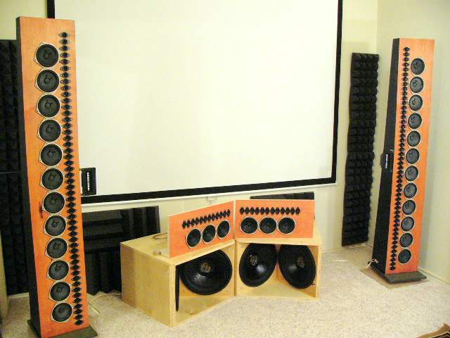

Here's 1 of my 2 pairs on a scrap MDF board .
I'll use this (admittedly not optimal) dipole setup as a basis to compare my ripoles. I should probably flip the mdf board so that the drivers are closer to the floor. Luckily, the drivers I got had the push/Clip type binding posts so re-configuring drivers should be easy.
Initial impressions, .. not as deep or efficient as the tuba horn in the background, ....though this setup is nowhere optimal. However, the bass is punchy and does extend down to the high 30s at least.
The bass is strong and even sounding, .. no major peaks to worry about, ... probably because it nukes the room modes that have been bothering me. Also, the bass is not floppy or woolly sounding. Running a frequency sweep at the listening position, I see that it's moderately even with a sharp null around 65 Hz, which is not an audible problem. I suspect this is placement related.
More to come

If that baffle was twice the size, you would get considerably better bass extension.
Mine were also very smooth throughout the entire range up to 125Hz where they were crossed over. The only thing I had to do was use a bit of EQ to lower the output around the xover freq just a little.
The 65Hz null you have is mostly due to your room more than just placement. If it's a sharp roll-off, that's what would be known as a "suck-out". I'm not sure if there's anything that can be done about that other than heavy room treatments. Trying to EQ it won't do anything but overdrive the signal and drivers, and very little if any to improve it.

I agree about the larger baffle = better bass. I just used that 2 x 4 board for evaluation because it was $0.50 scrap at home depot.
The null I talk about isn't bothersome, so I'm not going to dwell upon it any more for now. We'll see how things work out when I start building the ripoles.

just remember the "D" on that 50 cent baffle is not the same as the "D" you'd use for the ripole. they may not compare very well. The D on your flat baffle is the average radius of the baffle. On the ripole it's the depth from front to back.

Agreed, I knew that from the start. The dipole baffle is nowhere near optimal but it's purpose is more as a standard to compare the tonality and sound character of different alignments.

In OBs there is no "one size fits all".tomtom said:I have question about driver for OB sub /i mean from Thiele small POV/- i read too match different opinions about QTS /lets say 15''/ somebody say 1+ /martin king/ somebody the less the better
- totally different directions.
If you look closer you might find a system behind the different opinions: Real open (and small) baffles are a big shortcut for bass energy. To regain bass, you need a high Qts - or some heavy electronic equalisation which is expensive to achieve with passive components.
If you use some kind of frame (U, W, H) bass response is less attenuated. Especially in a ripole the combination of acoustic mass loading and passive filter will result in a bass response that doesn´t need help from the driver Qts.
"Especially in a ripole the combination of acoustic mass loading and passive filter will result in a bass response that doesn´t need help from the driver Qts."
That is simply not true. Even Ripoles can´t defy the laws of physics.
Higher Q always means more output at the Fs. In a ripole it means less, or even no lowbass-equing with a very high Qt-driver.
