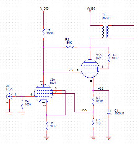

> I rearranged Bates' circuit
You lost the "Cathode Follower" aspect and its mythical virtues.
All my tinkerings agree with your thought. CF's advantages are not large in a Power Stage. OTOH a CF output means shunting some Heavy Lifting to the driver stage. A CF with 300V supply may need over 500V p-p to make good use of the costly(?) power bottle. That means we need a small supply of much greater voltage than the big tube's supply, an annoying design. (Or a high-impedance step-up driver transformer, no longer a common part and a very tricky design/wind.)
Here's a concept to think about and possibly try out on a breadboard. I rearranged Bates' circuit to place the OPT in the 6V6 anode circuit and use its voltage gain to achieve maximum output power, which should be near 4W. The OPT is uncritical in this arrangement, including its DC resistance.
I was checking your math on the 4W output and noticed that -12V of bias on a triode-connected 6V6 @ 335V B+ puts you way into red-plate territory. I don't think your idle conditions are going to work. Did you perhaps mean to run as pentode?

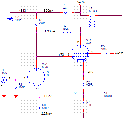

Since we're all here talking about direct coupling and pentodes, here's an ultralinear design I have been working on (tweak to the 6V6 one I posted earlier):
It uses an easy to find Hammond 156C choke (measured 3k25 DCR) and 5k output transformer. I am little skittish of the operating point for ultralinear though. I could find only one graph for the 6L6GC to work from:

It looks like about 5W to me.
Anyone have comments on this idea or bias experience for the 6L6GC in UL?
edit: slight tweaks and looks more like 5W output:
The 6V6 sees only 250V in this lashup, which puts anode dissipation around 12.5W -- well within the 14W design maximum. We would need class A2 operation to get full output in triode mode, so yes, I must have been thinking to connect as pentode instead. Thanks for a most diplomatic callout!

BinaryMike's has also been tweaked to allow for direct-coupling and a freebie screen supply in the big cathode resistor. Of course, BinaryMike's concept creates a bunch of heat in that cathode resistor but that makes the direct-coupling possible.
The cathode resistance dissipates 4.5W altogether. Taking 6SJ7 screen voltage at the tap has another advantage: It's a DC feedback path that acts to stabilize bias conditions.
