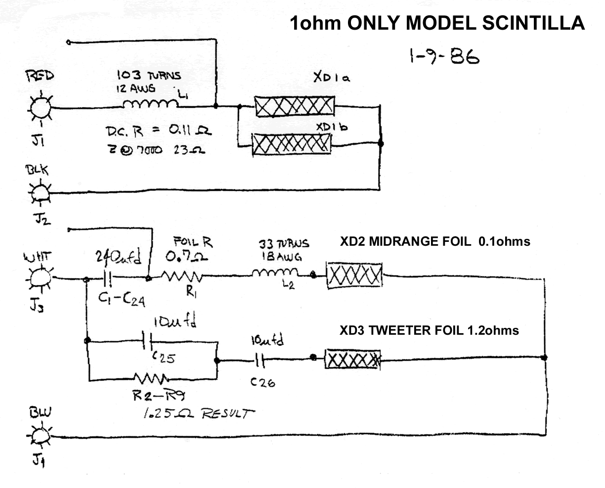

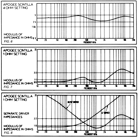

84 db@2.83V/m, Zmin-1.5ohm 200hz-10k , 1 ohm -20K
What is the source of these numbers?

I believe many may suggest pure foil superior to a foil/plastic composite.
If an accurate fatigue model is established, perhaps the membranes could be replaced at intervals over the transducers lifetime to sustain optimal operation. I believe this is commonly done in the Aerospace industry. Aluminum isn't too expensive and it wouldn't be too difficult to make the system modular.
If there are 8 ohms load impedance, that would mean 84db/1W/m But in your case that means 84 db/8W/m (resp. 5.3W/m by load of 1.5 ohms).
Normal speakers delivers between 90 db (medium efficiency) and 100 db (high efficiency) at 1W/m. You need therefore approx. 32W for 90 db, 128W for 96 db and 512W for 102 db. To avoid clipping effects during peak levels in dynamic aeras (drum solo e. g.) my rule is at least 10 times more power as avarage.
This means for your 84 db full range ribbon transducer arround 5000 watt undistorted peak output power.
My additional rule for ribbon transducers is pur class A, because cross over distortion must be avoid in all cases.

You need to also take into account the increased level over a standard speaker vs linesource at listening distances of 4 M the line source will be much better than the numbers suggest vs pointsource .
I have them now being driven by amplifiers rated to be (Adcom )850 @ 2 ohms and the sound will grow and maintain good volume . for safety I'm using 10 amp speaker out fuses , which do pop on peaks with say classical or live large scale recordings , never on regular compressed studio stuff like R&B , pop ,etc ..
currently being driven by a ( best this way so far ) Threshold S500 and Adcoms 565 on the bass , Would love to do a class a and my decision is to build one with 25 watts @ 8 for 200 watts/ch@1 ohm stable ..
don't think i need 5000 watts , i would try it if you have ...

The power required for this ribbon is calculated assuming an extremely low resistive element. Aluminum is very efficient as an electrical conductor and heat transfer medium, however, as the driven element in a ribbon design would not something more robust like titanium are even steel suffice as the sound transfer source. The benefits would be that these materials are not as efficient for electrical conductors and could raise the low ohm threshold to a more acceptable level. You could also use a much thinner material because of the added strength.
Let me know if I am wrong here but I do not know of many, or any, musical instruments, voice membranes that are made of aluminum. In contrast the vast majority are plain old high tensile steel. We should be able to at least double if not triple the ohm figure which would make this project more realistic.
