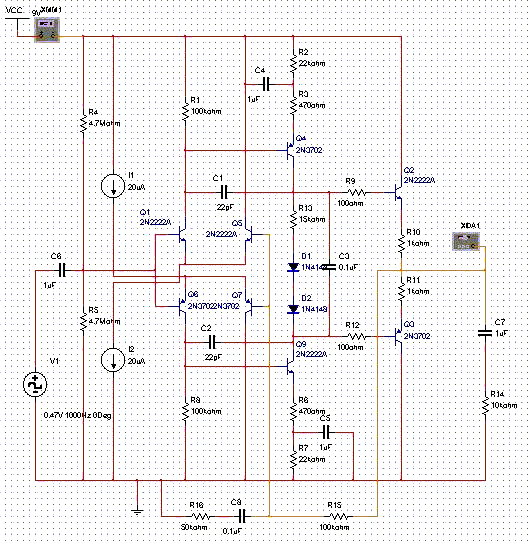

Elvee, you're a genius. I'll see your circuit and raise you two transistors:
0.11% THD (1KHz 6Vpp into 10K Ohms)
0.002% THD (1 KHz 100mVpp into 10K Ohms)
89uA Iq
9.5dB gain
10Hz to 100KHz bandwidth
2.3M Ohm Zin
Suzy
Suzy,suzyj said:Yes, it is. if I keep the quiescent current down to 200uA, that means I can get around 2500 hours (3 months) operation from a 9V PP3 alkaline battery (500mAh). I'll arrange it so that the battery is disconnected when I remove the lead from the guitar, so the battery lifetime should be quite long.
The idea of this circuit is to buffer the pickups. In this application, I don't think that adding distortion is helpful. Certainly, really low distortion isn't necessary, but it isn't that hard to get, either
Suzy
From experience (most of my basses are active) the reality is it's just best to change batteries every 6 months or so to avoid any difficult moments on stage. You could also use a 3 conductor cable and power it offboard which removes any issues with trying to fit a battery into your guitar and greatly expends the possibility for circuit design as you'll not need to worry about current draw / battery life at all. Add a pot with a DPDT switch to bypass to passive for emergencies if you so desire, but I've never run into any issues remotely powering in many years of doing it, eg with my Alembic Series 1 which is powered offboard (and has been since it was built in 1980).
I'd also go with a simpler circuit if you simply want to buffer the pups, something like a single J201. You should try it at least first.
Brett said:Suzy,
I agree with Brett.
Even if nice to see such fine and great low power amplifiers here,
I like the original idea by suzyj, the best.
With minor adjustments circuit posted in beginning of this topic
would be very good = good enough for the job.
Any circuit using more than 2T is in my opinion
an overkill for this job.

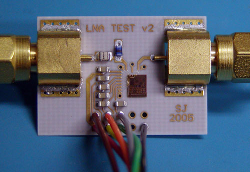

I do not know if image attached
is one chip actually designed by suzyj,
but
the topic starter here probably can do some tests like this, in some of her time
Regards

Daveis said:Which of these circuits has the lowest 3rd and higher order harmonic distortion?
RIght question!
G.Kleinschmidt said:Like Bart Simpson says - eat my shorts!
Hey, yer cheating! No fair using constant current source components - ya gotta build it out of discretes. I figure that'll add at least 20uA Iq
Seriously though, this is a neat exercise. It's been heaps of fun trying to squeeze as much performance as possible out of every microamp.
I note you're sticking with bipolars in the front end. Any reason for this? I've always just assumed that high input impedence dictates some sort of FET input.

suzyj said:
Hey, yer cheating! No fair using constant current source components - ya gotta build it out of discretes. I figure that'll add at least 20uA Iq![]()
Aww, C'mon. You could get away with 10uA easy
![cheeky :cheeky: :cheeky:](https://files.diyaudio.com/forums/images/smilies/cheeky.gif)
You don’t necessarily need FETs for high input impedance – it all depends on the circuit topology. For a start, we’re running at such low currents here, the base currents of the BJTs are low enough to still allow large value biasing resistors without introducing major voltage offsets. Also, in that last circuit of mine, the input bias current of the NPN differential pair transistors is mostly cancelled out by the input bias current of the PNP differential pair, which flows in the opposite direction. In reality though, there will always still be some input bias current, as the hfe of the PNP transistors will never perfectly match that of the NPN transistors.
Now as for the input impedance; the input resistance of a BJT with its emitter tied to ground is approximately equal to the emitter resistance (0.026/Ic) multiplied by the transistors beta. At 10uA Ic, this gives maybe a couple of hundred kilohms or so of input resistance for your average 20 cent small signal transistor – still a long way off several megohms though!
However as part of a differential pair, the emitter is not tied to ground - it is tied to the emitter of the other transistor forming the differential pair. We can ignore the contribution of the constant current tail, as its impedance is theoretically infinite. It isn’t infinite in reality, but it’s still so high that we can ignore it anyway.
If you were to analyse the operation of the basic non-inverting op-amp topology we’re using here, you’d find that by virtue of the negative feedback and high open loop gain, the actual differential AC voltage between the bases of the two transistors forming the input differential pair is very, very tiny, while the common mode voltage is quite large.
This means that the series connected internal emitter resistances of the transistors forming the differential input pair are effectively bootstrapped, sending the beta multiplied input impedance right through the roof.
The input impedance for that circuit of mine is therefore effectively governed by the two 4.7M input biasing resistors. Nifty huh?
Glen
