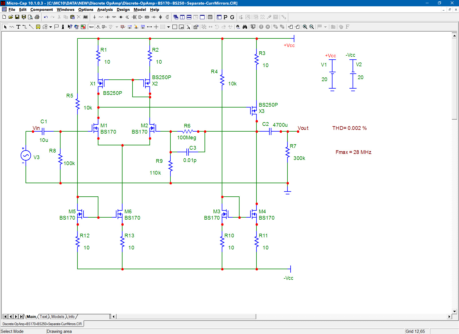

0.01pF ?? You are aware actual stray capacitances are orders of magnitude greater than that in the discrete world? femtofarads are strictly an on-chip phenomenon! The feedback network at that impedance is severely band limited.
60dB isn't worth having for an opamp alas, 100dB and up is needed to be realistic, and for low distortion think 120 to 140dB gain as great to have.
Swap those MOSFET current mirrors for BJT Wilson mirrors and you might get a load more open-loop gain? The source resistor values for the current mirrors look far too small to do anything too. A few mA across 10 ohms is a few 10's of mV, the FETs have a few volts of threshold voltage that's competing against, with large variability.
Probably a lot more than .01 pF. I'll try to measure it, I have a few 100 Meg resistors around here. The resistor values would set a noise floor that would really limit the utility of the circuit. Apparently its possible to make a good opamp using all MOS but probably not this simple. Input C and miller C would limit the bandwidth a lot.
Maybe a mix of FETs and bipolar could make the circuit much more useful. The output would be very high Z so loading will have a big impact on its performance. Needs followers to deal with that.

On chip capacitances are measured in femtofarads and even many kilohms of resistance will still look resistive at GHz frequencies in a VLSI chip. In the big world resistors of 1M might start to become non-resistive at 100's of kHz - 100M resistor? Well that's mainly capacitor or inductor at >10kHz....

That's because your bridge completely dominates for stray capacitance.
Basically I'm just saying a 100M resistor has no place in any audio circuit(*), let alone a low impedance solid state audio circuit, as its impedance isn't constant across the audio band.

100M resistors are usually not very stable in value or highly linear, as they cannot be made from metal film technology, though there may be some really good highly expensive specialized components out there.

Calm down, guys. I wrote the "SOFTWARE MODEL".
The capacitor of 0.01 pF and feedback resistors 100Meg - 110 kOhm - are just WORKAROUNDS to avoid the caveats of modelling software - MicroCap 9, 10. You should know this if you have ever model something in simulation software.
This software model is just a very close approximation of what should be in practice.

About 60 dB gain - I responend earlier.

Yes, it is a mistake in a software library of MicroCap 9, 10. Only one of charting of 3 models for BS250 is correct. I will try to fix it later.The P Channel Mosfets seem to have a wrong symbol, they look like N-Channels, just rotated to fit. Not that it matters for reading the schematic, but doesn't that upset the simulator?
Good advice.
Practically from my experience, the biggest problem will be DC drift.
So the circuitry has to take that into account.
