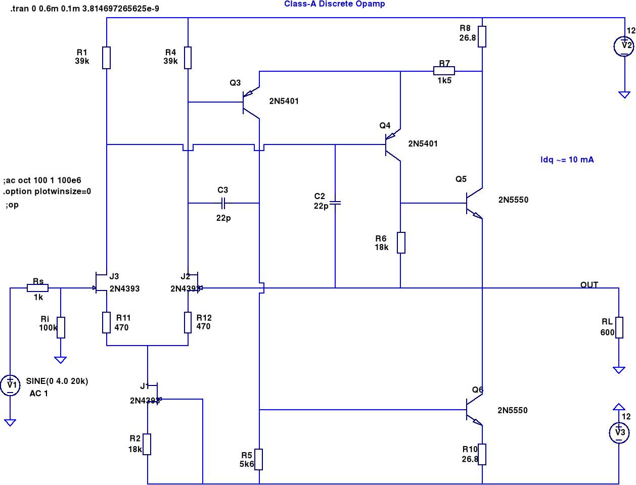

Discrete Opamp Open Design

Your amp actually have that High gnfb. But it is fine, since open loop bw is wide enough for high gnfb on 20 kHz; what is bad when it is low on 20 kHz, even if very high on 10-100 Hz..
Well it is relative to opamp open loop gain of 100+ db's at 10Hz.... makes my circuit look like mid-level amount. Not low nfb but not high either.
Note: It wasnt developed as an 'op-amp' competitor for this forum. It's a somewhat different animal. It was for a different project last year. I threw it up here... mostly to show the zero TC and 'audiophile' specs and features they like. Its actually over-kill for my appl but its hard to make a bad performing circuit from a good topology.

Many of the topologies developed over the years for oscilloscope vertical amplifiers have very low distortion without global feedback. Feedback would have limited the frequency response. For a good coverage of many see Doug Feucht's book Handbook of Analog Circuit Design. The material has appeared here and there, including John Addis' contribution to one of the Jim Williams compendia, but afaik not as extensively in book form as Feucht's.
Translinear circuits with bipolars, which rely upon their very predictable characteristics, are routinely capable of order -80dB performance over a useful range of currents, and without additional local feedback (which improves things but slows them down). Barrie Gilbert is the foremost authority on these techniques, exploited in his eponymous multiplier.
I presented a current mirror in another thread that shows how to use cascoded FETs and floating bias sources with local feedback to realize low noise and distortion. It costs volts and power dissipation, but works well. It was to some extent offered for those who spurn bipolars, believing that there is some intrinsic inescapable "sound" there that they don't like.

My original thought was along different lines like something that could be droped into a standard op-amp I/V or the Pacic-Pre phono. Keep it simple enough anyone can try it, nothing ventured nothing gained.
I also thought that was the point of coming to this forum as it was your input to do a new design (other than JC's) we (I) waited for and you delivered a very good one.
Has it now morphed into something else? Or, is it when a forum is done, it doesnt know how to end so it rambles on?
There are now plenty of Current-mode feedback designs being made on this DIYAUDIO and other sites. So there needs to be a goal for us to shoot for and not just ramble on about this or that circuit.
What are the goals for a new design?
Personally, I would now like us to try matching the performance of an opamp's high feedback with one with no gnfb. There are not many out there. Make it popular and easy as possible to make as the new goal.
