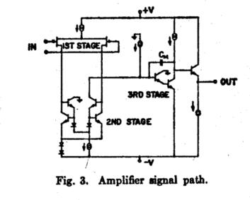

linuxguru
I think there's something wrong with your sim. The descending slope on the right might be caused by a LF drift in the caps, it's not always there anyway... The skirts round the fundamental don't look right either.
Spice directives for simulation courtesy of keantoken.
2V in, 6.4V out (peak) into 16 ohms, as shown. < 2 PPM THD. It's not the least number of components, but you can get these transistors for $0.03 ea. Surely that's got to count for something. :)

linuxguru
Yup, known LTSpice artefacts from a quick-and-dirty 5-cycle transient simulation and Hann window. Not really a problem for getting a rough idea of the relative harmonics.
BTW, I changed the upper cascodes to BF822/823, Miller caps to 10 pF and output NPN to 2sc945. Added 22k to ground at high-Z gain node, as suggested by Scott. GBW is up to 48 MHz, so all is well.

The 22K to ground was a nod to those that think 20KHz open-loop BW improves things, what I'm not sure. This should probably be left for listening experiments.
If I build a PCB, I'll bring the gain-node out to pin 8 as external compensation, assuming it's a single DIP8 implementation. Added bonus: people can use their favourite buffer and bypass the default internal buffer if they wish. The only hitch is additional track parasitics at what looks to be a critical high-Z node.
