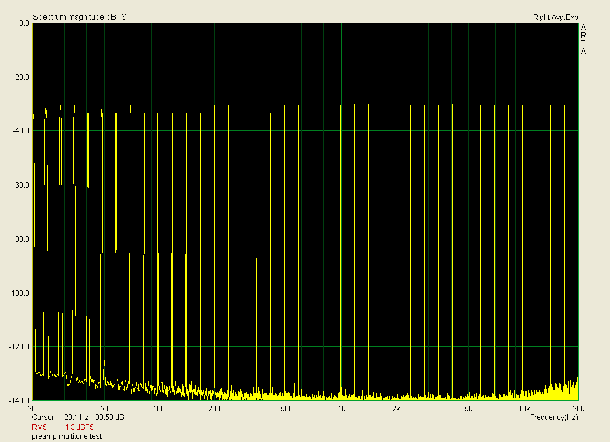

EDIT Sorry PMA already said that but let me add that in doing these multitone tests for years the results were always well behaved and for the most part could be predicted by simple IMD testing at an appropriate level.
I agree that multitone tests usually do not reveal much, in case that the object under test is not poorly designed. I assume we really do not need to speak about uA741, all of us knew how poor it was even 35 years ago. The multitone test on a contemporary design just copies abilities of the measuring device. I agree that CCIF IM 2-tone test may reveal more. Again, it is not difficult today to design an audio component that is very difficult to measure regarding non-linear distortions. So probably we might like to spend our efforts to parameters like high frequency PSRR, RFI immunity, immunity to HF demodulation and detection. This needs high speed design and fulfillment of HF circuits design rules. Together with suppression of LF noises by proper wiring and PCB design inside the housing. Not so easy to get and impossible to get by web discussions.

George, the measurements are explained in post 1099

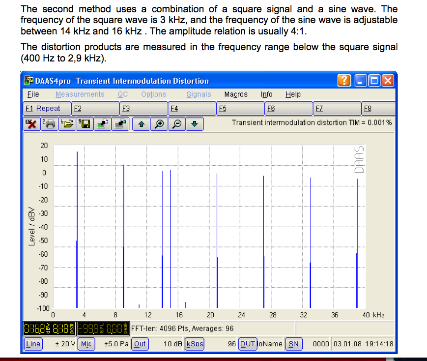

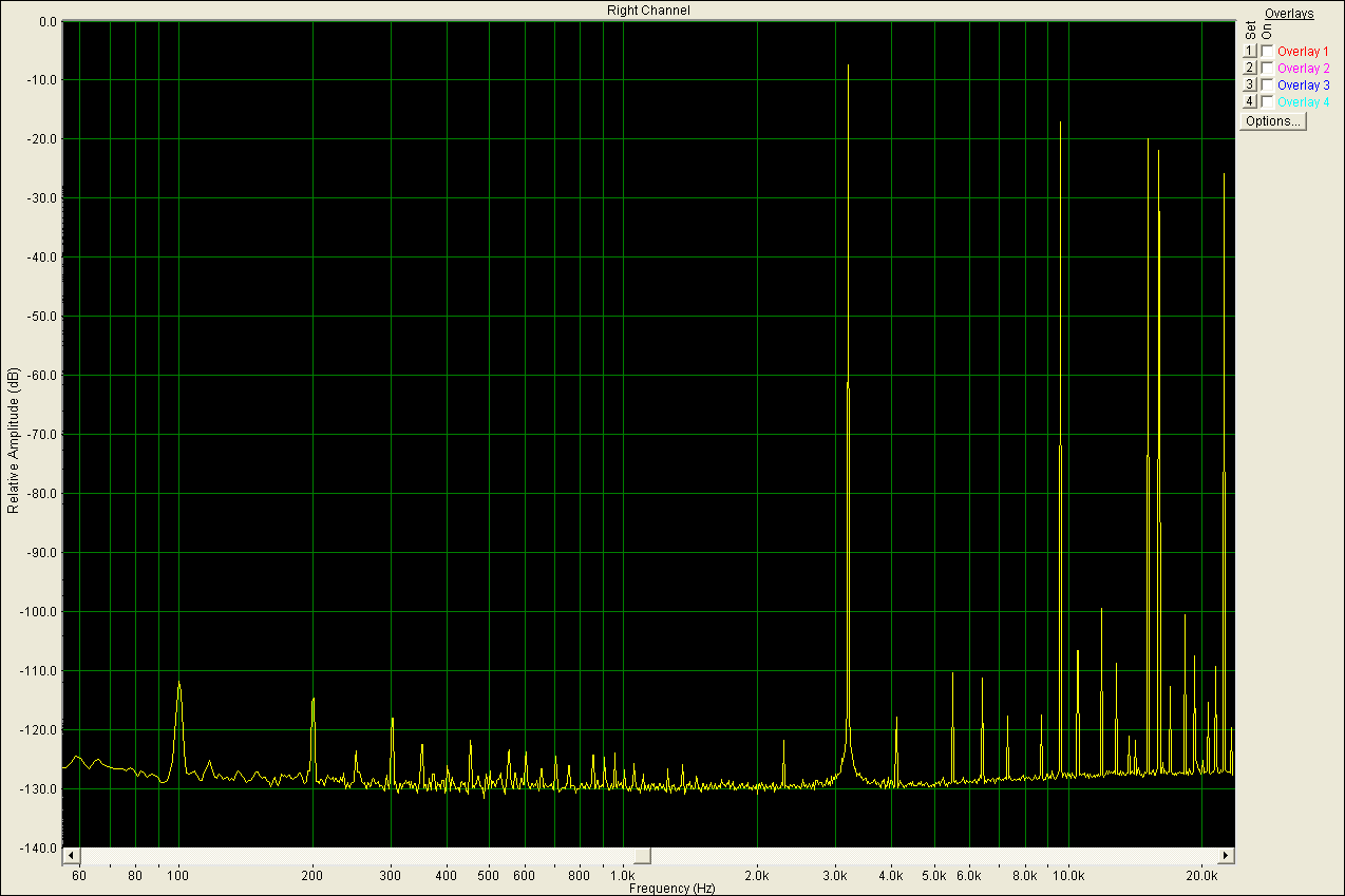

I meant the FFT at post #1107. Is it sine-square superposition? If so, what is the freq of square and sinus input and amplitude ratios?

Ref. Attached screenshot
I see the noise floor becoming thicker with freq. increasing. Is it due to the accumulation of intermod products of the multitone test?

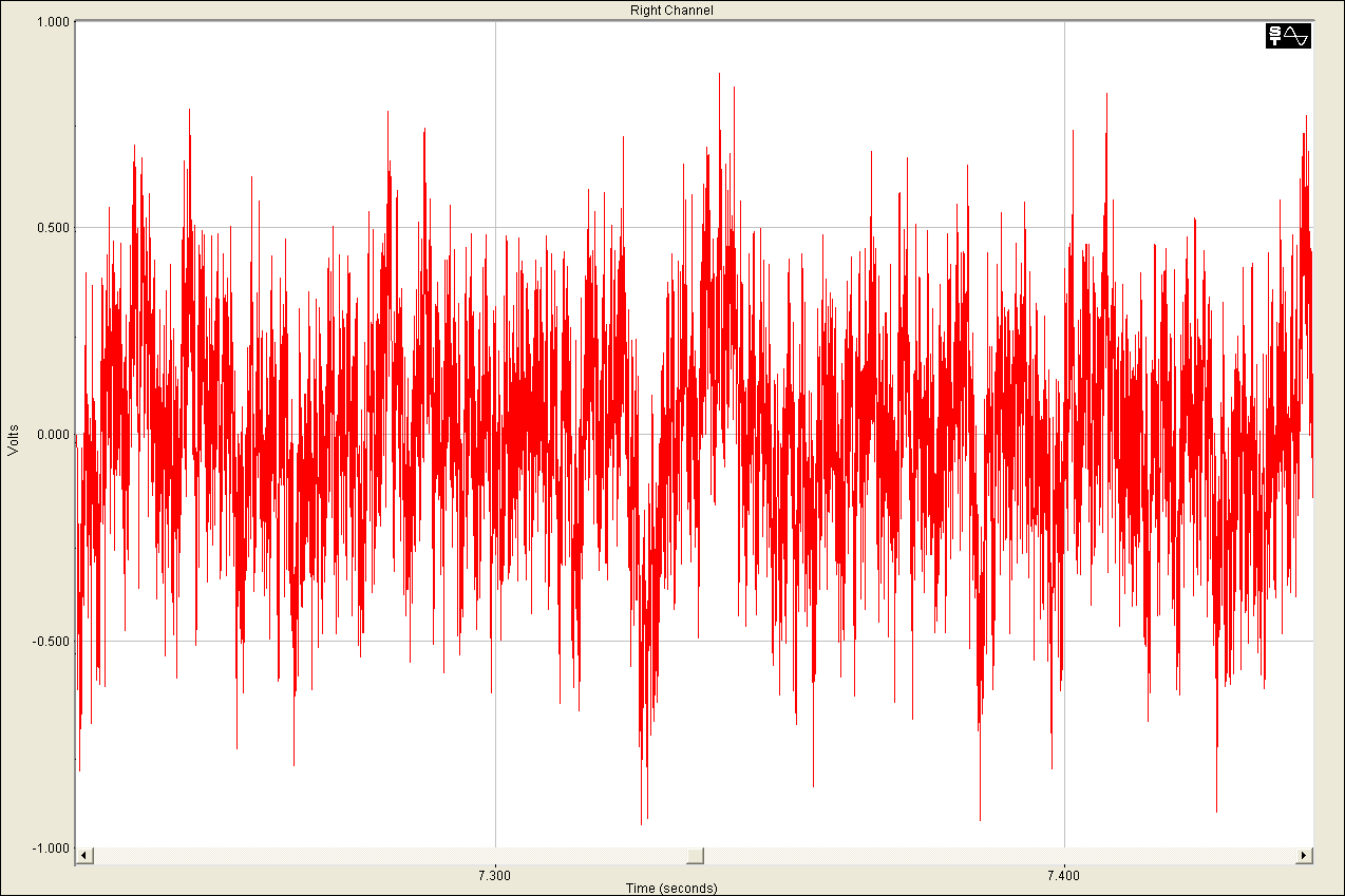

No. Try it yourself and you will see. You have to reduce amplitude of individual harmonics to get within Vpp limits and you will approach to noise-like signal. Not enough dynamic measurement range to evaluate the result, it would be hidden in noise.

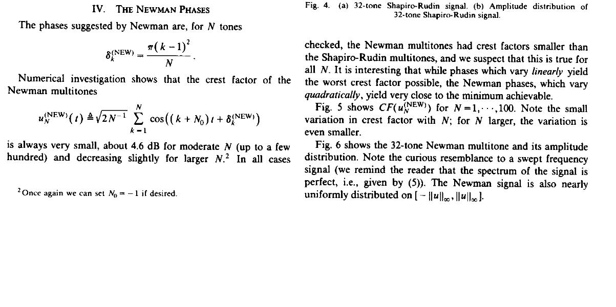

You don't get around these issues. There is a minimum crest factor that is possible as you add tones, with lots of tones the signal is noiselike and the expected crest factor approaches 3.1 but you can not make it 1 so the result is to operate almost all the time at -10dB from full scale. Clipping just a single peak crest contaminates the noise floor dramatically.
I wrote a C program to adjust crest factor to a specified peak but usually we wanted high crest factors like 5.3 or 6.1. I never set it up to lower the crest factor to the minimum possible but with lots of tones this is intractable and I would do it iteratively.
