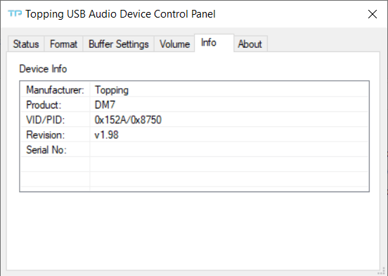

@Dave Bullet : Thanks, that's interesting. Please also post complete usb configuration of the DAC
where the ids are listed in lsusb for the device
Code:
lsusb -v -d VID:PID
Thanks - As attached (forum message limit 2000 chars)

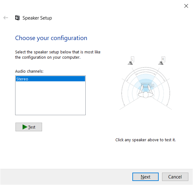

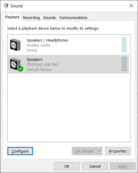

Your lsusb -v device config lists only "bNrChannels 2" alternate settings, just what the stream0 file shows.
Can you check with some older ubuntu running from a live-usb flashdrive? But IIUC the USB config the device reports upon the initial request whould be the same on any OS/kernel version, unless a driver switches it to some different mode.
Maybe your DAC needs some way to switch to the multichannel version? Maybe some windows driver to do so?
Thanks. Windows only shows 2 channels to, but I don't trust windows. I can't see any 2/8 channel switch / mode in the user manual or menus (as I thought the DM7 was permanent 8 channels on?)
I will try a Ubuntu dual boot / boot from USB and see how I go. I could try an older kernel incase something is broken. I'll also try windows / foobar2000 and see if I can generate 8 channels of output to test the DAC.

I wonder if they flashed the wrong firmware to the XMOS usb chip. They probably make stereo dacs with the same xmos chip, so maybe someone made a mistake and when flashing yours (and likely a whole bunch more). Does it work at all if you try to use 2 channels?Is my DM7 faulty?
Thanks @HenrikEnquist you might be right. Windows only shows 2 channels to and only 2 channels works.
I will reach out to topping /shenzhen audio to see if there is a way I can check.
I don't know if this is the firmware version (v1.98) but I believe V1.18 is the latest for the DM7:
So maybe the wrong firmware flashed at the factory. I will email them
I'm thinking its firmware. Even windows with latest v5.57 drivers from topping fails to see more than 2 (stereo) channels in the device configuration page.
Note: windows is running from another PC to the 2 linux distros... so that should rule out some USB root/hub issue/protocol. I doubt I have a cabling problem
Problem solved. Bad firmware flashed at factory (v1.98 of god knows what). With v1.18 applied, Archlinux and windows now report 8 channels. I did a quick test on channel 6 and sound only on that channel came out.
It would seem as if they flashed a firmware for a different DAC. But the firmware did report the iProduct string "DM7". It looks like some testing firmware in the Topping fab for DM7.
