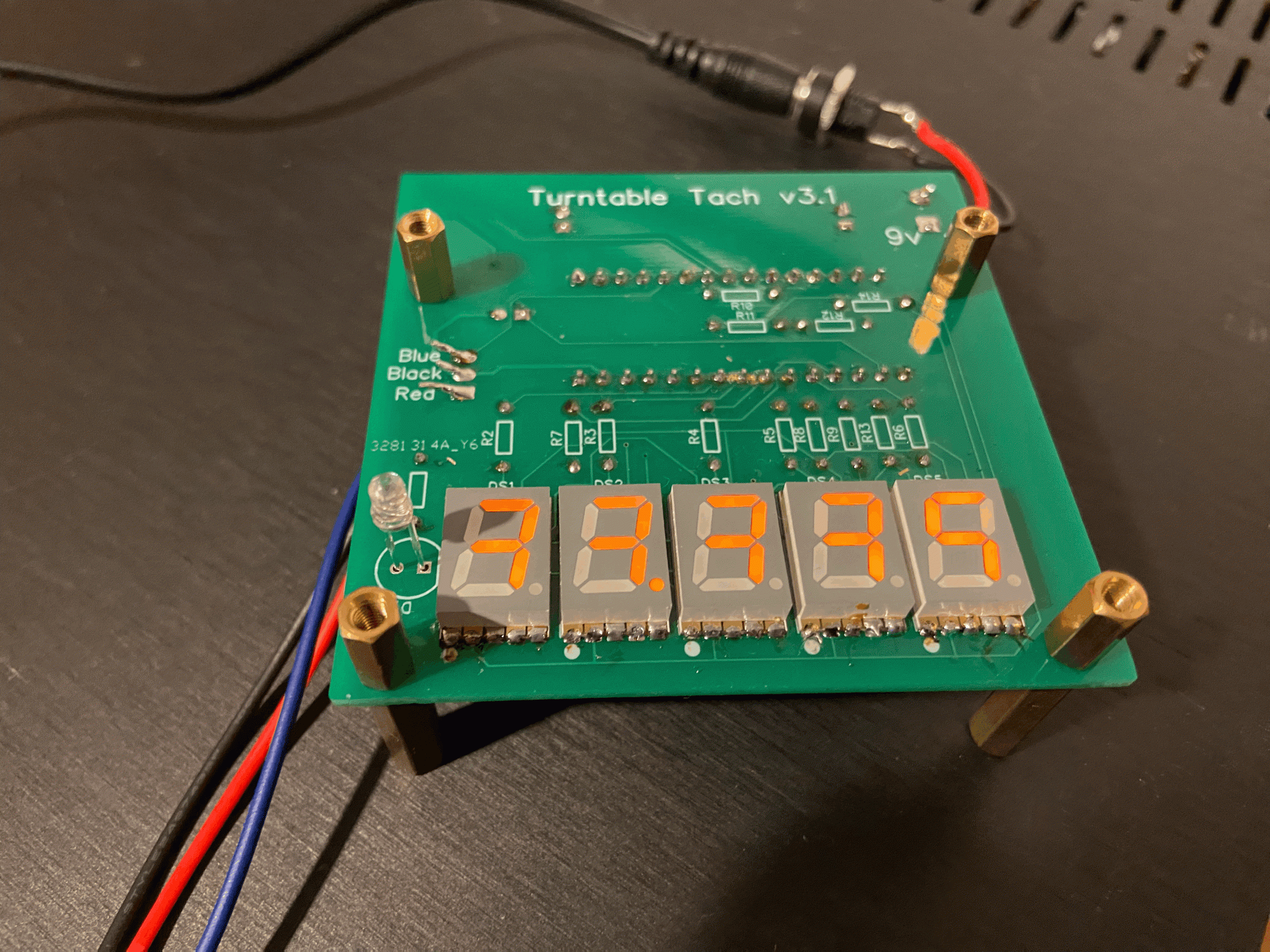

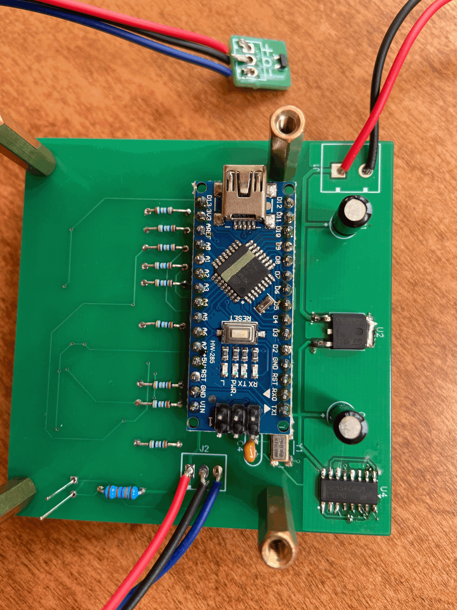

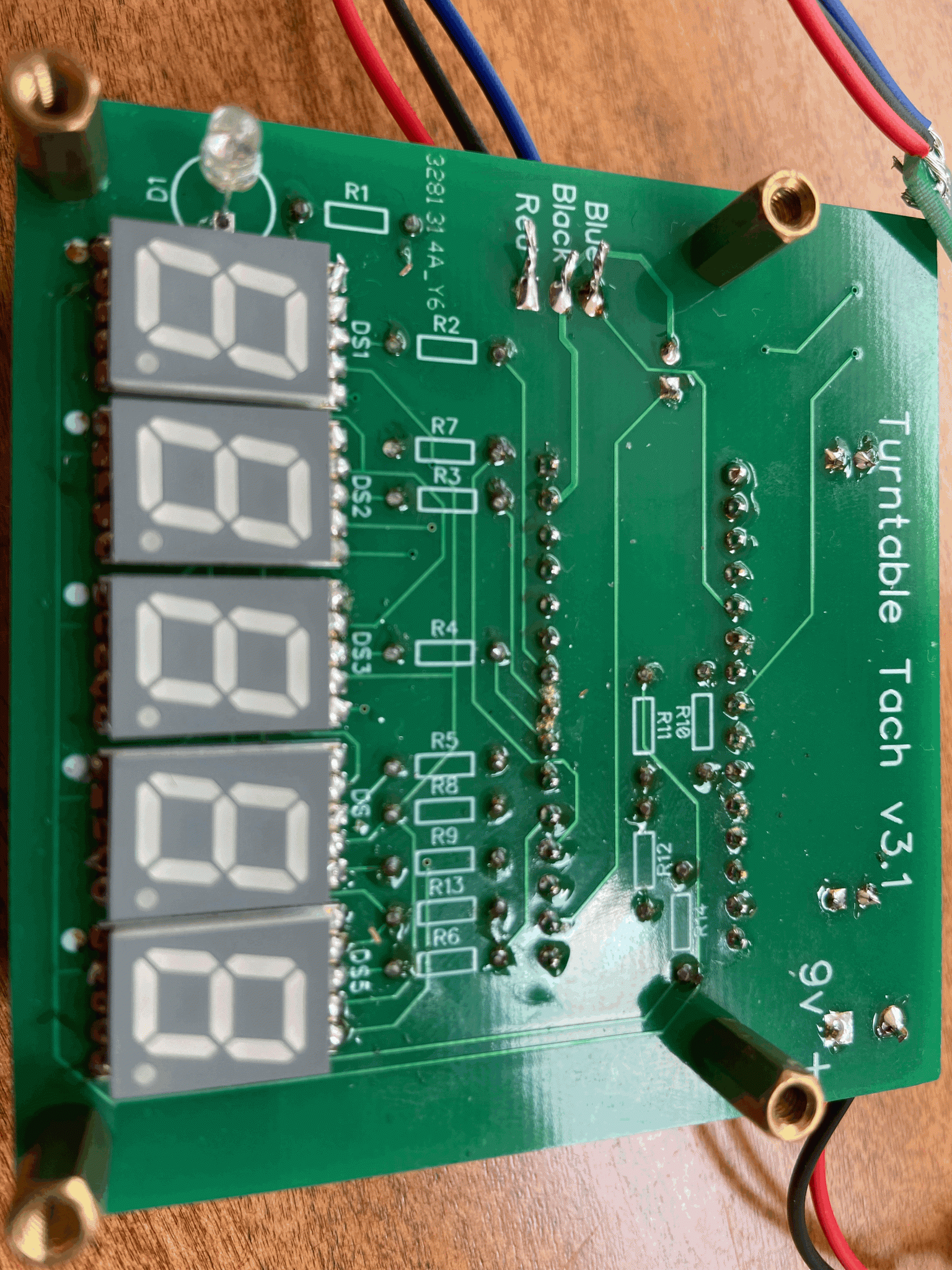

Folks:
I am new to the Arduino world and my efforts to compile and upload the .ino file to the Nano 340G have been unsuccessful. Arduino IDE identified three port options:
Unknown
/dev/cu.BLTH
Unknown
/dev/cu.Bluetooth-Incoming-Port
Arduino Nano
/dev/cu.usbserial-1430
I've tried all three and for each selected "Arduino Nano" as the board type. As long as the Nano is connected to my MacBook Pro, the Nano's green LED stays lit, the red LED flashes and the yellow LED very briefly lights when the red LED's state changes. The reset button on the Nano has been pressed just before each attempt at compiling and uploading the .ino file.
When the first port option above is selected, the following error message results:
Sketch uses 3340 bytes (10%) of program storage space. Maximum is 30720 bytes.
Global variables use 79 bytes (3%) of dynamic memory, leaving 1969 bytes for local variables. Maximum is 2048 bytes.
avrdude: ser_open(): can't open device "/dev/cu.BLTH": Resource busy
Failed uploading: uploading error: exit status 1
When the second port option above is selected, the following error message results:
avrdude: stk500_recv(): programmer is not responding
avrdude: stk500_getsync() attempt 1 of 10: not in sync: resp=0x00
avrdude: stk500_getsync() attempt 2 of 10: not in sync: resp=0x00
avrdude: stk500_getsync() attempt 3 of 10: not in sync: resp=0x00
avrdude: stk500_getsync() attempt 4 of 10: not in sync: resp=0x00
avrdude: stk500_getsync() attempt 5 of 10: not in sync: resp=0x00
avrdude: stk500_getsync() attempt 6 of 10: not in sync: resp=0x00
avrdude: stk500_getsync() attempt 7 of 10: not in sync: resp=0x00
avrdude: stk500_getsync() attempt 8 of 10: not in sync: resp=0x00
avrdude: stk500_getsync() attempt 9 of 10: not in sync: resp=0x00
avrdude: stk500_getsync() attempt 10 of 10: not in sync: resp=0x00
Here is the error message I receive when the third port option is selected:
Can anyone offer sage advice to this Arduino dope?

I've made progress! It turns out the Nano I purchased (https://www.ebay.com/itm/225412969248) requires an ancient driver, which I located, and has now been programmed. The next step is to solder those pesky, small SMD components.
Thanks for the support!

The Nano has been programmed. When initialized, the 7-segment LEDs display "88.888" before shutting off and the last display briefly lights up as "0". The single LED stays lit at all times. I temporarily attached a 5mm dia x 2mm tall Neodymium magnet to my platter and the Hall effect sensor is positioned within 2-3mm from the magnet, but the tachometer isn't reporting the speed.
A few questions:
Sorry for being a burden, and I appreciate any/all help anyone can offer. If you can think of another possible cause, please speak up.
Scott
A few questions:
The leads from the tachometer to the sensor are 29" long, and I'm measuring about 0.2R across each of the three 22 gauge wires. Could the length of the leads pose a problem?
I'm no engineer, but it seems the Hall effect sensor (https://www.mouser.com/ProductDetail/Diodes-Incorporated/AH3372-SA-7?qs=b%2B2mHxW/y4WmQnfkeqNEXA==) only senses the S end of the magnet. When the first magnet didn't seem to work, figuring the first magnet was improperly oriented I attached a second magnet, oriented oppositely, a few inches away on the platter. Still no luck.
It's possible my SMD soldering is an issue, but the pads look clean to me. If there's a soldering issue, I can't see it. Do you see anything obviously amiss?
Scott
Oops! I neglected to mention that the resistors on my board differ from the BOM. R1 is 13k7 and R2-R14 are 300R.
You have the blue and black wires switched at the hall sensor. Blue is your signal and red/black are simply power. The LED should only come on with a trigger/signal so that seems to back up the switched wiring.

Glad you got it working. I had one of mine not work and I tracked it to a leg on the divider chip not soldered. Found it by walking the oscillator path with an oscilloscope. Your trigger LED on continuously was a good clue to crossed wiring on the sensor. 🙂
I just ordered a lighted magnifying glass on a crane neck. My eyes are not what they used to be. 🙂JHH:

So, Scott sent me 2 complete boards, one hand soldered with an iron and one soldered with hot air and solder paste. They were having problems with the display.
I examined both boards, the hot air version had the first and last LEDs slightly twisted and I was measuring all pins shorted together so figuring I would have to pull the SMD display chips I put it aside and played with the other one. The hand soldered one showed a short between pins 1 and 2 of the display chips. Couldn't tell which Chip since they are all in parallel. So I reflowed each display chips pins/pads and it still was shorting so I used some solder wick across all the pins 1-5 on each chip pulling out the excess solder. Retesting and it was good, one board down, on to the next.
I started with removing the two LED displays chips from the ends, re-measuring did not remove the shorts. I did notice a lot of solder and solder paste still under the display chip. So I removed the other three display chips, cleaned all the excess solder off the board and the displays and soldered them back on, checking after each one for any shorts. All good, testing, great, problems solved.
Each case was too much solder. You really don't need much on SMD chips pin/pads. I haven't used solder paste myself but I worked in the electronic industry and taught the techs troubleshooting at the assembly houses and watched the solder paste applied and the pick-n-place machine work, always mesmerizing. Anyways the solder paste was squeeged onto the board through a solder mask, a lot like silkscreening, so the paste was only a couple thousands thick on the pads, so not much.
Note for troubleshooting LED display chips: If Common Cathode use a ohmeter with a beep funtion, put the negative probe on the CC pin and with the postive probe touch the other pins one at a time and you will see a LED segment light up and a beep at the other CC pin. For Common Anode reverse your leads.
Scott, Your boards go in the mail tomorrow morning Priority One. Since Monday is Memorial Day they will probably be delivered around Tuesday. I will PM the tracking number when I have it.
