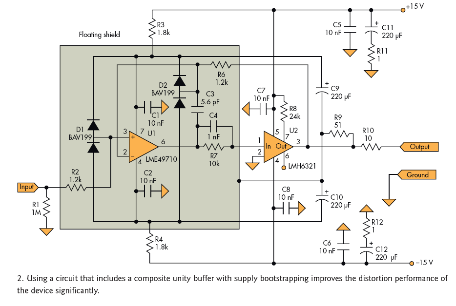

the older junction isolated process op amps can be improved with composite amplifier techniques
http://www.analog.com/static/imported-files/application_notes/742022599AN232.pdf
Supply Bootstrapping Reduces Distortion In Op-Amp Circuits | New operational amplifiers optimized for high-performance audio and ultrasound applications combine extremely low total harmonic distortion plus noise (THD+N), -130 dB, with large output vo

The substrate bootstrapping technique is another possible solution, I believe this is also the approach Douglas Self took in his Small Signal Audio Design book for dealing with this distortion on the TL072. My one caution to circuit designers evaluating that approach is that in some circuits, bootstrapped supplies can be a recipe for latch-up during start-up and shutdown. I haven't used it for distortion reduction, but I did use it once to build a high compliance voltage Howland Current Pump (http://www.ti.com/lit/ml/slyy054/slyy054.pdf)

Not to belabor the point the AD743 data sheet has info on input balancing for Sallen-Key filters and for minimizing induced gate current noise.
John, could you comment on the first section of pg 13 of the OPA1642 datasheet? It would seem that matching of the impedances seen by the two inputs is still desirable.
I was hoping someone would catch this! A process improvement was made after the original characterization of the OPA164x family of parts. And although other parameters were measured to confirm the effect of the process improvement, THD+N was not re-characterized. So basically, the OPA164x op amps are better than their datasheet would suggest.
