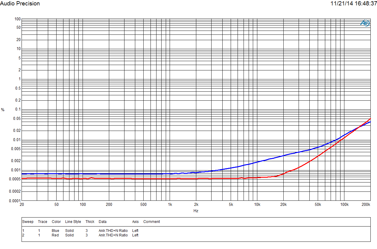

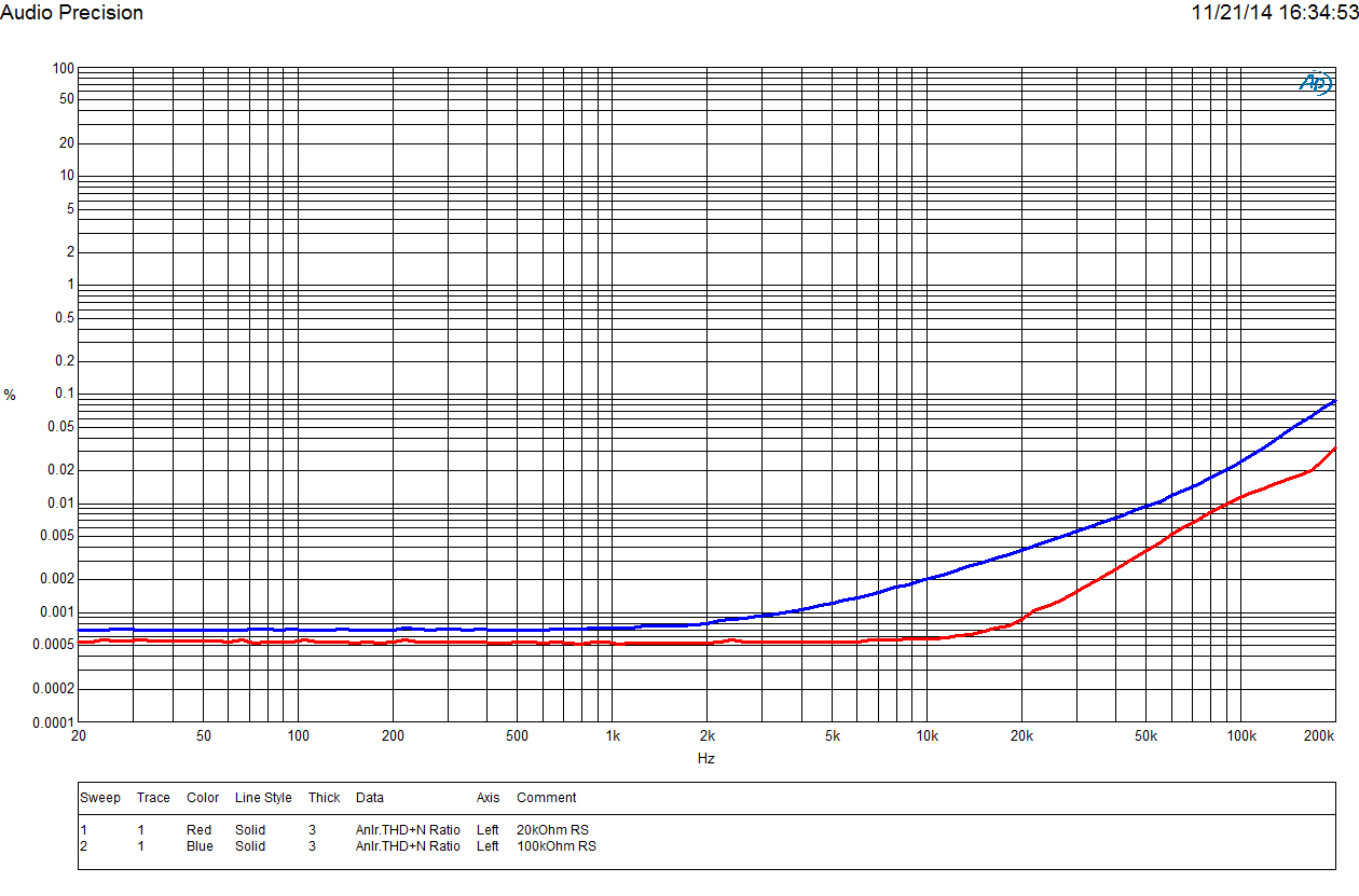

As Mr. Groner requested, I tested the OPA1641 with a source impedance of 100kOhm up to 200kHz. Unfortunately, my Audio Precision would only let me do a signal amplitude of +18dBu (6.153Vrms) to 200kHz as opposed to the +20dBu he used in his testing. As a bonus, I also measured the OPA827 under the same conditions. The two plots are attached, in both graphs the blue curve is for a source impedance of 100kOhms, the red curve is for a source impedance of 20 ohms.

So, what exactly does this show Mr. Caldwell...that distortion rises as the source impedance goes down?

The graphs show that distortion increases for higher source impedances (100k ohm source impedance has higher THD+N than the 20 ohm curve). This is not unexpected, as others pointed out in the thread, the gate-to-substrate capacitance is not the only non-linear capacitance in the op amp input, just the largest. However, the input stage may be designed to maintain a constant VDS across the input JFETs (cascoding), bootstrapping the gate-to-source and gate-to-drain capacitances and eliminating their effects on the input capacitance of the op amp. At higher frequencies, the cascode circuitry may not have sufficient bandwidth to keep up with the input signal, and the additional non-linear capacitances of the input JFETs begin to affect the distortion performance of the circuit.
Within the audio bandwidth I would say that the OPA1641 and OPA827 performance is comparable. I included the OPA827 results because Samuel Groner's testing of the OPA827 showed much higher distortion at high source impedance and I was curious if a process change had improved the performance.
Finally, why care about the performance above 20kHz? Non-linearity outside of the audio bandwidth can translate into weird behavior inside the audio bandwidth due to intermodulation effects.
