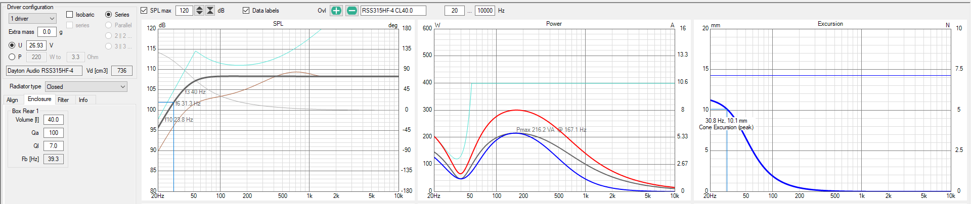

If I understand this correctly, the conclusion is that 1.75% H2 is contributed by the air alone, for a 12" driver in a 40L box at 10mm excursion?
Is this why he puts a small pin hole in his sealed woofer boxes?
No this not why there is a tiny hole in a "sealed" woofer enclosure. The tiny hole is there to equalize pressures that happen much more slowly and less vigorously than a 20Vrms signal applier to the driver voice coil. Even a 4 inch Bass reflex port is not large enough to do that.
Just for grins look at the data sheet for a GRAS microphone, microphones are rated in Pascals per mV output. Microphones are pressure sensors. Pascals are units of pressure, like Pounds per Square Inch.
The same way a 12 inch woofer with 100 Watts input (Watts := Volts times Amps) generates pressure in a sealed woofer enclosure that same pressure change will generate Voltage output from a microphone in the same enclosure. At that instant in time the microphone voltage output represents the pressure in the speaker enclosure.
Thank you @DualTriode and @IamJF
But to be clear, a 12" woofer in a 40L box at 10mm cone excursion out (or in) has 1.75% H2?
eg. RSS315HF-4, driven with 27V in 40L box hits 10mm at 30Hz (102dB 2pi)
In what kind of extreme conditions is someone living to have such extreme pressure fluctuations?No this not why there is a tiny hole in a "sealed" woofer enclosure. The tiny hole is there to equalize pressures that happen much more slowly and less vigorously than a 20Vrms signal applier to the driver voice coil.
Yes. Well, actually, no, not the woofer. The air distorts with H2 = 1.75%. Any distortion by the woofer itself is on top of that.But to be clear, a 12" woofer in a 40L box at 10mm cone excursion out (or in) has 1.75% H2?
Agreed with @markbakk. A good 12" woofer in a 40-50L sealed box will have about 12-13% H2 around 30Hz, when excursion is +/- 10mm. So I didn't think 1.75% significant. Perhaps I took it out of context. Why did SL do that calculation? I don't think it would be a case for going for dipole bass. You need even MORE excursion (and thus distortion) to reach the same SPL...

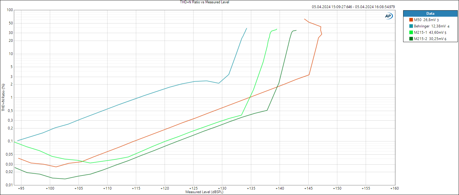

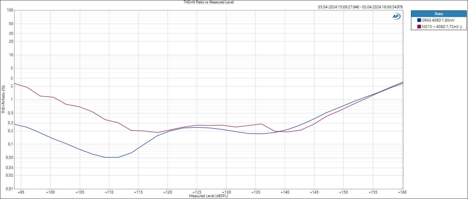

Setup
A pressure chamber is a device with a speaker membrane with a very small and 100% sealed front chamber. This pushes the resonance frequency of the 8" speaker to about 350Hz in my case - the volume is that small. But you can produce huge pressure changes now!
Measurements as always done with proper gear (APx515, Class1 Calibrator, Benchmark AHB2 Amp etc).
Measurement frequency is 250Hz (to be sure we are in 100% pressure chamber behaviour and it's the recommended calibration frequency by B&K and GRAS), stepped level sweep, 31 steps.
Check of the chamber - how much THD produces the speaker.
Such a pressure chamber produces stupendous SPL at very little membrane movement - so there is very little THD from the speaker. To check my limits I did the first 2 measurements with a GRAS 1/4" 40BD capsule with 2 different "preamps" (actually just impedance converters, they are just called preamps but there is no amplification).
That's the result.
There is a LOT of noise and some strange stuff between 115 and 135dBSpl going on with these 1/4" capsules - legit THD measurements are only starting from 140dBSpl and up. So we produce 150dBSpl with <1%THD and 160dBSpl <3%THD. We don't know if that's the speaker or the refmic! (I have an idea ...)
But we are sure about staying under 1% <150dBSpl and 3% <160dBSpl

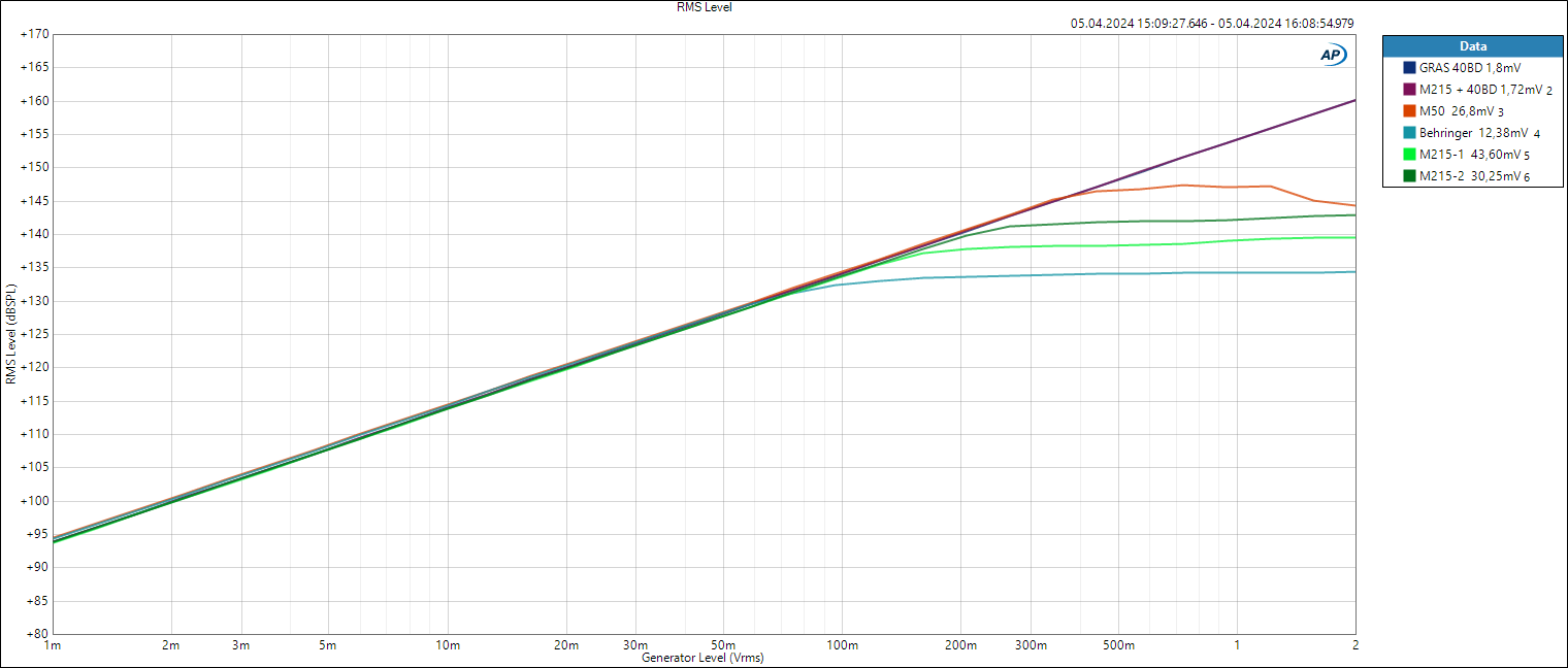

So how are our microphones performing.
Here you see the linearity graph. 160dBSpl is easy for our 1/4" capsule. Not so for the other microphones ...
M50 gets to 145dBSpl - spec is 140dBSpl
M215 around 140dBSpl depending on capsule sensitivity -> preamp distortion. Spec is 135dBSpl.
I didn't bother to look after the Behringer Mic spec as it's just here as deterrent example - but >130dBSpl is actually not bad!
But what about THD?!
Here it is - the truth about reference microphone THD:
As expected ... don't use cheap measurement microphones for delicate measurements. They can't do them. The Behringer is out.
Interesting is that the Earthworks has higher THD as the M215! Noise area is up to about 105dBSpl (there is a lot of noise in the pressure chamber cause of it's sensitivity!!!) but then we get valid measurements. At the specified 140dBSpl max it has already 2% THD - that's A LOT! Studio microphones are normally specified with 0,5% THD, somtimes with 1% when the manufacturer wants to push it a little.
M215 - 135dBSpl is where the preamp starts distorting - that's not a limit of the capsule! Actually - it is when you take the 0,5% THD rule ...
BUT - one of the M215 amplifiers produces more noise as it should. Noise should be less as the M50 (dark green) but number 1 has more noise (light green). Will have to investigate, maybe just dirt in the high impedance area (these mics don't get pampered).
You can calculate your THD from this graph for lower SPL. -20dB -> 1/10th of THD. Even the Behringer follows that rule, it's how a condenser capsule SHOULD behave in theory. And they do!

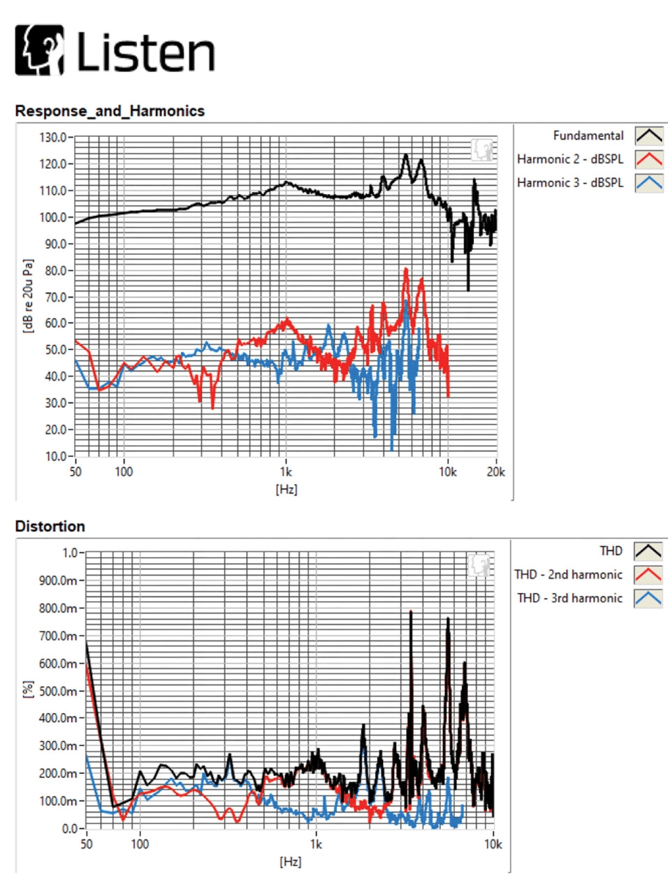

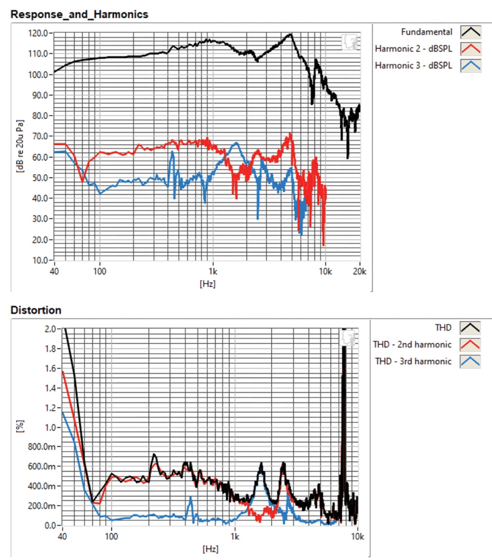

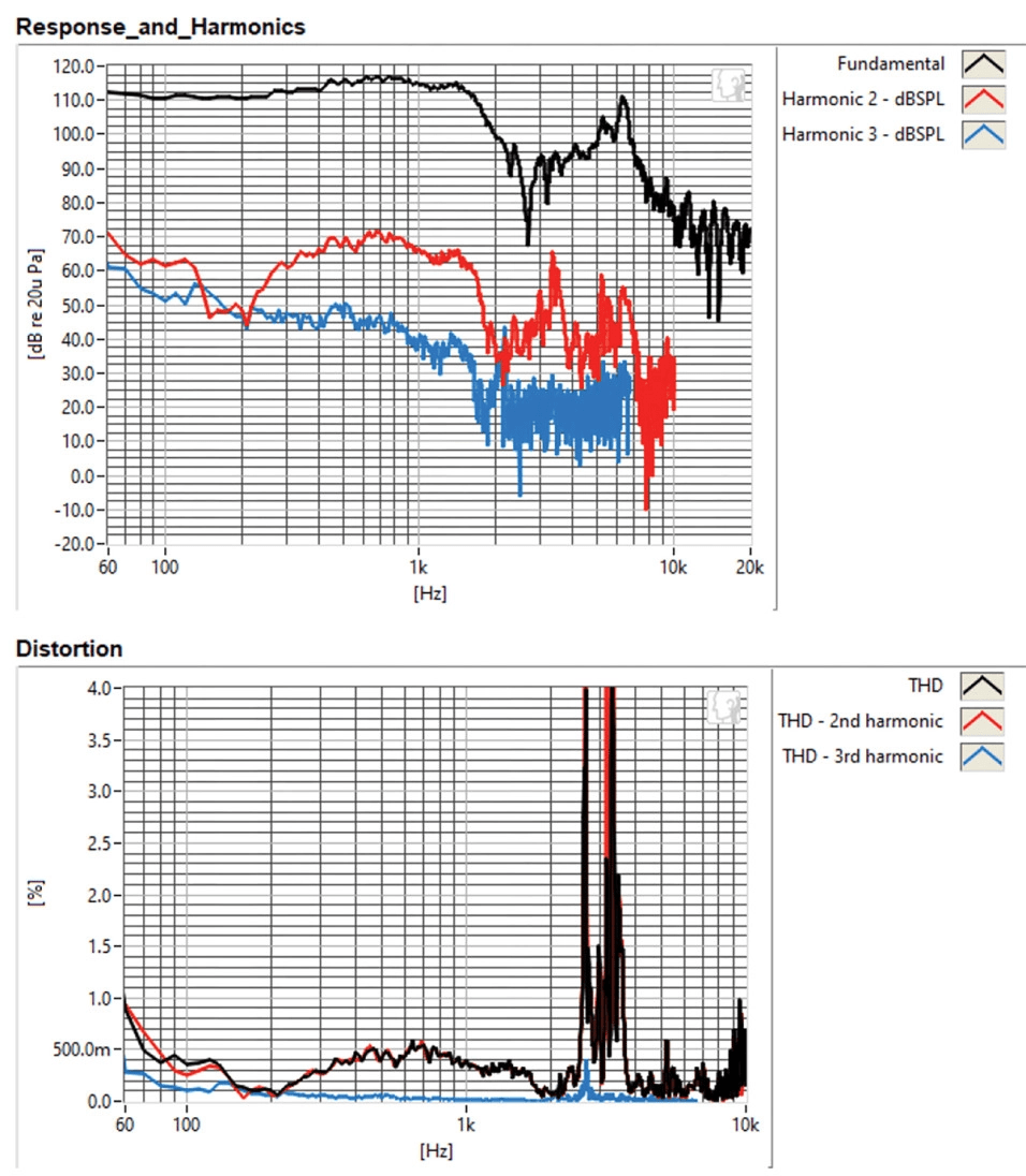

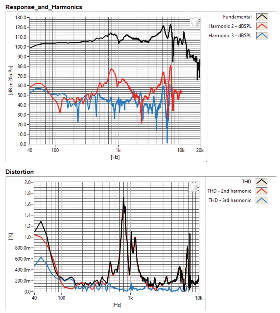

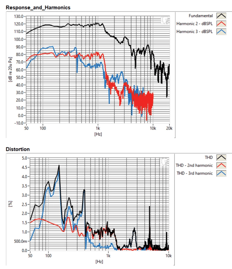

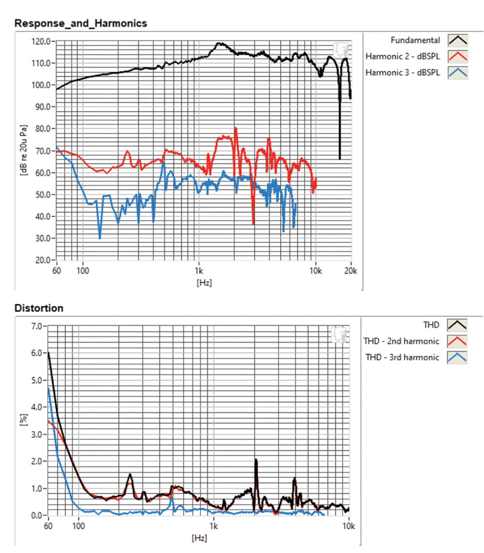

Which brings me to comment, I'm a bit disappointed by Voice Coil's continued use of a microphone that get dangerously close to distorting itself.
There are many measurements where the microphone is observes levels approaching 120dB:
Reference:
https://audioxpress.com/tags/Test-Bench
As @IamJF has shown, the difference between a microphone's own THD of 0.5% and 1% is just 6dB.
But the microphone regularly used in Test Bench is Listen Inc's SCM3, a nice mic but whose specifications show a maximum of 123dB for 1% THD
If one is going to make a measurement, attempts should be made to avoid testing the test equipment
I know Vance is busy, and so probably has an automated test rig. If someone could reach out to him, perhaps an industry professional, or a microphone manufacturer, to let him know that a microphone with a 155+ dB capability would be better...
Otherwise, Voice Coil is showing distortion measurements affected microphone distortion.
![1713023800028.png 1713023800028.png](https://www.diyaudio.com/community/data/attachments/1206/1206403-88642b56b9c4e5cac8670bf0312778de.jpg)
![1713023867533.png 1713023867533.png](https://www.diyaudio.com/community/data/attachments/1206/1206404-36d82b476642c0d52256ac11e2afca12.jpg)
![1713024048705.png 1713024048705.png](https://www.diyaudio.com/community/data/attachments/1206/1206405-46ab7d7a70988847128c0f40566c455b.jpg)
![1713024128748.png 1713024128748.png](https://www.diyaudio.com/community/data/attachments/1206/1206406-84b43b9595be19fa1de1d98d1df692b3.jpg)
![1713024146267.png 1713024146267.png](https://www.diyaudio.com/community/data/attachments/1206/1206407-4e3133ddd5d7035bf1edb56e7c2a0597.jpg)
![1713024753421.png 1713024753421.png](https://www.diyaudio.com/community/data/attachments/1206/1206409-37694475b7b768b79e7e0c9bf50fa7d9.jpg)

If that's the only thing you're disappointment about? lolI'm a bit disappointed by Voice Coil's continued use of a microphone that get dangerously close to distorting itself.
I can make a whole list.
But one of the biggest is only using one single sound pressure level to do these tests.
Which gives us absolute no idea at all how a certain distortion problem develops (and where it's coming from).
The second one is using absolutely totally silly and unusable graph ranges.
Good gull-range mid-woofers that only show distortion from 100Hz and up, subwoofers that only show 50Hz and up etc.
If we want to compare the low end we need to make sure the system response is identical between drivers.
As far as I know, absolutely no-one doing 3rd party measurements has been doing such thing in the last 30 years.
Since we use subwoofers so close to the drivers Fs, I find Klippel LSI saying a lot more than just distortion measurements.
As I already now said multiple times before we DON'T need to measure at insane sound pressure levels, we just have to measure on a good level where we can compare drivers on a relative way.
Anything else can be extrapolated from there, especially in combination with those Klippel LSI measurements.
So the question again, why would you want to measure such insane numbers if there is not a single practical reason for it?
