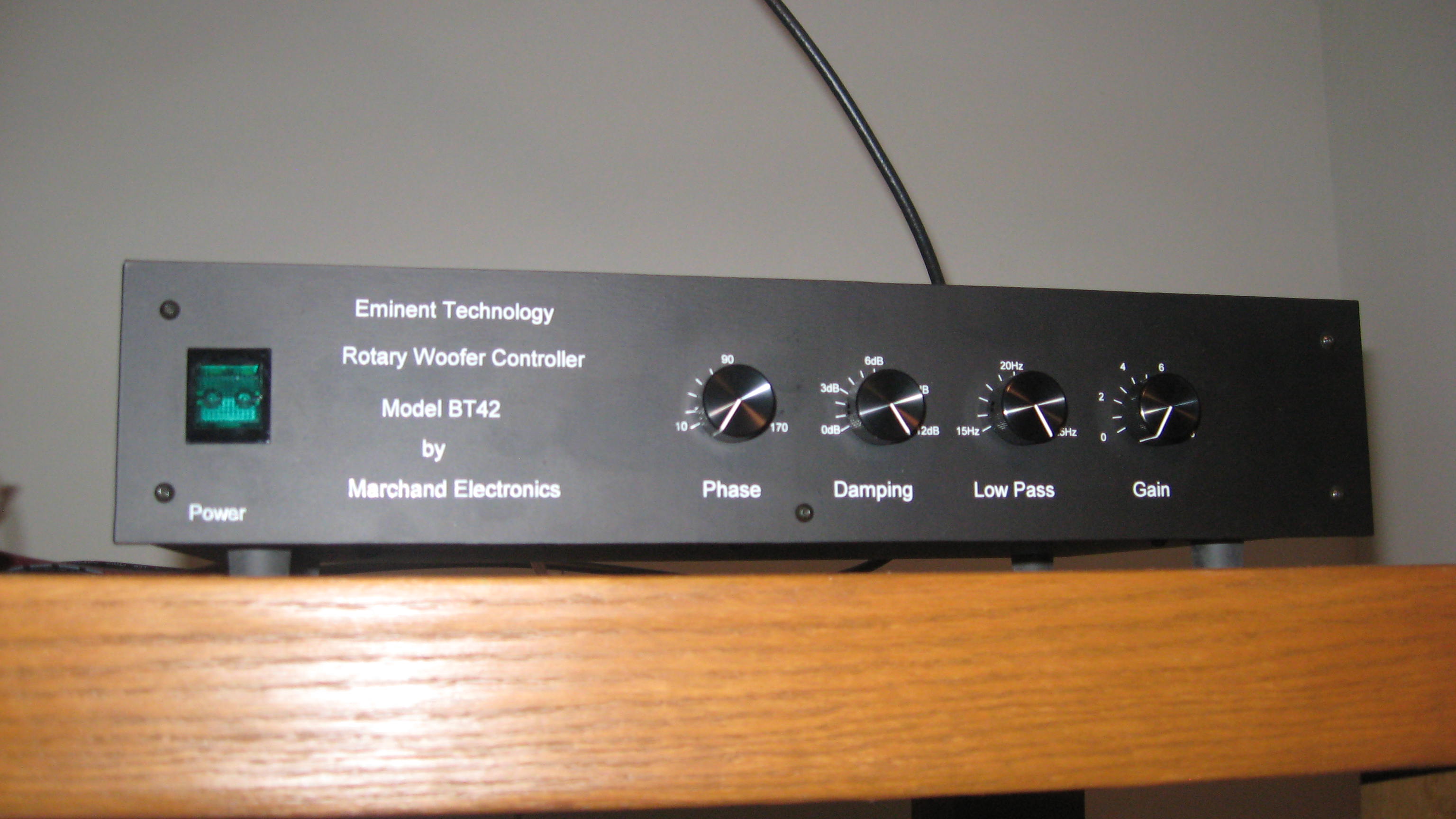

So in the neutral position, is the fan inaudible?I use Eminent Technology's rotary woofer controller
that includes a variable low pass xover (15 hz to 25 hz) which I set at 25 hz. This controller has a 200 watt amplifier which pitches the blades, variable phase
control, damping and gain controls. The power comes from the ac current, rotating the fan. The only way that air would have a direction would be with a dc signal
which would never happen (- dc signal would suck air out of the room, a + dc signal would blow air into the room. A normal ac signal would be both positive and
negative, producing low frequency sound. When there is no LF content the blades of the fan are in a neutral position, producing no low frequency sound.

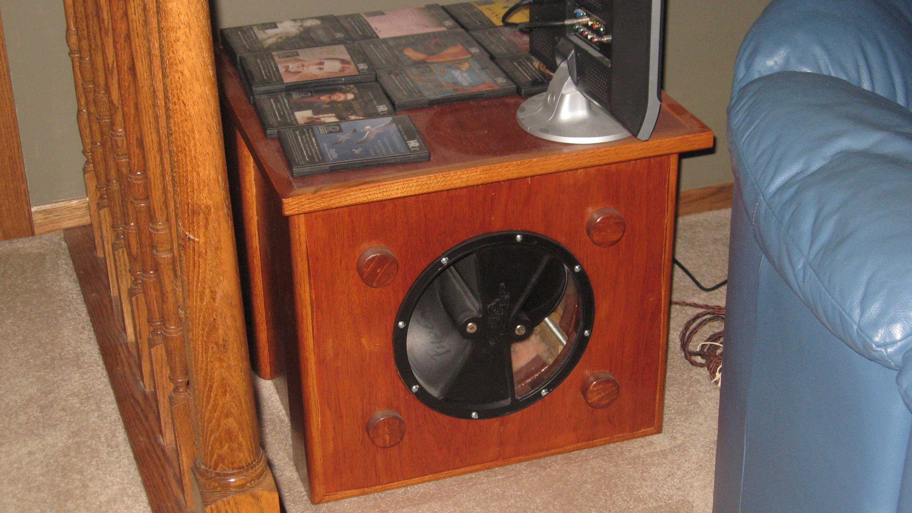

Fan noise
The fan noise is muffled by the the large enclosure that
is lined on all inside surfaces with 6" fiberglass. From
the listening seats the rotating fan is just barely audible
with no music playing.

6" fiberglass = an acoustic low pass filter.
How far is the fan from the listening seats in your instalation?
Built by Marchand Electronics for the Eminent Technology TRW-17 Rotary Subwoofer View attachment 208297

Distance from rotary sub
The distance from the vent opening, for the rotary sub,
to the listening seats is 13'.

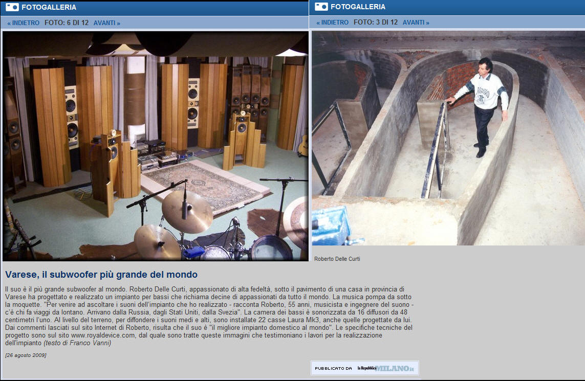

The largest horn sub in the world
Check out this world's largest horn enclosure "The Royal Device Audio Room on the web. This is what is needed to get down to 10 hz efficiently. Even with this huge horn enclosure the response is limited to 10 hz. The Rotary subwoofer is capable of response to below 1 hz, with a measly 200 watts of power.

Not exactly. That is but one way to go down that low. There are other methods.
I design loudspeaker enclosures for a good percentage of my income. 3200 liters will get you almost flat to ten hertz. And that is is two Pi space not cheating corner loading. The efficiency I quoted is also worked out in two Pi space. Throw in the room gain and a properly sized rear volume for the woofers and you will get very strong response down room six hertz. Power input will be under one hundred watts most of the time and generally loaf around ten watts. Yes it is a very large box. But just as you have your fan and coupling manifold tucked out of sight and out of mind in like manner a horn subwoofer can be implemented.
