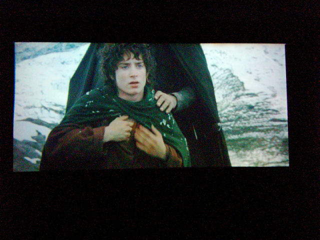

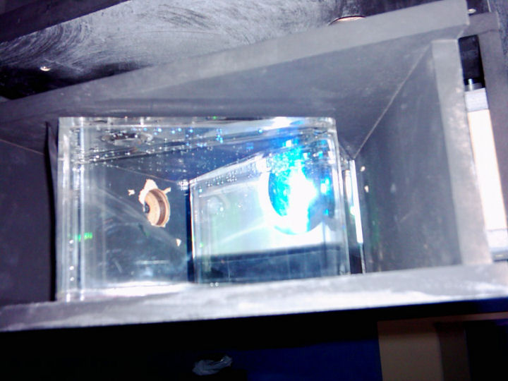

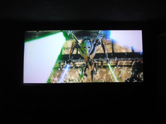

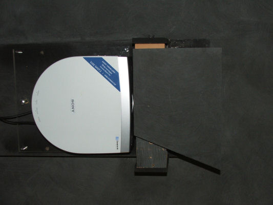

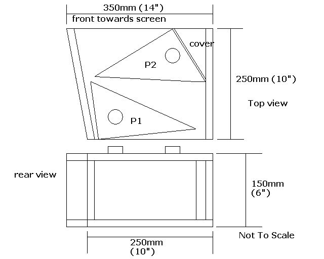

If I have understood correctly the best results are obtained with clyserine filled prisms.
I made one with antireflection glass and clyserine filled prisms some time ago.The main reason for making the lens was my entry level LCD projector with 854x480 pixels and plenty of screendoor.The lens really makes wonders to the picture,I watch at 1.4x screen width at the picture projected by this sheep combo of DIY lens and the not so perfect projector.
Some time ago I tested how is the picture without the lens and was really surprised at the amount of the digital artifacts in the picture.
The picture is distorted by some barrel distortion,it was possible to adjust the lens so that the bottom side of it is straight,this way it is nicer to read the substitutes.Not sure but seems like the contrast ratio went down as well,it was needed to up the colour level. The lens is reflecting a dim second picture to my white ceiling,this could be avoided by making a small lid in front the lens,I suppose there goes the extra brightnes gained by the use of full resolution in 2.35:1 movies.
The lens is not really so difficult to make,it took surprising amount of time thought.......and the big question ,did it LEAK?
Oh yeah it did,the pvc material and silicone I used at first didn't colaborate very well
silly me....
It was worth it, the 100$ was well spent.Hopefully my next projector will be of higher level and less screen door,do not know if this lens can be used to improve the picture then ,but so far so good 🙂

it works!
My Anamorphic Prism Lens Project
The goal of this project is to be able to watch all of my films at the same height, yet preserve the geometry of the image, so, that for films presented in “scope” ratios like 2.35:1 will be larger than conventional widescreen 1.78:1 letterboxing. It is possible to view both 16:9 (1.78:1) and 21:9 (2.33:1) at the same height from any 16:9 native projector.
IT WORKS! The lens is basically a pair of liquid filled prisms. Each prism is wedge shaped, that when viewed in plan, is based on a right angled triangle of 30/60/90 degrees where each prism (I made mine the same size) is approx 190mm wide by 120mm high.
I have had these prisms made from 6mm (1/4” Perspex) by a plastics engineer and so far this project has set me back just $82.20 and several hours of my time. A commercial equivalent starts at around $1500A with some units costing well past $3000.
As this is my first play, I have elected to fill both prisms with water. Good news, the prisms don’t leak 😀.
To make this work, you must perform a few steps –
1. The source must be set to WIDE or 16:9.
2. The projector must be set to run in both a 4 x 3 mode and a 4 x 3 full panel mode. Note: do not use the mode that stretches the image, that is the job of the lens. I have set up two modes, 1 is 4 x 3 so there are side bars and 2 a full panel 4 x 3 mode. The first mode ( 4 x 3) is used for all 16:9 program. The other mode is used for 21:9 mode. Note that this mode actually clips the top and bottom off the image, but as we do not want to project black bars at the top and bottom of the image, it works to provide us with an image at the same height as the standard 16:9 image.
There are some positives and some negatives (but that goes for almost everything in life), but with some tweaking, I feel confident to say that this is a very cost effective and usable upgrade.
The positives –
1. Very clear images
2. Brighter images of up to 30% (others have measured this with a light meter)
3. Constant height - Wider images for those that SHOULD be wider no black bars top and bottom wasting precious pixels.
4. Variable stretch. If 20:9 becomes a standard with HD DVD, your covered
5. Reduced SDE. I did see some scan lines, but the lens has virtually eliminated all traces of SDE, yet the on screen image is still sharp and clear.
6. Works with all projectors even those with very short throw. This was a point that was brought up with commercial products, that those products did not work with short throw devices. If it works with my horrid HS -3, then it should work with any unit…
7. Very cost effective. So far just $82.20😀
The negatives –
1. Pincushion - Some edge distortion (pincushion) was seen on the left hand side tonight. I feel that by the time I have built the casing and the mounting system, that I should be able to fix this.
2. Barrel distortion - I have been aware of “barrel distortion” for the last few years, and designed a curved screen to correct this.
3. Size and weight – this is a problem if your into neat and tidy. The fact that my projector has a recessed lens caused me to build my prisms large. If the prism is too small, it will chop of the top and or bottom off the image. My prism dimensions are listed above, but should work with a variety of projectors, even those with large lenses…
4. Tilt factor – part of bending light requires the lens to be tilted a fair bit. Again, not too good for the neat and tidy look…
Over all I am impressed with what I have achieved for such a small outlay. I am planning to build a case that will allow both prisms to be adjusted, titled up and down as well as side to side. I should have this part completed early next week and will start to post some images…
Mark
PS I would like to thank Hoxford for starting this thread and the likes of Tor for sharing. This project is looking to be very successful🙂

another screen shot
Here is an update. A screen shot from Star Wars 3...
As I said, not bad for less than $200.00 and consider this -
1. I am using an entry level, short throw SONY HS-3.
2. A DIY screen. The white PVC material that laser letters are stuck to.
3. A DIY anamorphic lens - prisms cost just $82.20.
4. Both of the prisms are filled with water and tap water at that!!!
Mark

Hi Jude,
Thanks for the feedback. I had a plastics engineer construct the prisms out of 6mm Perspex. Though I think that less than $100 is deal anyway! He made them water tight and fitted a removable threaded bung in the top of each expansion chamber. I made the jig and he heated and bent the plastic, then i made a case. For a full run down on my project, go to http://www.hometheaterdiscussion.com/forums/showthread.php?t=5867&page=1&pp=25
This anamorphic lens you bought, what stretch does it have. The Prominar 16H I bought (comes off a 16mm projector) is 2.0:1 stretch, and if you read the thread from the beginning, you will see how I found this site and ultimately built my own 1.33:1 Horizontal stretch lens.
I've been having some fun with this true 2.35:1 lens by turning it 90 degrees and placing in front of a digita camera, then zoom just enough to remove any barreling.
I have been able to capture horizontally squeezed images, then using photo shop, electrically stretch them back to the proper shape. Really cool. I just need to make a mount for the camera and lens so it is a single unit.
True panoramic, none of the normal blown up letter boxing you get at photo labs...
The attached image is the the DIY lens in front of the SONY HS-3. I colour coded it to match the ceilling 🙂
Mark
