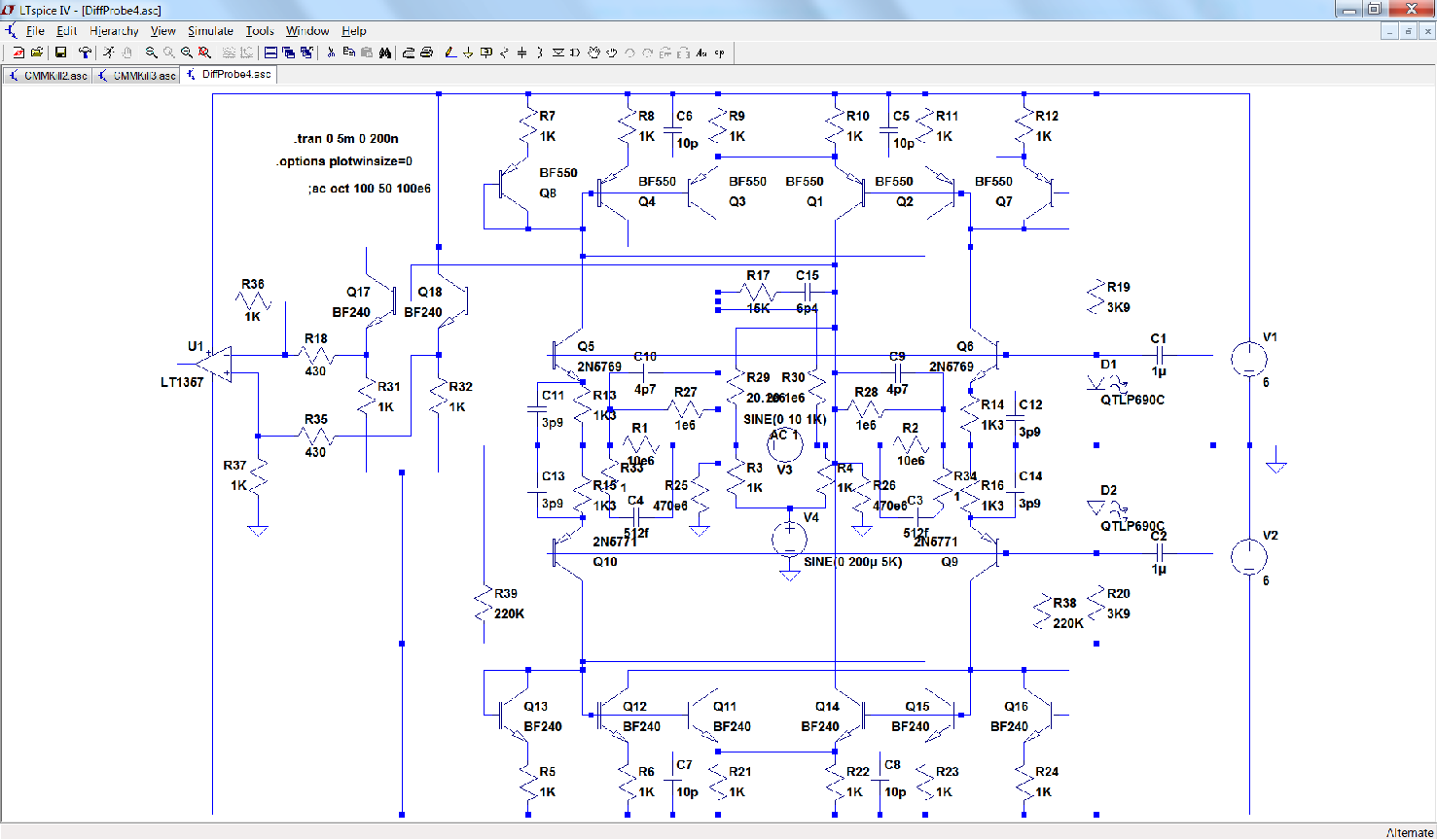

It is feasible, but it is fiendishly complicated, unless you resort to advanced optical isolation techniques.
Here is a taste of such a beast (just the front-end): it measures millivolts of differential signal in the presence of kilovolt common mode, with a bandwidth of 25MHz.
I am certainly not going to attempt describing it....

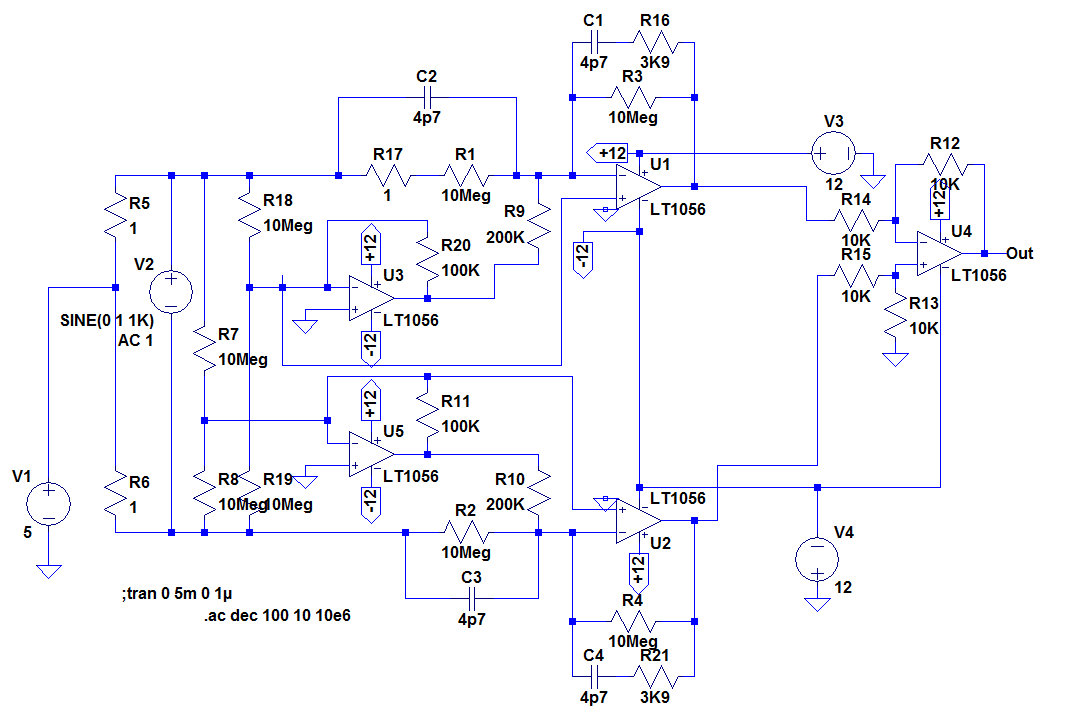

In your case, you could reuse the principle of the smart probe, but with a more suitable ratio of 1:10, lower resistor values, a wide bandwidth opamp and a careful compensation scheme.
Another alternative is the following circuit: it is basically a differential amplifier, but equipped with a "common-mode killer", allowing to uncouple the common-mode signal handling capability from the differential gain: here, the differential gain is 1, yet the input accepts hundreds of volts (note that R16 and R17 are not actually needed, they are just there to study the effect of mismatches).
Of course, as there are no free lunches in engineering, the differential amp has its noise gain increased...

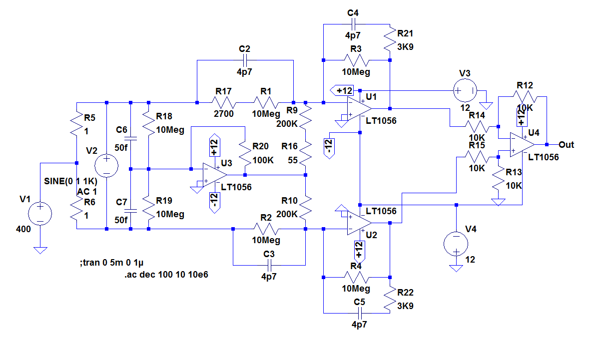

This is a somewhat more complex version of the same principle, it probably has some advantages over the previous one, but I don't remember which...
This has actually been built, with a TLE2074, and the bandwidth exceeds 4MHz.
With a better opamp and lower resistor values, a higher bandwidth should be attainable

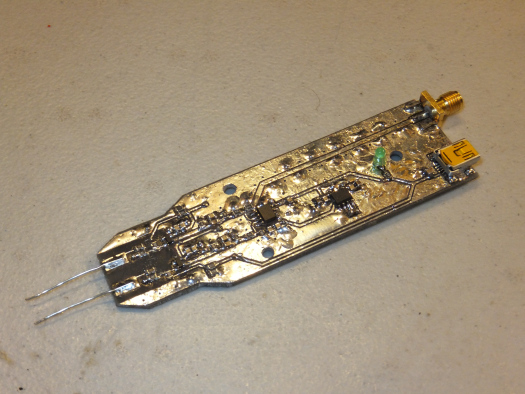

https://xellers.wordpress.com/electronics/1ghz-active-differential-probe/
