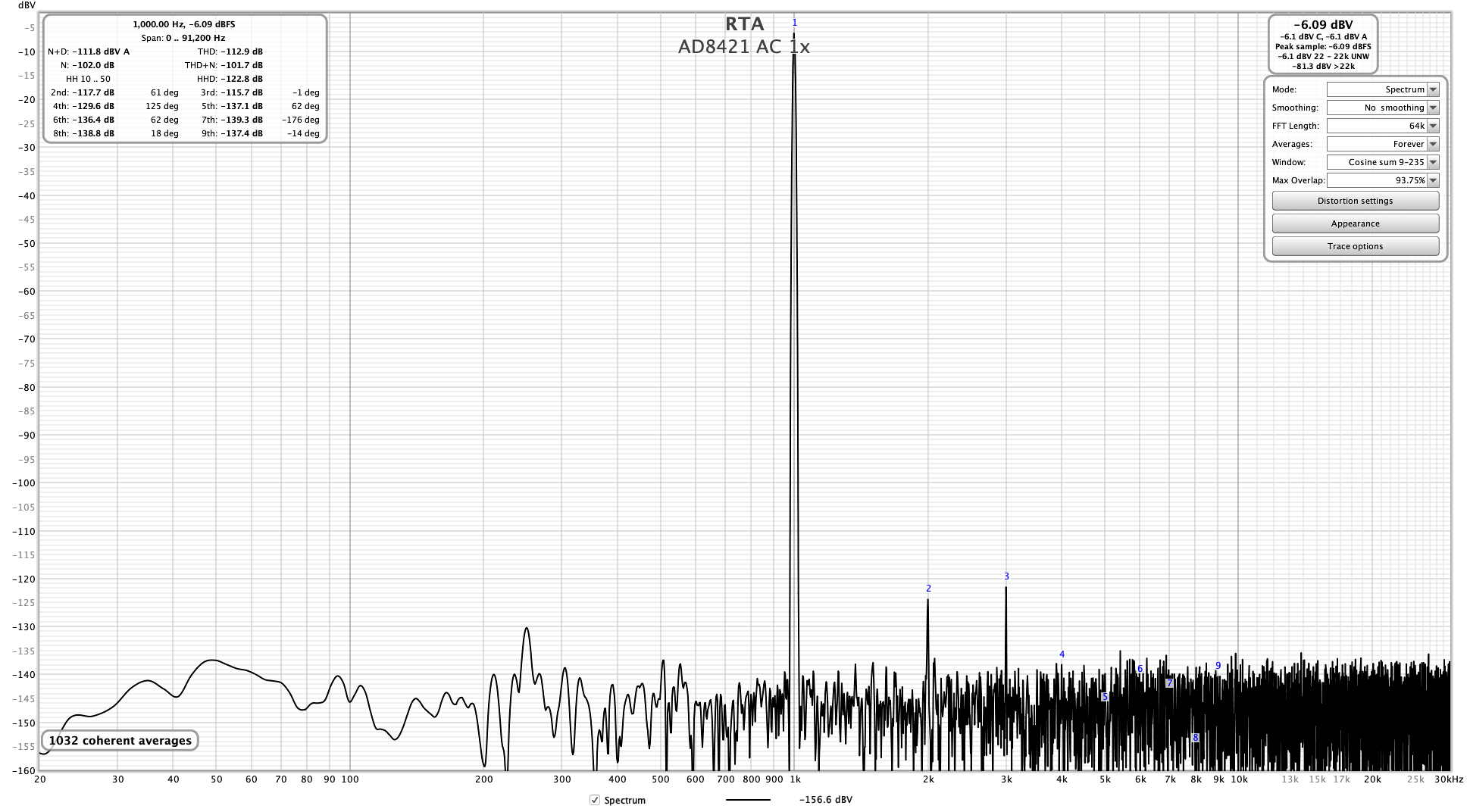

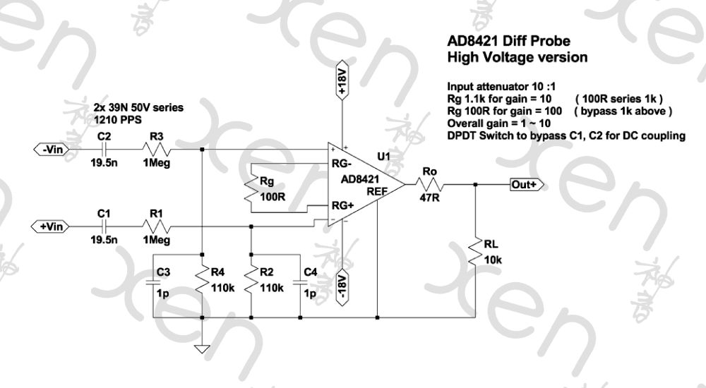

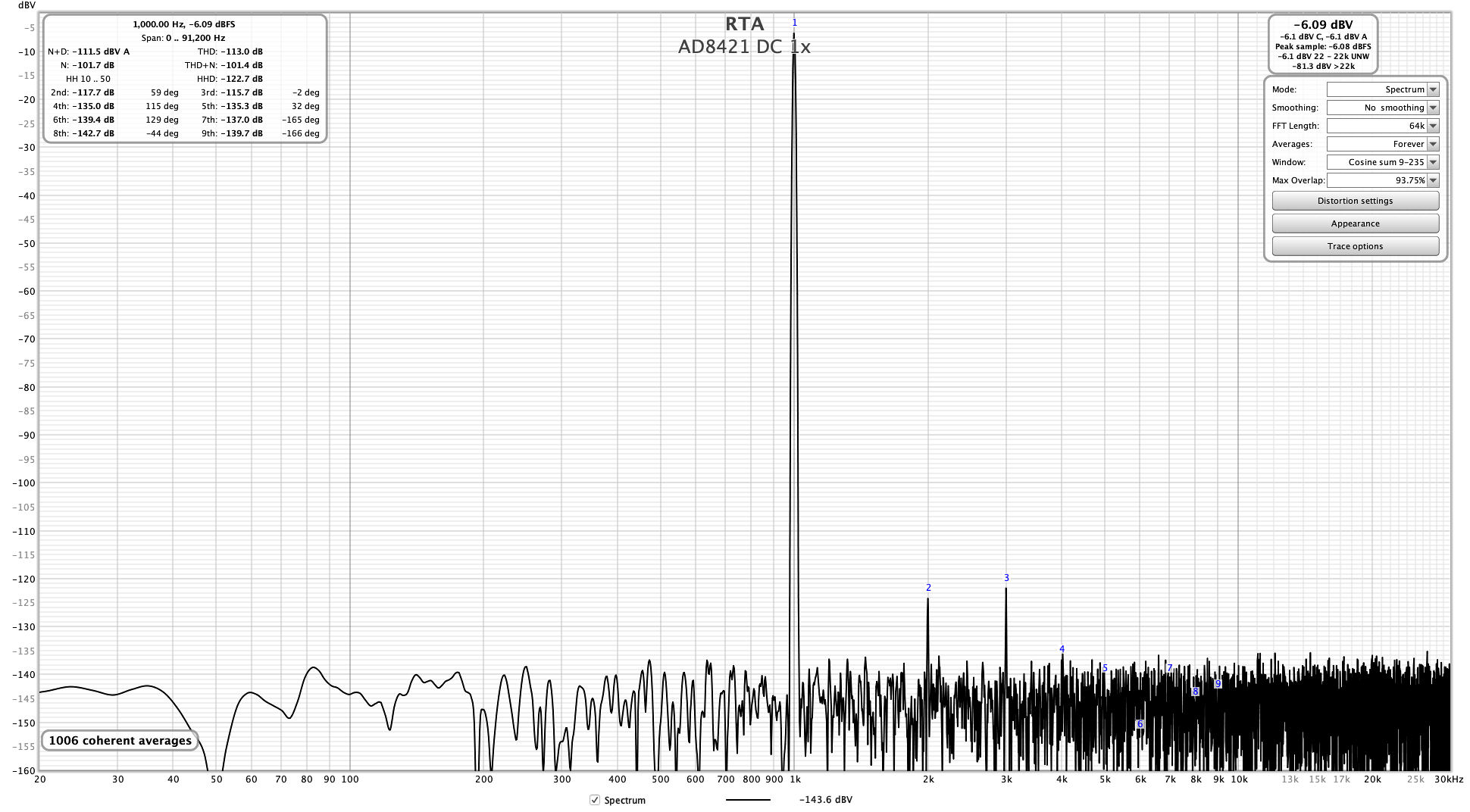

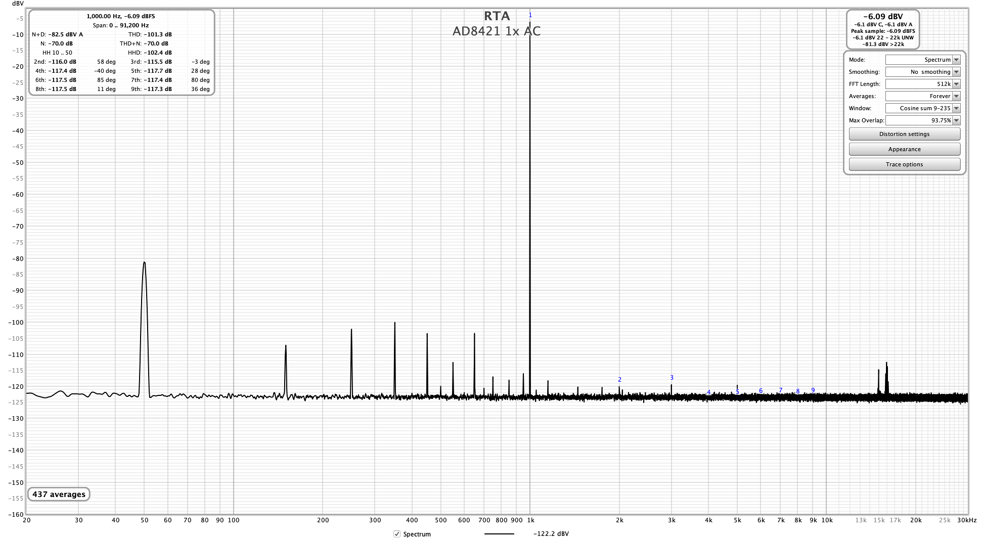

EUVL Member Joined 2003 xen-audio.com 2020-05-12 8:49 pm #41 2020-05-12 8:49 pm #41 Someone asked for the schematics. Here you are. Patrick . Attachments Diff Probe 8421 HV Sch.PNG 133.7 KB · Views: 617 EUVL Member Joined 2003 xen-audio.com 2020-10-17 7:23 am #42 2020-10-17 7:23 am #42 NicMac also built one and did some distortion measurements with his RTX. CMRR is measured to be -76dB. Patrick . Attachments RTXloopback.png 137.9 KB · Views: 206 AD8421_AC_1x_.png 140.8 KB · Views: 181 AD8421_AC_1x_coherent.png 193.4 KB · Views: 186 AD8421_DC_1x_coherent.png 195.2 KB · Views: 188 Prev 1 2 3 First Prev 3 of 3 Go to page Go You must log in or register to reply here.
