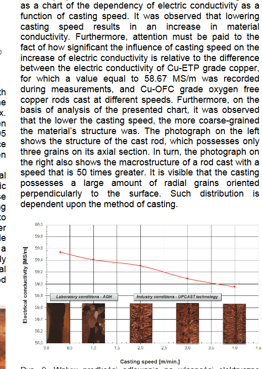

Here are a couple I have been digging into recently:Help me out, does anyone have a link to a non-marketing technical article that has measured data of physical parameters for OCC copper. Things like thermal capacity and conductivity, fatigue and Youngs modulus, chemical stability, and electrical parameters. I did a quick search and found nothing. I am trying to keep an open mind.
Copper More Conductive than Silver
Thesis on Fine Grain Copper
There is some very good scientific research showing how reducing grain boundaries can improve signal transmission.
