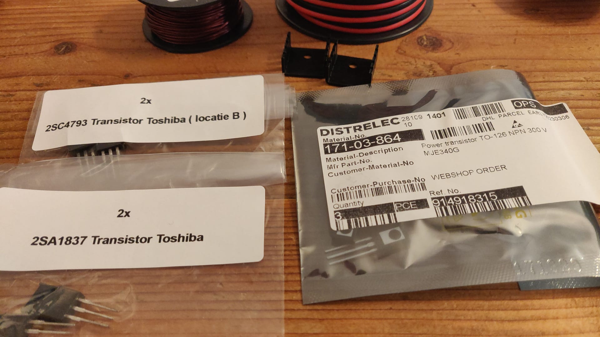

Toshiba drivers

Toshiba drivers

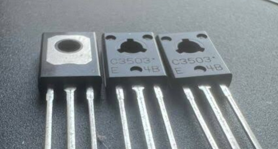

I don't think you need shoulder washers with those transistors. The to-220 seem to be the fully isolated packages and only require a tiny bit of thermal paste. The to-126 have isolated mounting holes and can do with only a thermal interface (mica or silicon pads). In Stuart's pictures you can clearly see that he does not use isolating shoulder washers. Note that the mica pads require also a small amount of thermal paste on both sides to reduce the thermal resistance. Only then do they have slightly better thermal performance with respect to silicon pads. I still prefer silicon pads as they are a lot less messy when mounting (and future disassembly).Gathering the basics.

@wkloppen You will need shoulder washers for the TO-220 packages and possibly some of the TO-126 packages. The MJE340Gs used for thermal compensation have a conductive back and plastic on the top. The TO-247 (TO-3P) and TO-264 do not require shoulder washers, at least for the On-Semi parts I have.
Using a insulated shoulder washer even for TO-126 that have a insulated hole is a good idea, because if your mounting hole is slightly oversize this can allow enough clearance if the transistor is pushed all the way to one side of the hole in the heatsink. The non insulated surface of the transistor can then make contact with the grounded heatsink. Using a insulated washer prevents this.
