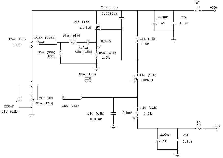

I want to know if i can use this old DIY D1 I/V STAGE schematic for a SE PCM1704 DAC or it's necessary to change something or if needed I am open to use another suggestion
The mosfet must be matched, if yes wich value?
You should raise R2a's value a little bit unless you can accept around 1Vrms output. If you raise R2a's value, you need to change source resistors value accordingly too.
About Mosfet match, it's easy to get a 1% Vgs matched pair from same production batch.
About Tx I got the information is 50VA, now I only need to know wich resistors & values for 2Vrms?
I think Tx 2x30VAC & 50VA is per channel or is in total?

I need to know wich resistors & values for 2Vrms?
Please help.
I got it the informtaion I think its 10-20mA per channel.
So 10VA would be minimum.
I will use only 1 tx 2x30VAC 50VA for stereo.
well - you asked , and I wrote exact currents on schematic , which you obviously didn't looked .
anyway - power cons. is under 1W/per channel
exact requirement for xformer depends of reg used ;
I know that with regs I usually prefer , 50W will suffice for both channels
in your case , you can probably feed 10 stereo D1's with 50W
Wich value for R2a (R2b) & wich resistor is source resistor & value needed to get 2Vrms?
besides that - you need to know on which DC level is output of PCM1704 , so you'll need to set input of D1 to same level
The I/V is designed for DAC current output PCM1704, PCM56, etc.
well - either ask Salas , or post exact schematic here , or post link to it .
Minimum diff. to work 8-10V Vin-Vout, so for 42.3Vin can regulate 30Vout
