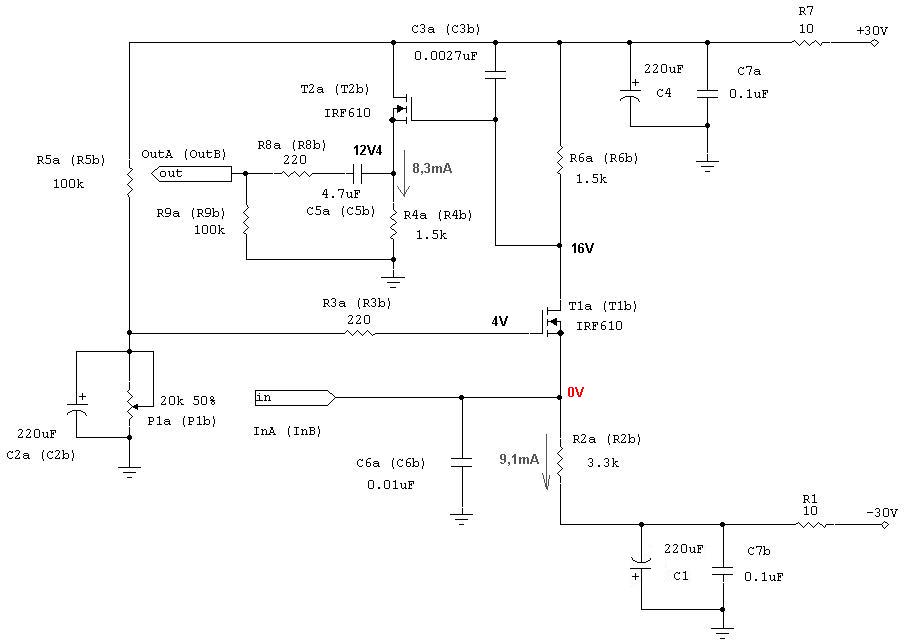

I see this other schematic with reversed drain/source IRF610 position
Wich one is the correct?
sources are down ( to negative ) and drains are up ( to positive ) ;

Thks ZM, so my schematic is OK, right?
yes - schematic from http://www.diyaudio.com/forums/pass-labs/181449-diy-d1-i-v-stage-2.html#post2534689 is correct - sources pointing down
PCM1704 - if connected by datasheet - have 0 offset at output
connect D1 to it , then you must set - with P1 - that you still have 0V at PCM output/D1 input
rest is irrelevant

before connecting D1 to PCM - you need to set P1 to have approx. 0V at I/V input , measuring against gnd
then you connect D1 to PCM , power up everything and do fine setting after some time ( when everything is in temp. equilibrium .
simple as that .
if something is not working - something is dead .
either PCM or D1 .
edit :
schematic with approx. voltages attached ; what is important is just red 0V value ;
all other voltages approximately , and valid only for troubleshooting purpose

While adjust DAC I measured I/V:
Left channel
R6 // Drain T1 // C3 14.20V
R5 // Gate T1 // C2 // P1 3.45V
C5 // Source T2 // R4 10.77V
R2 // Source T1 0 V
Right channel
R6 // Drain T1 // C3 14.17V
C5 // Source T2 // R4 10.74V
R2 // Source T1 0 V
Are the measurements right?
