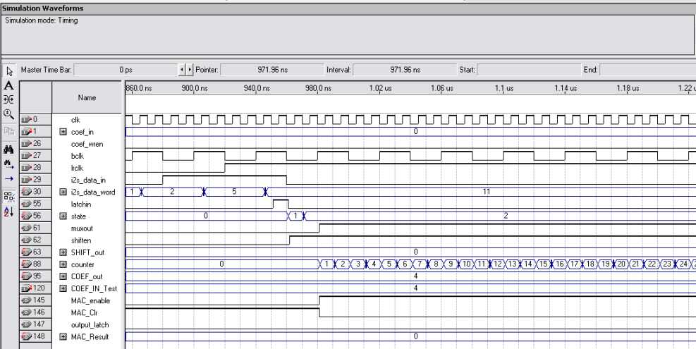

Phew, quite a lot of posts since I last checked! I think this is the first time I've seen someone using Denis Sbragion's DRC filters on a DSP chip. This is very interesting.
I haven't had chance to post in a while as I've been slaving away for the past three days designing an FIR filter for FPGA's using Verilog. I don't have a huge amount of experience with Verilog programming, but I've got quite far (considering it was pretty much all from scratch).....
I now have a 16-tap FIR filter block, and you can easily cascade the block to add more taps. It's all done in parallel, so as soon as the first sample is received (24bit I2S format), all taps are calculated simultaneously (on the next system clock tick) and the result is sent to the output block. The output block then waits for the next I2S bitclock and starrts outputting the filtered result straight away. This means that there's only half a sample delay between the input and output (I'll probably change this to one sample delay.)
It's still at early stages atm, and it's only set up for 24bit filter coefficients, but the simulations suggest it should work. The coefficients could be quite easily loaded by a cheap PIC chip or something by "clocking in" the words. (or possibly via USB.)
I know there's a lot of talk about dedicated DSPs etc, but I think the low-level nature of FPGA design makes things much easier to understand (and easier to program.) This should make it more accessible, and easy to understand for anyone familiar with DACs and I2S protocols. It's also much easier to add more channels (if they will fit) and this can be done by a simple "drag and drop"! Of course, the other main aim is to make it economic too.
A few questions though.....
Roughly how much does the ADSP-21369 ez kit cost?
After 16 taps are multiplied and the totals added, I end up with a 52bit wide result. How is this supposed to be scaled down to fit the 24bit output?
I've attached a screenshot of the simulation waveforms. "i2s_datain" is the serial data from the source, "result" is the filter result. The result will be the same as the input, as only one coefficient is loaded, and it's set to "1". Please note that an actual I2S sample would be more like 20us long rather than ~1500ns that it is in the simulation!

Welcome to the world of verilog!
I think that you will run out of multipliers pretty fast when you try to cascade blocks for longer FIR filters.
Since the data will be comming in at a pretty low rate, assuming 16 bits at 48kHz, we are talking 0.768Mhz!
With a simple RTL design you should be able to synthesize to at least 150-200MHz, thus a iterative approach can be implemented, in which for each incomming data sample the multiplier block is used say 200 times at 150MHz on the same sample but using different coeficients.
The final result needs to be scaled back to the 24 bits domain by dividing by a constant that will be related to the filter length.

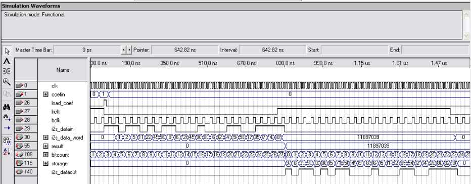

eg. at the moment, I have 48 taps. In the simulation I have a result of 11,897,039. If I divide this result by 48 I get 247,854 instead of 247,854.97916666. So, I can see where the dithering would need to come into it.

eg. at the moment, I have 48 taps. In the simulation I have a result of 11,897,039. If I divide this result by 48...
This doesn't really need talking about now, but I thought I might as well mention it since I'm here: you don't need to divide by the number of taps. The result you come out with be the right size already. It will need chopping down because it's got too many bits of precision, yes. But the chopping happens from the bottom end of the word (precision is lost, but actual magnitude is not significantly altered) and the amount you remove just depends on how many bits you're able to use as your result. If you're able to use all 52 bits then you just use them as-is. No scaling or shifting or anything.

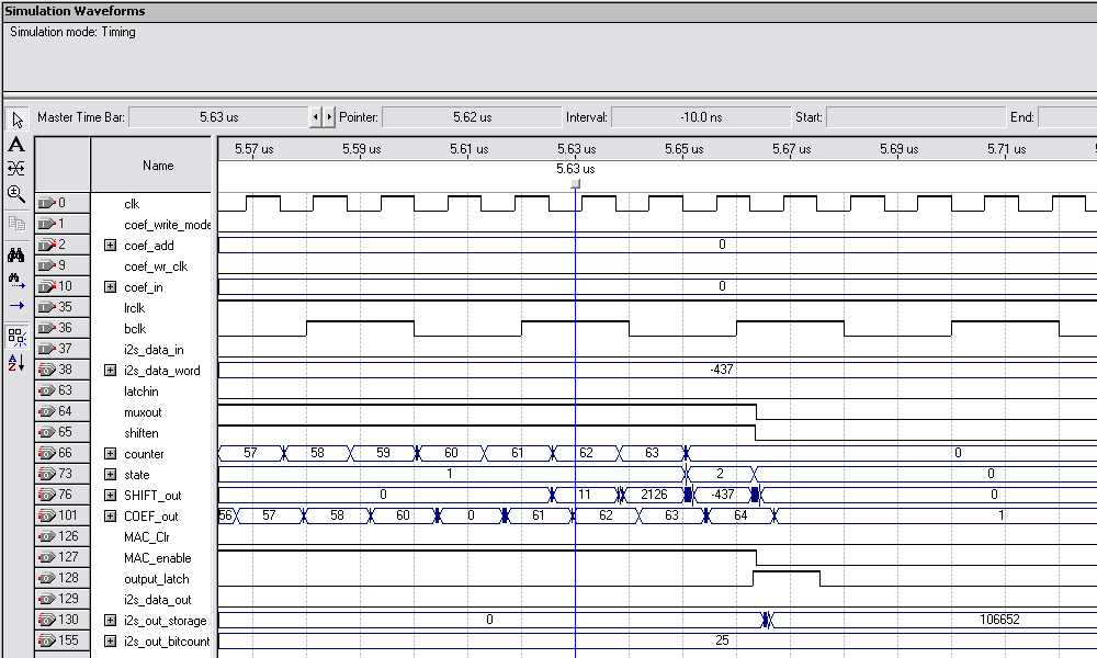

Hi, Wingfeather,
Ok, so I've got a 52bit result from the FIR taps.....
1011000001000000100001111100001100100000001000000100
So I then shift right 4 bits (where the LSB bits wrap)....
0100101100000100000010000111110000110010000000100000
Then add these two 52bit numbers together and take the top 24 bits as the new result.

I've tried using logic elements as shift registers and doing all the calulations in parallel, but I realize now (as everyone said) that it takes up far too many resources (and far too long to compile).
So, I've started on a design which processes the taps using raw clock speed (in a kind of serial fashion). The problem I'm having at the moment is that I'm using the RAM-based shift register megafunction (24bit wide / 32 taps), but the data never seems to get latched or output?
I've attached a simulation output which shows "shiften" going high. This is connected directly to the shift register's clken pin. The clk pin itself is connected to the master clock (100MHz atm for simulation).
The data input to the shift reg is directly from "i2s_data_word", so in theory it should at latch a few "11"'s into the shift reg when "shiften" is kept high for a few clocks?
Even if I keep shiften high for 36 clocks, the data from the input never appears at the output?
I'm guessing this might be a bit tricky to give suggestions on without the full diagram and code, but I'll send you the project if you'd like.
The basic layout is.....
First of all, the shift reg has a 2-way mux at it's input which allows either a new I2S word to be input, or it loops the shift register's output back to it's input. There is also a MAC block to process each tap and sum the results.
1. The coefficients are first loaded into a RAM block
2. MAC block is cleared / mux set to data input mode
3. Wait for the first input sample word to be arrive (from the I2S input block).
4. Shift the latest I2S word onto the shift reg (allowing the last word to "drop off the end")
5. Change the mux to "loop mode"...
6. Shift a tap (word) onto the loop
7. MAC (multiply / accumulate) the tap with the corresponding coef from the coef RAM block.
8. Repeat step 6 until all taps are processed.
9. Latch the final MAC result into the output block to output the new sample.
10. Restart (go to step 3)
All that really needs to happen with a convolution (as far as is my understanding), is that when a new sample arrives, the taps are shifted along and the previous last tap is discarded.
So, you just need to use a shift register to store the 2000 or so words on, then "MAC" all stored taps with their corresponding coefficients and output the final result before the next input sample arrives.
At 48KHz, a new sample arrives every 20.833us.
At 50MHz, to process 1024 taps (one tap per clock) would take 20.48us)
So, as long as the master clock is fast enough to process all stored taps before the next new sample arrives, it should work fine.
Or, you could partition the design so that you have two 512 tap shift registers,
two 512 word coef RAM blocks, and two multiplier blocks, then it would only take
512 clocks to process all the taps (results from both multiplier block are summed.)
But, after every 512 clocks, the position of the first stored tap would change
between "shift reg A" and "shift reg B", so you would have a fairly complex
setup to load the latest new sample etc.
The main aim atm is to use RAM blocks instead of logic cells so we can process some long filters without filling up the FPGA.
Hope all this makes sense. Trust me, I'm still trying to get my head around it!
OzOnE.

Quick update, I've found that the shift register is actually "taps" X "distance between taps", so it does work, but not as I need it to.
ie. If I have a shift reg of 4 taps, with a "distance between taps" of 3, you have to shift 12 times to get an output. Oh well, I'll figure it out. I just need to get this part working in RAM 'cos it looks like the rest is almost working.
OzOnE.

Hi all,
Made a fair bit of progress with the FIR design.... I now have a 64 tap filter, which can easily be extended to 1024 of more taps and multiple channels. The main requirement is that the FPGA has enough RAM bits as the design takes very little logic resources.
A 1024 tap / 24bit coef filter will only take around 450 logic elements on a Cyclone II. The memory bits needed is roughly "taps X width", so a 1024 tap filter should only take around 25,000 bits.
I've attached a screenshot of the filter after three audio samples have been processed. The screenshot shows that it is now working properly with signed data. The example shows a MAC between SHIFT_out and COEF_out, so it's basically doing.....
(11 * 62) + (2126 * 63) + (-437 * 64) = 106652
The result of the MAC is latched to the "storage" register in the I2S output block and the result sample is then output when LRCLK next goes low. So, as long as the master clock of the FPGA is fast enough to process all the taps, there is only one sample delay between a new sample arriving and the result of all taps being output.
Again, probably a fair amount of work to do and a few bugs here and there, but looking go so far.
OzOnE.
