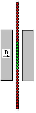

Here's an idea that could be one-up on Hartley's: electromagnetic suspension (see pic).
The green winding is a normal voice coil, and the two sets of red windings would carry opposed DC, pushing the voice coil toward the zero-excursion point.
Advantages would include no addional Le or hysteresis, and perhaps less mass.
Adjust the DC voltage to dial in a target compliance!
Obviously, you'd still need a means of lateral positioning...still thinking...
Bill

I think you've hit a good idea there Bill. Quick, I'm running down to the patents office.
So now you'd have power requirements for the suspension as well. The potential for variable compliance sounds excellent. Imagine tuning your driver somwhat per application.
Rather than increasing the the air gap to fit another set of voice coils inside, perhaps it might be possible to raise the whole suspension part of it. Let's see of I can knock up a drawing...
Would the AC current going through the outer coil be affected in anyway by the two DC coils underneath?

Yeah, if you're thinking what I think you're thinking, I already thought of that ... 😉 The trouble with moving the suspension mechanism away from the VC is that you'll need a second magnetic gap and a longer former which equals complexity and added mass.
I just thought of a way to keep the gap narrow: stay tuned...
Bill

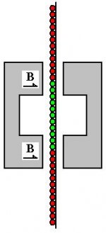

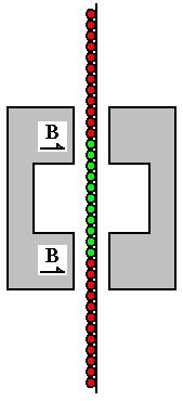

Now I know the drawbacks of an underhung voice coil, but what are the advantages?
For those like you and I in pursuit of performance--hang the expense and damn the torpedos--an underhung motor's advantages greatly outweigh the drawbacks, IMHO.
The core sweetness of underhanging is that it reduces distortion by flattening and smoothing the BL curve within excursion limits. No more nonlinear, modulating fringe fields to worry about.

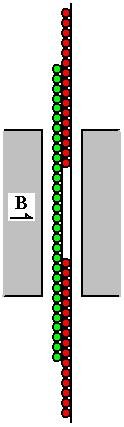

You could also explore an XBL topology, an interesting hybrid of underhung and overhung (I sometimes call it innerhung--see pic). The public isn't really supposed to know what XBL is yet, but I believe I've unmasked it in this thread.

Pat graciously accepted--Thank you. :grouphug: But you're not exactly rid suspensions yet--you still have to constrain your VC laterally within the gap. May I suggest a simple, low-friction sliding bearing, like a straw through a washer? If you want to get fancy, you could position the former between a trio of guide wheels. Etc, etc.
Bill

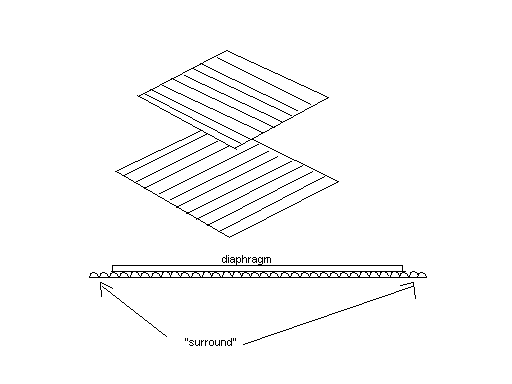

Hmm, now because of this talk about spider problems I thought I should try this flat diaphragm type. I was aware of that it might be too flexible, but in fact it's more rigid (size was ~4" x 4" and vc ~20mm) than any of the cones I have.
I built a prototype with this cardboard which has those "waves" one one side (I don't know what it's called exactly) and glued two of 'em like the pic shows. The "surround" was stiff enough that it didn't need any spiders..
Hope you can see the pic.. Otherwise I'll try again when I get home.

Waved cardboard = Corrugation.
My dad and I have experimented with this, and have found that you can make a very sturdy and pro-looking building material using corrugated 20-pound laser printer paper 😀 but that's probably irrelevant to this post, except maybe basket construction.
The surrounds and spiders seem to be the hardest part for people to get right. I made some surrounds of silicone but finally gave up on it--the silicone doesn't have enough Q factor and if you move the cone too much it splits--the industry standard seems to be cloth but I haven't the foggiest idea how to make cloth form those shapes!
The reason they go with cloth though, is that (contrary to popular belief) you can get greater Xmax using accordion surrounds, plus they don't break apart after 10 years of use. I would *love* to be able to make my own but I can't figure out how.

I thought I should try this flat diaphragm type...The "surround" was stiff enough that it didn't need any spiders
I'm aiming for a flat diaphram too 🙂
I found that the whole cone/former assembley held at just one point isn't enough. i.e a surround and a spider is needed to position the assembley laterally (as Bill puts it). Was your former kept perfectly in the centre of the gap with just a stiff surround?
Quite perfectly.. The cardboard is very stiff. But of course there's the thing that when the VC moves, it (I think 😕 ) tries to go also to other directions than just up or down... So some kind of spider would be good.
