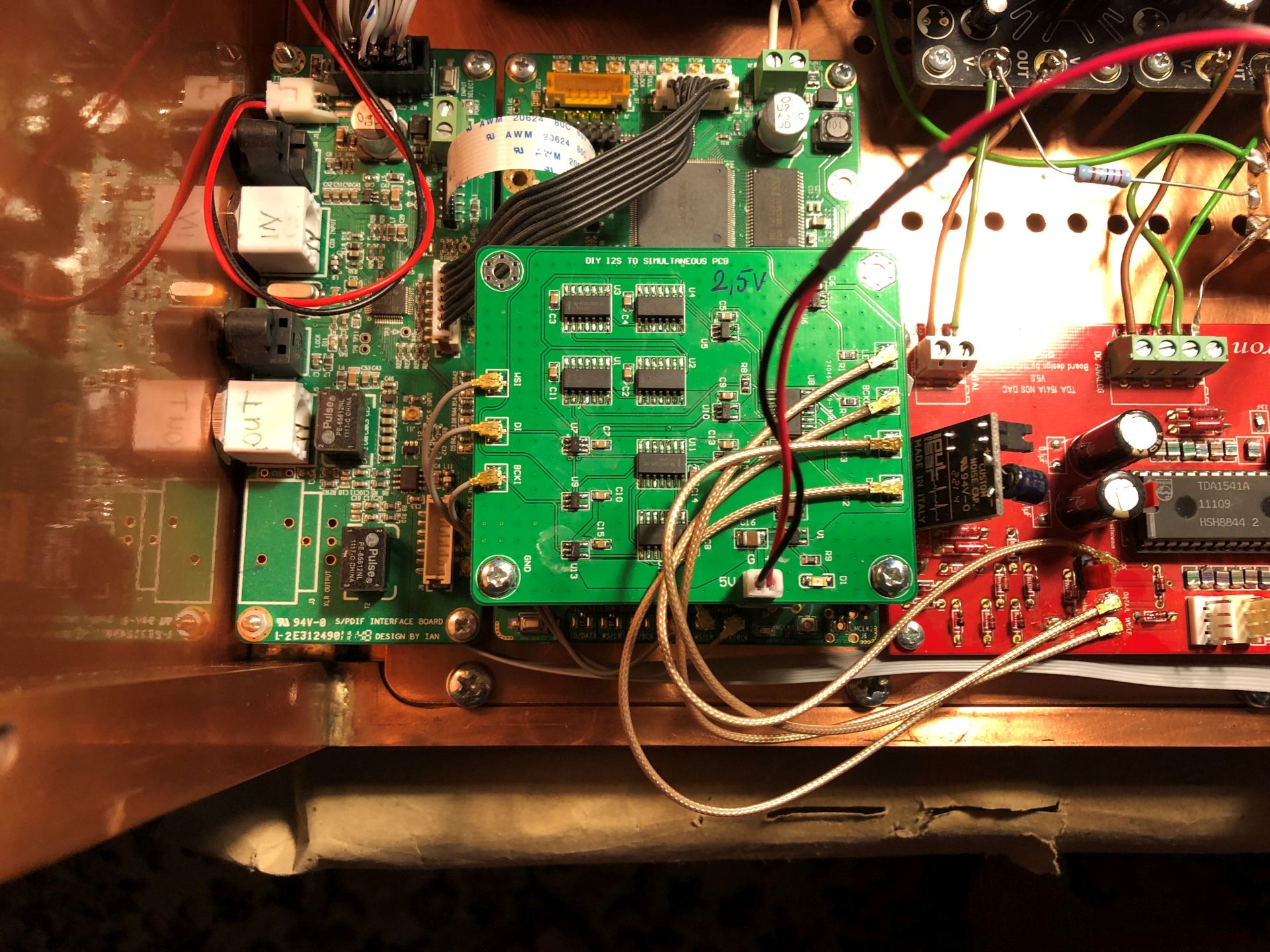

2.5V PSU version works well with Red Baron dac.

Had fun with my new reflow tool this morning - but the time the last smd went on the board I had it down to a fine art
Currently sharing power supply/regulator with the dir9001 receiver but it will eventually get a dedicated supply.
Had a nervous moment when it would not work after cutting traces etc. but eventually found that I had lost the +5v to pin 28 VDD+ >> once I corrected that it was all go.

After a period of listening I noticed I am getting white noise from one channel of my DAC - it disappears when I attach and turn on a source. I hadn't noticed it for so long because I usually turn on the source before the DAC and it plays fine - no white noise present.
I have swapped DOL and DOR connections to the chip and it changes side so that indicated to me it is in the signal coming from the I2StoPCM module. And it appears to be a fault in DOL. I've rechecked all my soldering and orientation of the ICs. All appears to be ok.
My I2S is coming from a DIR9001 module - I did not change the mode on this at all when I put the I2StoPCM card in there - I did of course change the mode of the TDA1541A chip. Is that correct?
Any suggestions of where to look?

Sorted this out.
Blew some more hot air around and made doubly sure it was all soldered nicely. Made myself a CS8414 receiver to eliminate the DIR9001 (some might say a backwards step?).
Answered all my other questions with help of google and applying a bit of grey matter.
Happy camper
Happy camper
