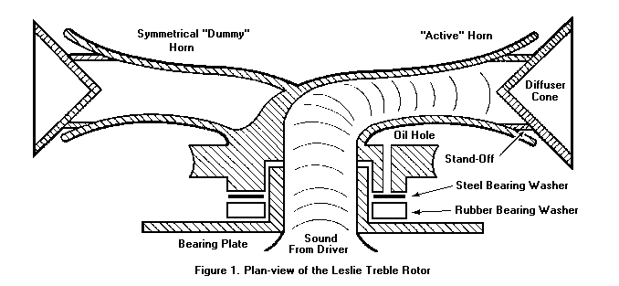

I figured out awhile back that the sound I was looking for was the upper rotor. The lower can be done decently with a simple automated eq of some kind, imho. The lows are not very directional, of course. I think there's a popular Leslie emulator that has a physical horn and electronically simulates the lower tremolo (forget the name atm). It might be useful to look for one of these used if within your budget - I know that's where I'm leaning for my own project. Will post back once I remember the details.
Edit: http://theatreorgans.com/hammond/faq/files/pro3review.html and https://www.msamps.com/pro-3xhttps://www.msamps.com/pro-3x but they are way pricey new. The horn, bearing assembly and driver (doesn't have to be the original - newer designs are way cheaper, more robust) should be in the $200 USD-ish range, depending upon buying used vs new. That leaves the motor, which is the part I haven't figured out yet myself.
The mercotac requires some kind of axle and wheel, and is definitely more complex/challenging vs a relatively simple bearing as used in the conventional Leslies 🙂

Interesting subject I hadn't thought about in ages. Back in the latest sixties when I was a young teen, my Dad came home from a business trip with special gift for his piano playing kids -- 3 of us, but mostly me: a massive Yamaha electronic organ with dual keyboards, 100+ keys & 1.5 octave bass pedals. It had a huge ear-shaped flat styrofoam main speakers maybe 3.5 by 2.5', and a flat rectangular smaller speaker of the same type in a separate chamber on the right side. The smaller speaker spun via motor on its short axis, and its speed was infinitely variable for Leslie speaker effects from slow phasey wah-wah to really fast woop-woop. It was a lot of fun to play around with. I think my enthusiastic garage band figured out how to run electric guitars through the amp & wah-wah speaker in the organ.
A web search suggests it might have been an Electone E-3.
Anyway, this spinning speaker would be hard to replicate without some extensive mechanical design & fabrication resources. Can't think of any light flat speakers that be adopted. But the basic Leslie speaker effects shouldn't be hard to emulate: it's just a deflector in front of the speaker that spins at different speeds causing variable phase effects and reflections, right? I picture a 4- blade box fan with 2 opposite blades removed, positioned in front of a normal 12/15" instrument/pro driver, spinning at different speeds. The motor would probably need to be replaced with something a lot quieter than what's in a regular house fan + speed control, perhaps with foot pedal or switch? A precision DC motor, probably...
