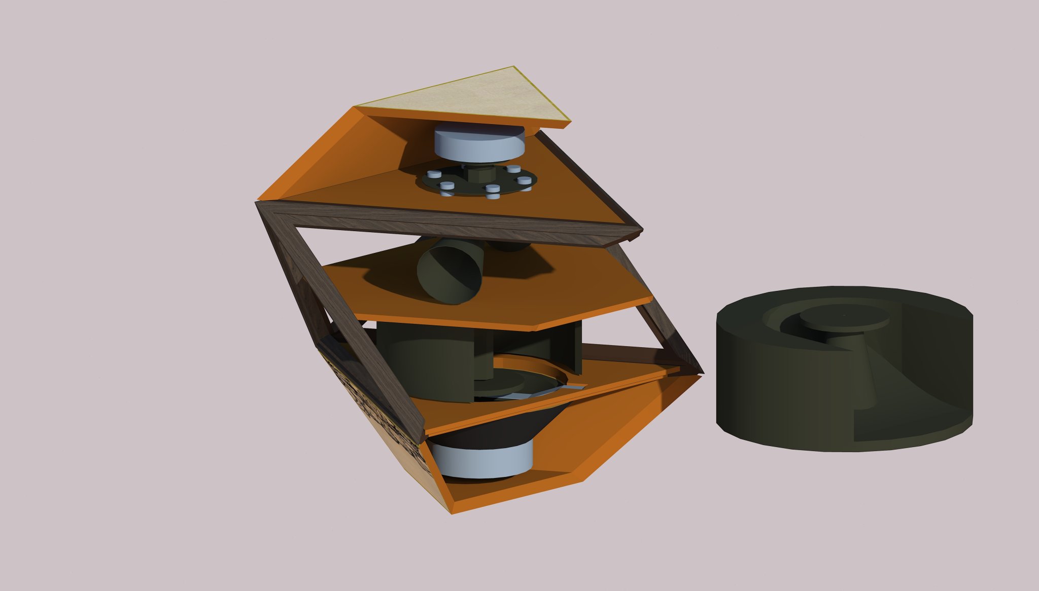

Firstly, I managed to model Dürer’s solid based on the theory I found most fascinating: Chris Jones’. This guy is absolutely brilliant—he analyzed the perspective down to the pixel using a Python program to determine the geometric proportions of the solid. I built the solid using his formulas. The result is fantastic because the piece is slightly asymmetrical, which I find incredible!
Here’s his study for those interested: https://chrisjones.id.au/Melencolia/index.html.
3D Modeling
The solid is divided into three tiers. The top and bottom will be plywood panels veneered in white ebony.
The edges will have rabbets to inlay brass strips. Some of these will have open joints, particularly between the openwork panels and the frame, as well as between the three tiers.
The central black frame will be made from bog oak.
The openwork panels will be plywood veneered in maple (with a fern-like pattern). The designs will be laser-cut and engraved. These panels will be magnetized into a rabbet in the solid frame.

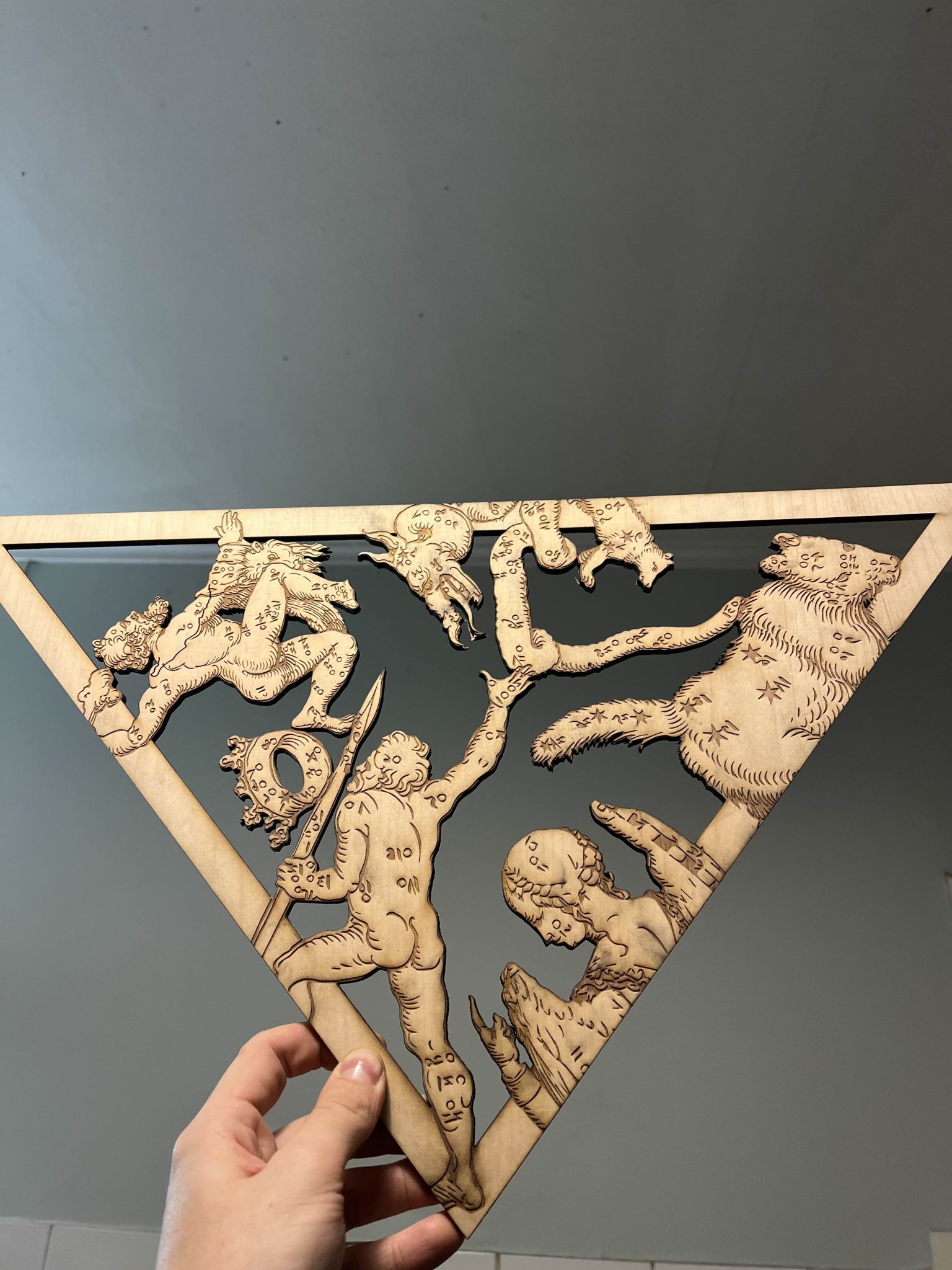

Panel Testing
Here’s an initial test. Each panel will have a unique engraving. The openwork panels (which will allow sound to pass through) will display a star map of constellations drawn by Albrecht Dürer around 1515. These constellations will be positioned to represent a specific date: the fall of the Ensisheim meteorite on November 7, 1492 (which is also depicted in the background of the Melencolia I engraving where Dürer’s solid appears).
In a way, my solid will feature both a northern and southern hemisphere with cardinal points, symbolizing the meteorite itself, since the sky at the moment of the crash will be "printed" on it.

I also took the time to model the parts I plan to reuse (horns, baffles, and pulley system).
Leslie 3D Modeling
Now the first space issues are becoming apparent... The lower baffle is too large for the dimensions I’m aiming for. I can’t enlarge Dürer’s solid for aesthetic reasons (it’s already 625 mm wide). For this baffle, I have two options: either cut down the one I salvaged or make a new one out of wood using a CNC machine.

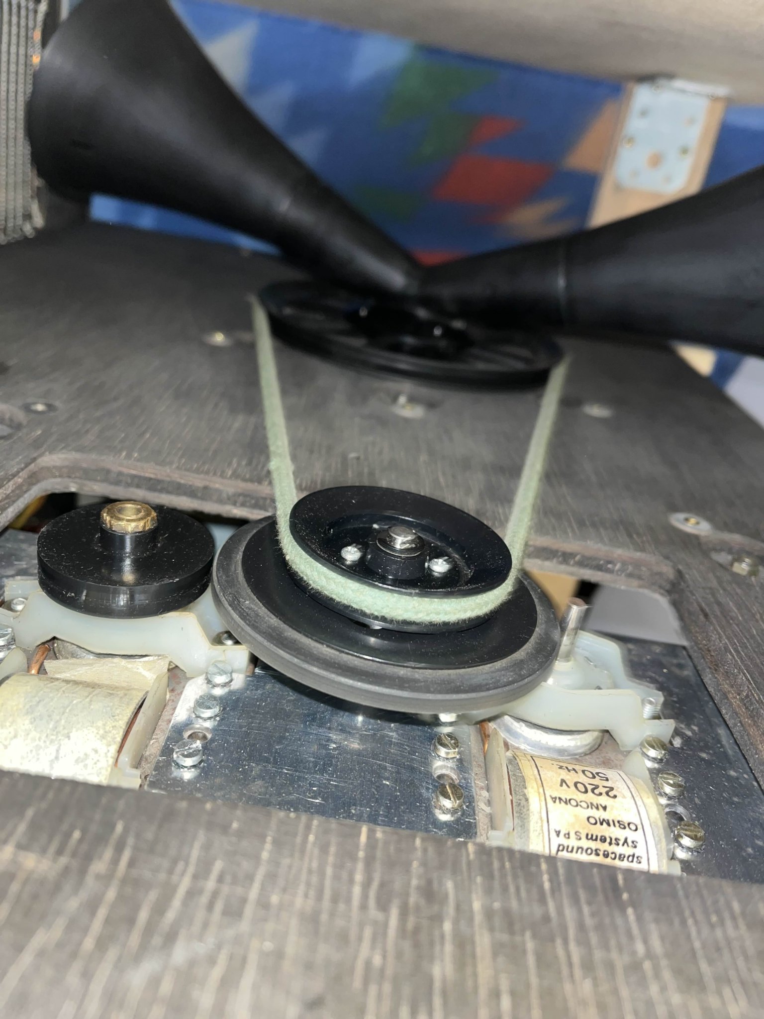

Next, I’ll work on defining the motors I’ll use to replace the HUGE original blocks.
MacSound Duo de Luxe Motor
Here you can see that each rotating system (treble and bass, in this case the treble horns) actually has two motors: one fast and one slow (to achieve the two Leslie cabinet speeds).
My plan is to remove all of this for space reasons and only have two motors in total (one for treble and one for bass). I’ve looked into some DIY projects, and many use DC motors (as mikessi said), but I’m unsure about the best option. It just needs to be quiet and have good torque (DC, servo, brushless?).
To control them, I’m thinking of using an Arduino or a simple circuit to adjust the voltage. Since the baffle and horns rotate at different speeds, I imagine the Arduino would be more versatile and compact.
