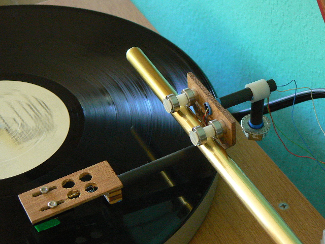

Thank you, Colin. But I think it is a big difference.
I've been pouring thru the other thread but haven't come across numbers yet. Anyhow if a cart is mounted at 13mm+/_ . Cantus appears 30mm+/_, at double width. And yours at triple the width. Yours in the horz. would be more stable but, would this come into play or not. At first thought, I wouldn't believe so. But on warped records with all the hem and haw...

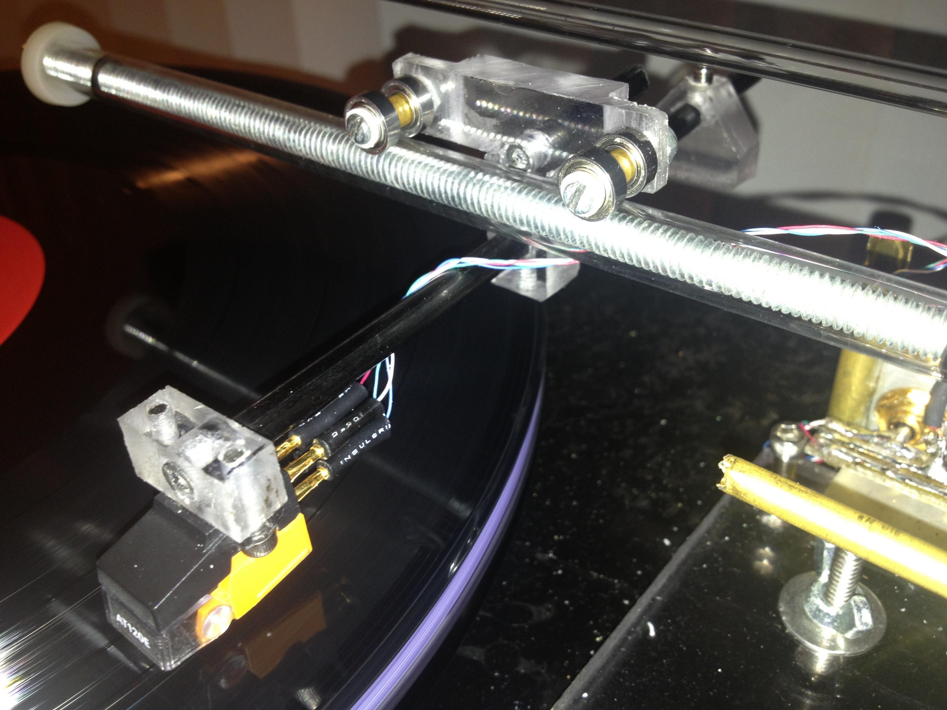

Another carriage.
Here we go, another carriage idea,no epoxy used!. This one uses a set screw to secure the arm wand and allows adjustable azimuth. Even simpler to build!.

There is a set screw at the bottom to secure azimuth. Also the counterweight is mounted on the single tube wand, funny as hanging all the mass below the bearings seems to allow more mass without affecting the cantilever. Sound?, so far with headphones it has taken another series of steps up, quiet surfaces, dynamic contrast and lucidity seems to have an edge ovr the two wands. I have used .220" carbon fiber tube here. I do love the look of the Clearaudio arms!.

RollE2K,
Thank you, not sure of the total mass at this point but must be atleast 25g based on prior knowledge. The increased polycarbonate mass that holds the bearings and wand seems to be of benefit. Perhaps of benefit too is the partial decoupling of the wand with a set screw, but the azimuth adjustment and ability to interchange wands is a plus, after all its about rigidity and the single thicker tube is as rigid as the two tubes, but much easier to build. I've also moved the bearings from 43.75mm to a 39-40mm spacing.
Colin
Will two intentionally undersized U-grooved bearing work, instead four flat bearings? Two undersized U-grooved bearings on a rod will represent as four contact points just like Colin's arm but reduces mass and less ball chattering perhaps?
