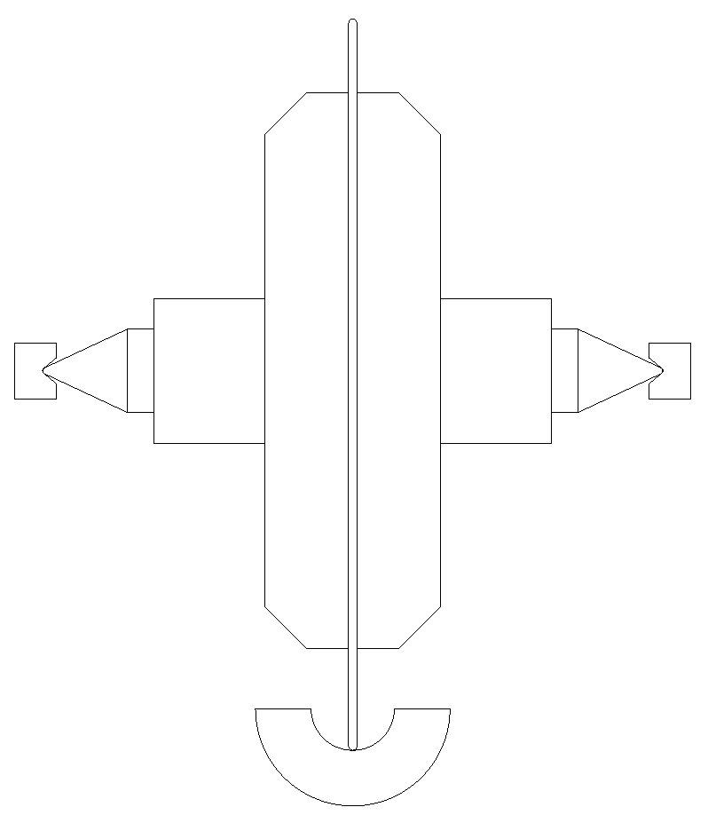

The drawing of the "Olfa rotary cutter" solution is for now just a scetch to describe the idea.
If built as in the drawing the whole thing would weigh in at ~8,2g using a 70/75 aluminum
alloy for the supporting structure. It schould be possible to reduce that to maybe 2/3.
The outside diameter of the cutter is not changed from 28mm (smalest size available).
Pivot 1,5g
Pivot holding section 0,9g
Larger diameter section 4,8g
Cutter 1,3g
Edit: Apparently there are 18mm cutters as well.

Maybe the Vee could be replaced by very small diameter Tungsten carbid rods. That would be easier.
To the left there is a 3,1mm drill that's ment to do the hole for the pivots. They
seem to be 3,15mm (to the right). Does anyone have the experience if I should
even try to pressfit that ? A combination of heat/freeze and pressfit maybe 😕

The points in the OLFA Rotary Circle Cutter might come in handy also.
What points, do you mean the lines ?
If talking about tungsteen carbide tips used with jewel vees, why not to consider using spherical diamond stylus, taken from phono cartridge? It seems to be even better... As well, as inexpensive.
A bit on the small side, you might do better with '78' styli, even sapphire ones might be good enough as long as they're suitably round. Not sure about the angle though.

So here is another idea. An "Olfa rotary cutter blade" gets a radius instead of a sharp edge and a supporting structure. The blade is 0,3mm thick and has a diameter of 28mm and is made from tungsten. Comments anyone 🙂
TC is very hard and capable of machining high speed steel so the rail would need to be at least as hard as the wheel, requiring a TC rail. Maybe 2 blades spaced apart by a shim running on a single TC round rod.
Putting a radius on the blade will require diamond tooling.
So diamond tooling it is, same as with the tungsten drills/pivots 🙂
I'm not expecting the blades (with a radius) to make any damage to the 7075-6
aluminum, it's basically hard as steel. The trick would be to create a "V" with a
controled radius and to line up the "wheels"correctly.
You can actually cut the 7075-6 aluminum with a regular handheld router 😎
So at least, a 90 degre "V" is quite simple to create.
