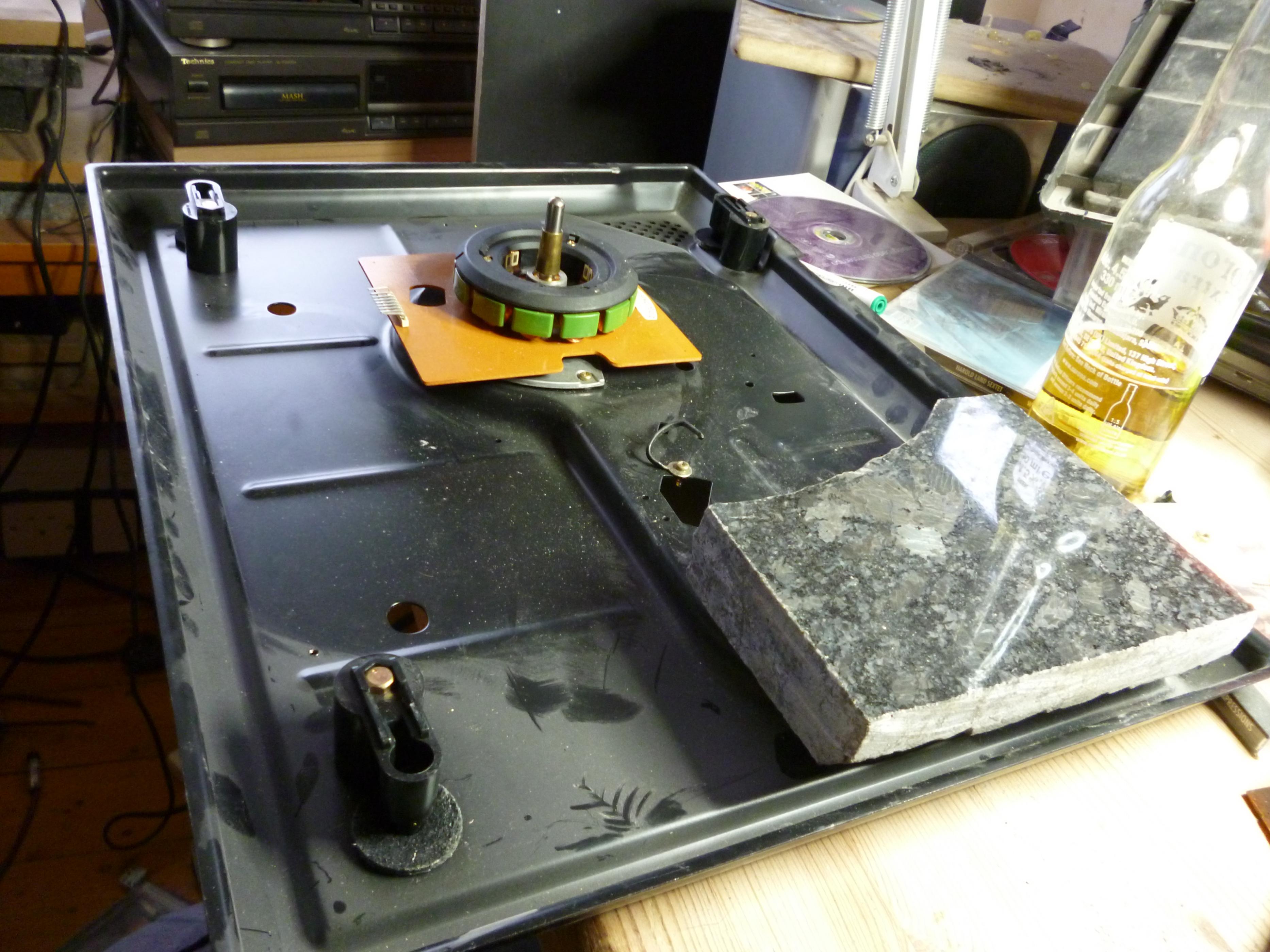

Bear has got me paranoid about the stylus picking up hum from incorrect mounting. So I have cut part of my top chassis away so I can attach a lump of granite as a base for the arm. This granite is attached using the original tone arm mountings so hopefully I now have a safe stable base for the arm.
Electricians who connect cables running under ground use a potting compound where they make joins. It seals out the elements. While the turntable is apart. Would it improve the table if I pour some of this dense potting compound into the bottom tray. Obviously keeping it away from the stator, the ventilation holes for the transformer and the suspension columns.
Sorry the question is sort of off topic, but I would not of done this unless I was fitting the arm
Oh, ur going to definitely *hate me*... but you could just take that motor assembly and CHUCK the rest of that "turntable" and build up ur own "plinth" (that's what you Brits call it?) and get a much better result.
I'd say anything that you can to to damp the path between that motor assembly (mounted to the sheet metal base now) and the rest of the world, the quieter the TT will be.
Having said all that, one of the things that folks who are going nuts over the old Garrard 301 seems to be the opposite, which is a strong coupling (or so it seems) in the upper midrange making it sound "alive".
My guess is that the potting compound would help... others may wish to comment too?
Fwiw, I was not talking about "hum" I was referring to acoustic coupling, which is related to acoustic feedback as well as effecting the tonal qualities of the playback. Much like the effects of the arm materials and what Colin referred to when he (and others) discussed the sonic effects of the bearings.
What I mentioned is that IF the original arm was mounted on a movable sub-chassis that this would be a problem for this arm type, which relies upon having a very solid mounting to maintain the geometry and tracking. The solid mounting, however MAY be decoupled or coupled from/to the rest of the turntable. So, that granite chunk could be put on epoxy to the base, or mounted via a large surface area of appropriately high density rubber (for example), etc...
_-_-bear

Lol, no I don't hate, thanks for giving me your time and opinions.
I think your right about redesigning the turn table. Ever heard the phrase "one job makes two" ? It so happens I do have a fair amount of granite off cuts lying around. So it can be done.
I will for the time being though, just get an arm going on my original idea. As I am ultimately going to abandon this plinth , it would be a waste of my potting compound. I will remove the suspension legs and use your sand box idea

... one could mount the motor and switch assembly on suitable chunk of material, call it chunk A. Then mount the arm assembly (suitably built to size and fit) on material (could be different material), call it chunk B.
Now place chunk A and chunk B on top of ur sand.
Simple and effective.
_-_-
PS check the load carrying ability of the motor+platter by adding on some mass and seeing if it comes up to speed
and runs on speed ok... too much mass will make it not run properly or need the speed controls turned too far to keep
it on speed. But within reason you *may* wish to carefully fill/coat the bottom of the existing platter with some of that
damping compound - just be careful to keep the amounts in each section (presuming a casting with ribs) as close to equal
in weight/volume as you can.

I just been walking the dog thinking about the very same thing! I will hold fire for a minute and just get the arm up and running and have a little play around with it. It will all count as a practice run and some experience for doing your idea. Besides It won't cost any more money to change to the granite idea and its nice to do upgrades little by little because you can savour the changes and see the magnitude of change of your modification....I am really hoping this arm comes up with the goods.

A good turntable is a great thing, however this arm seems to perform well even on a Sansui sr222 budget oldie . I think you will find built well that this arm will deliver the goods and then some, it will dig up surprising amounts of information from the grooves .
