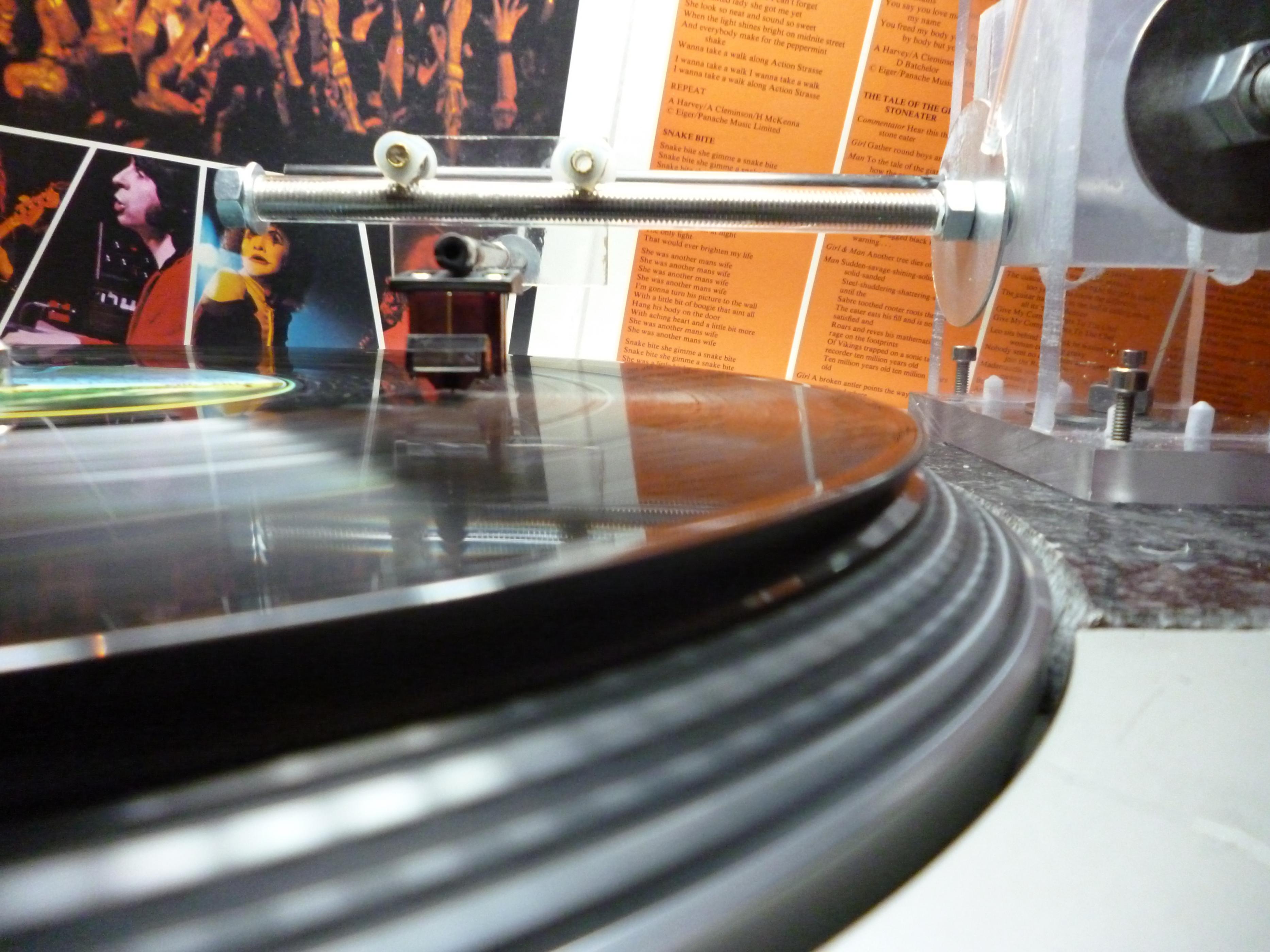

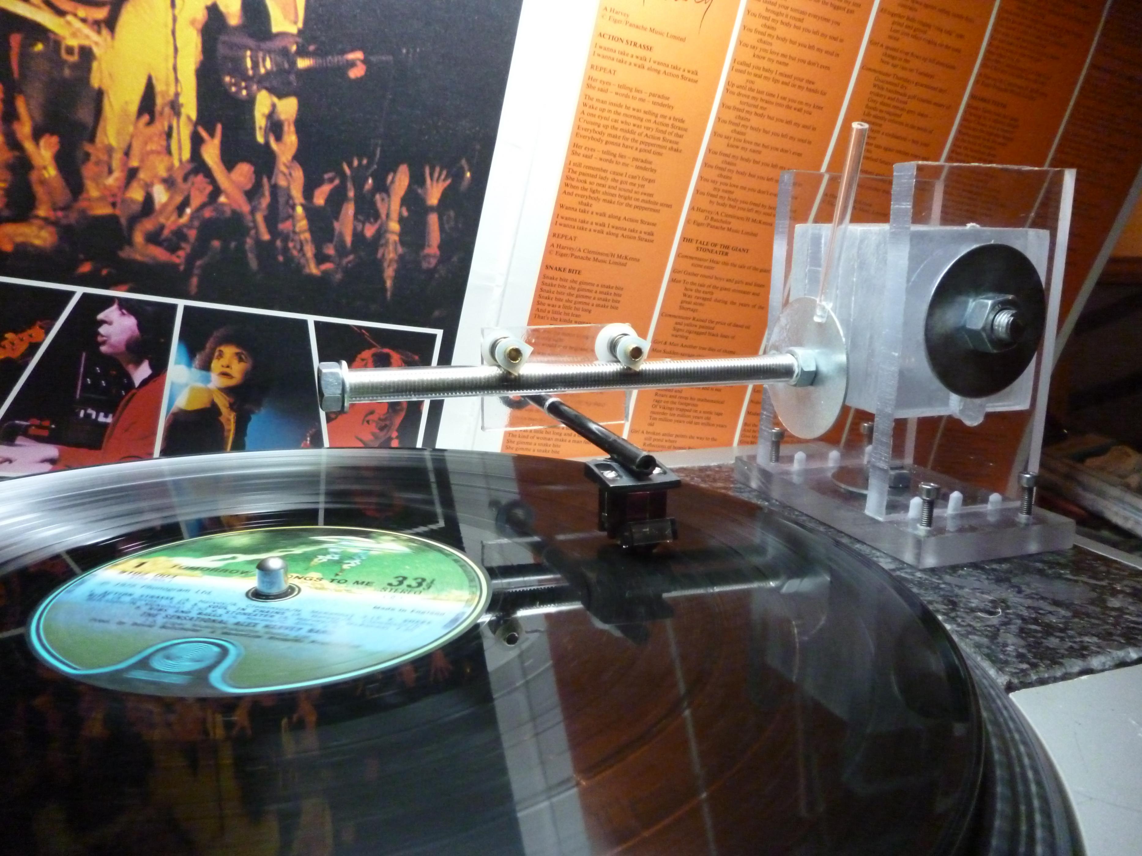

I am up an running. I have no way of measuring the tracking force. I have tried moving the counter weight about . The carriage will not advance along the tube. Tried trumpet valve oil. Will it be the cartridge alignment?????Any ideas

Hello chokesrule
Did you used that oil because it has to do with music? Just kidding.
Are the ball bearings shielded? If they are, they are most likely greased.
Look at Clear Audio's linear tone arms. They use open bearings.
The tone arm I built in 2012 would not work at first until I removed the grease from the bearings. I couldn't afford to buy new bearings so I soaked them in a circuit board cleaner in a sealed glass vial. Once the grease was removed, The tone arm worked just fine.
I would never lubricate bearings in this type of application.

I think your right...It seems to be working but its taken a lot of work to clean away the grease. I got to get the cable next and tidy the counter weight and get some scales .
