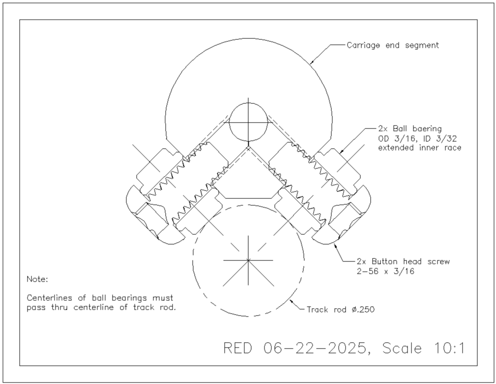

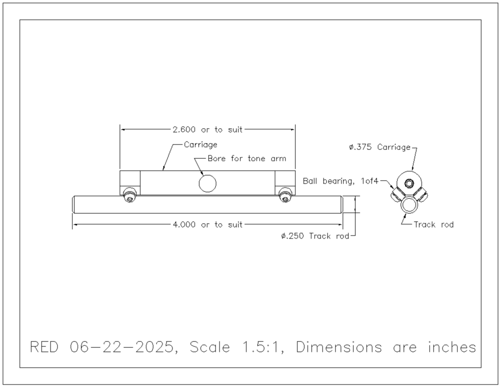

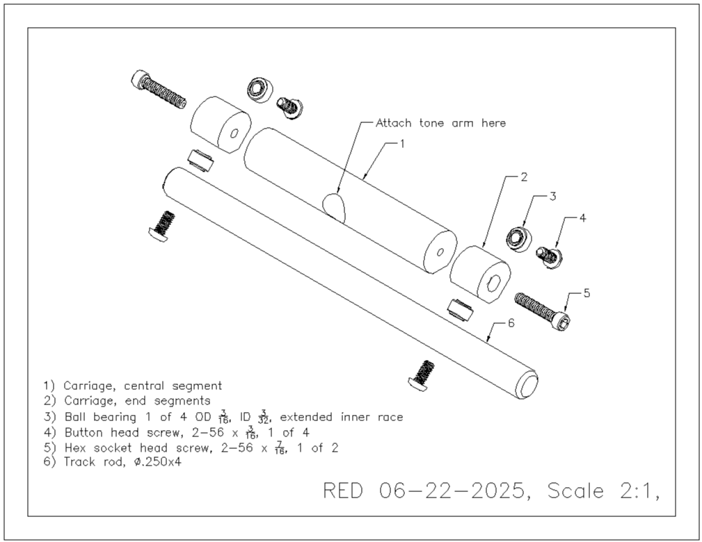

Hello Paul,
As promised, I found my design of a theoretical linear tone arm carriage. I made up some PNGs for you to look at.
If you don't use the ideas, I won't be offended. If you are going to use my ideas, feel free to make changes. The carriage could be made as a single component, and its cross section could be square rather than cylindrical. The bores in the ball bearings are .09375" in diameter but the screws are .086" in diameter, requiring a shim liner to make up the difference. You could use metric bearings and screws because it would be easier to get matching diameters.
If someone designed a similar carriage in the past, my apologies,

The track rod is only 4" long? I would think it would need to be at least 8" (4" of grooves + 2" on each side for the carriage). What have you found to work best for the bearings? Dry / lubricated, sealed / open, ceramic or metal?

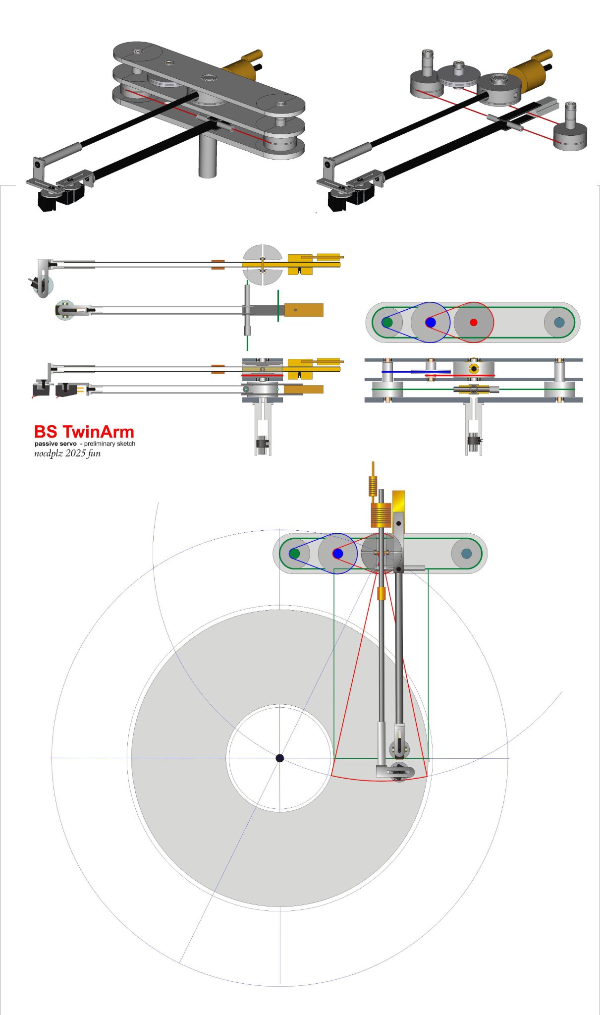

TwinArm - a passive servo linear
from #5480 to #5504 post ...... I will let you know.
This is the point where I could, and wanted to get to. It's just a sketch of a possible mechanical solution, not an executive drawing, and even less a working Tonearm, although examined at my best.
Good work everyone - carlo
A wonderful visualisation Carlo, a lateral arm with good orientation without side loads, what's not to like?

Hello Paul,The track rod is only 4" long?
You disappoint me. Look at my drawings again.
I would use precision stainless steel bearings, shielded and NOT lubricated. I soak mine in acetone to wash the lubricant out of them.
Ceramic bearings seem to be the fair-haired boy these days, but I don't think they are necessary considering that, the bearings in a linear tone arm don't even rotate at 1RPM.
Ralf
Ralf, your work is clearly awesome, and worthy of respect. I see the scale to your drawings. I am familiar with the dimensions indicated being full scale, is that not the case? - otherwise, i am puzzled like Paul?

Helo Mike56,i am puzzled like Paul?
The length of the track rod is 4" or to suit.
