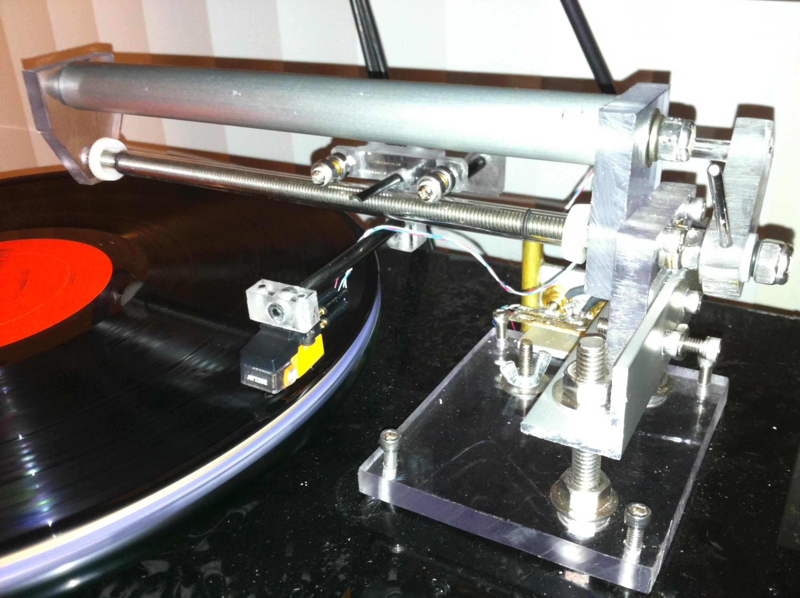

I've been exploring the possibility of using a single pair of concave bearings on a solid glass rod. Planning to try this out on my ROK table as soon as the re-plinth is completed. I'm also planning to try the cantus style inside the tube too. My main reason to try the bicycle bearing arrangement on the single glass tube is that I want to keep the pivot level with the platter, and still keep the arm as short ( and light ) as possible....

Ever considered using U grooved bearings on a single radius surface? Would give you 4 bearing points with two bearings.

I agree, and thought aloud about this earlier. Might I also add, it's hard enough to align two wheels to ride completely straight and true. Many planes of action to be accounted for. Let alone four. None of these I assume are milled, nor with any precision. There is also a relying of slip motion in the four bearing to align itself.

Four bearings aren't hard to align, especially considering the way I have configured it see prior thread. The easiest way to the proof is to build it, I have offered a free idea to an exceptional performer, and this is my first real foray into the analog pickup front end and the proof is in the pudding, just build it as it is cheap with nothing to lose

I did wonder myself about the dimensional accuracy of glass tubes.
Here's a suggestion - computer printers contain steel rods for the printhead to slide on that are both round and straight to pretty decent tolerances. I scrounge dead printers just to break them up for those rods. The printheads also contain what I think are oilite bearings sized very closely to the rods.

a solid ground and polished tungsten carbide rod. I bought a 1/2" diameter tungsten carbide rod 12" long off ebay for $70.

I only mentioned the use of carbide rod for the qualities needed for this project which are;
1 near perfect in dimension + or -.0005 in of a specified size
2 super hard with micro inch finish
3 can be had in all metric and English sizes
4 guarantees a smooth and consistent ride for the carriage for the entire length
These traits eliminate the need for any further thoughts or questions about the carriage support and allows folks to concentrate on bearings, carriage design etc.
We all know that records are far from perfect, however using a near " perfect" support " may " help the cartridge track the grooves better. I am only trying to cut out one variable.

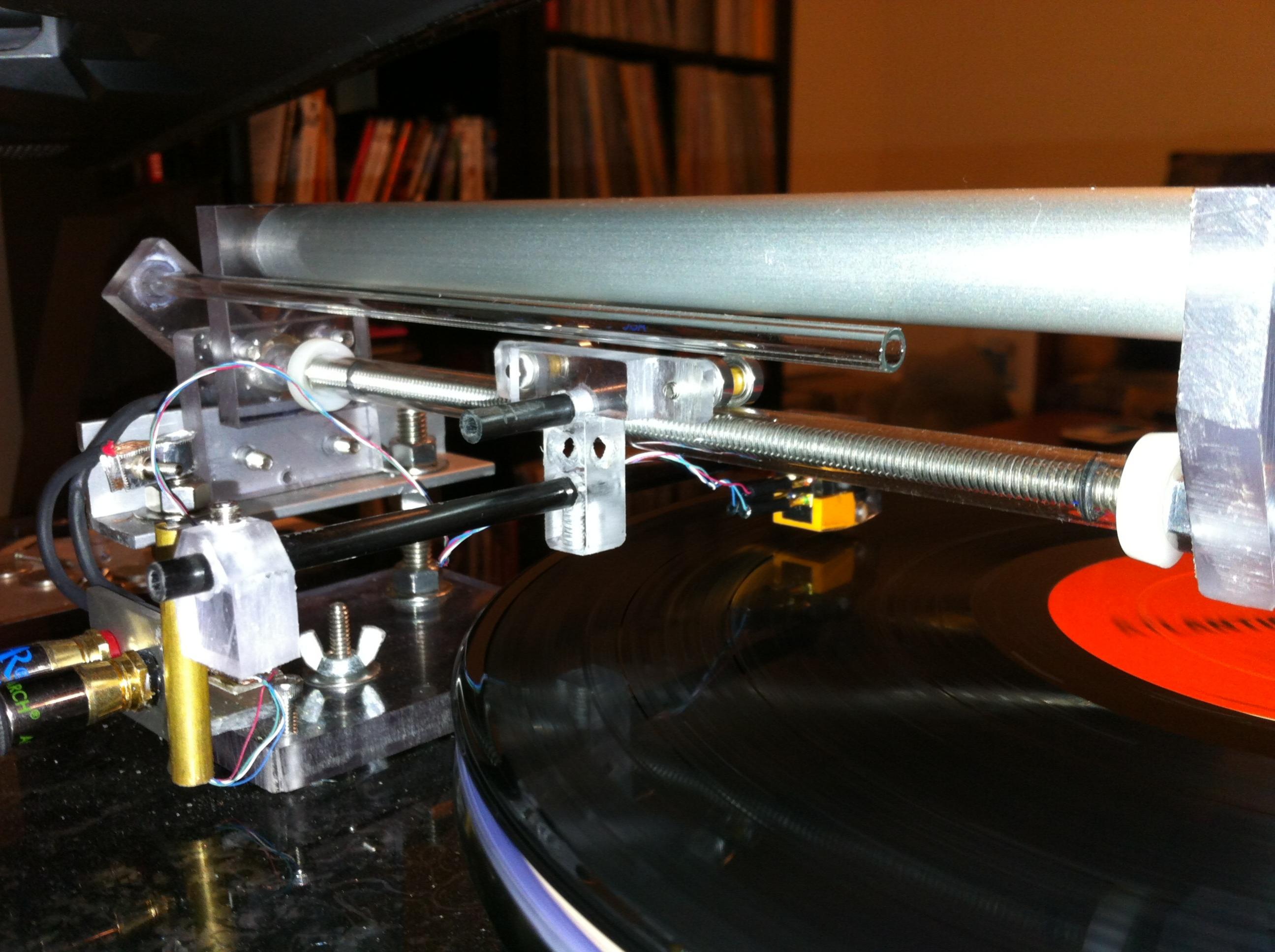

Some observations about some of the glass rods/ceramic tubes /precision dom aluminum tubing I have on hand.
1. Boiler site glass tubing ( 3 samples ) does not roll well at all on a surface plate. A dial indicator shows run out of .012 !!!! inches in certain spots and varied along the length of the tube. This tubing has no need to be precise for its intended use.
2 solid ceramic sharpening stick 1/2" diameter. Again, will not roll well on surface plate. Bad run out.
3. Precision dom aluminum tubing. This was the best with .002 to .004 run out. However this to soft for this tonearm application.
4. 1/2" ground carbide rod. Near perfect, I could not measure any run out and rolled perfectly on the surface plate.
A tip to those using glass/ceramic tubes. Obtain several pieces if possible and roll them on a mirror by tilting one side up and pick the one that rolls most freely and with least amount of imperfection.
Let me say one more time. My post here is not to discourage anyone from making this tonearm, as a matter of fact the opposite is true. For those people on a tight budget use what you have and do your best to make it work. For those who want to make a great tonearm and can spend a little more money, go for the best possible parts possible as it will not cost much more. With good workmanship and good parts I feel you can rival the performance of tonearms that cost $$$$$$$$$.
My gut tells that the easier and more precise ride the carriage has the longer the suspension in the cartridge will last. Just a feeling.

Anyway, I was thinking about Joe's post and his testing on a mirror and the run-out measurements.
My thought was that minor diameter imperfections are not that a big deal since on glass the diameter changes should be smooth and rather gradual, so they would not affect the rolling power of the light carriage significantly.
I m thinking that the bearing's outer perfection is much more significant.
One other thing that came to me while I was writing this, is that bigger bearing diameter should also reduce the significance of rod imperfections. Like in cars. Bigger cars with large wheels are less sensitive to road bumps than let s say a small fiat with 13" wheels... I do not know how this might affect the friction inside it, but this should be quite calculated in its design. the extra weight... I don t know...
