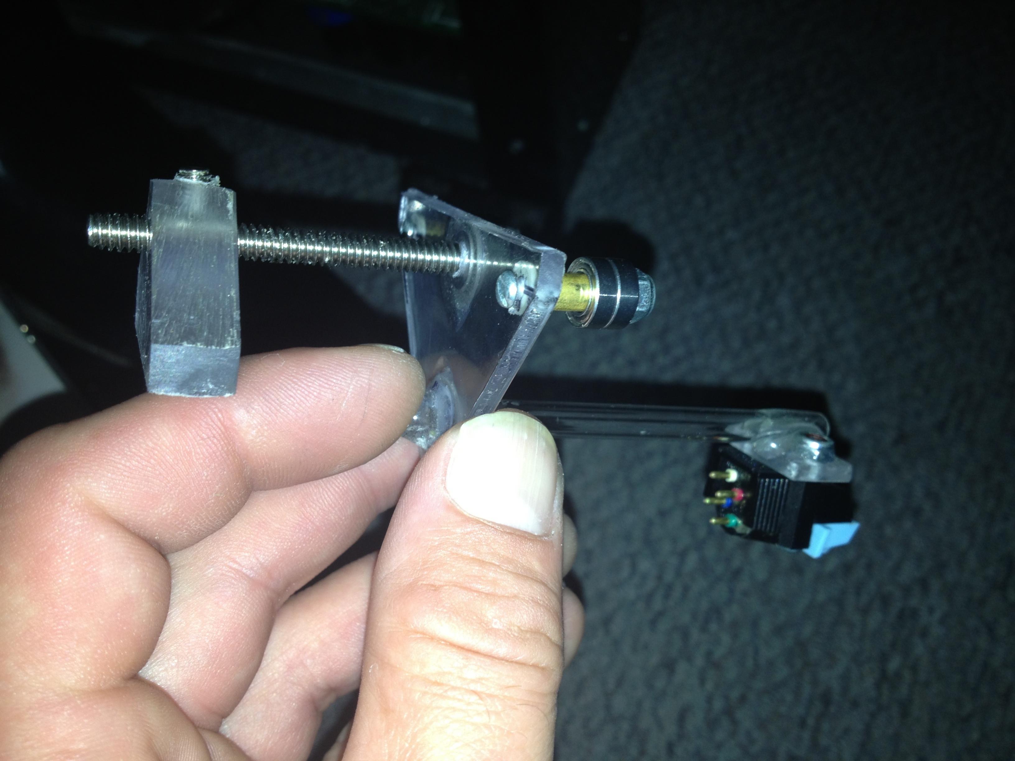

I've looked into ceramic bearing assembly's, there may be a small gain in this case, but from what I've been told by some local bearing companies any gain may be small for the expense vs steel bearings, but the way I've used the bearings also keeps friction low since they roll free on a brass shim.

I've been following this discussion with great interest. Very good work on your part. I don't fully understand what you have done with the bearings and the brass shim. I can see that a brass sleeve provides a spacer between the back and front bearings of each pair. But do you have a portion of the spacer reduced in diameter so that the inner race of the bearing is free to rotate on the brass in the manner of a sleeve bearing? For this to provide any reduced friction over the already very low friction of the ball bearings would require precision machining and surface finish such that the sleeve bearing would have to be free enough that it would take over from the ball bearing if that bearing had tight spots in its rotation. Sorry, but I just don't get what you are up to here. Please explain?

The bearing arrangement is only kept apart by the round of the tube. The shim/sleeve is just slightly smaller than the 5mm bearing center and is made from brass tubing from a hobby shop and also acts as a spacer. I have used a to220 nylon insulating washer to center this sleeve and space the bearing from the polycarbonate piece. It all works together in this arrangement and helps reduce friction, it's also not machined as my goal was to see if I could do this from basic materials

Also I realized, to further answer your question about skips. It tracks flawlessly unless something is embedded in the groove which shouldn't be an issue for clean vinyl, even well worn vinyl will track well as long as nothing is jammed in the grooves
. I can play a record and shake the turntable while its playing and it won't skip, try that with a pivoted arm!!.

I've never heard such transparency with vinyl as I have with this arm, all with a 100 dollar mm too !. I'm thinking it must be mass related, a pivoted arms mass is much higher and will trudge through anything but sensitive to any tt movement. Might be a good thing that a something wedged in the groove Will make it jump to the next groove?, which a quick brush before playing a record should resolve

Minor correction please. The problem is that the LT arm doesn't jump to the next groove. It sits there playing the same groove over and over.
The pivoted arm plays right through the whatever, junk in the groove, damaged groove etc..
I hung a couple pieces of solder, about 6 grams total, right below the bearings. This cleaned up virtually all the minor clicks and pops. The major ones that cause repeating the groove are still causing trouble. I haven't heard any degradation of the sound though. Mind you, I re-balance the arm for the same stylus pressure for each modification.
