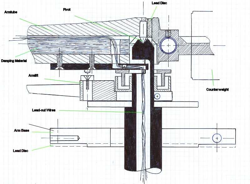

Hi ... new guy stumbles in with case for 165mm arm.
A neat law will help performance. Moment of inertia is important to keep things in balance, not mechanical balance. A quick reed (I know, not funny) is in order. reed.lt - Tonearm moment of inertia
A simplified equation is scrolling at top.
A good explanation of Moment of Inertia envelope can be found here:
Audiomeca Septum & Belladonna - [English]
A pic of tonearm cross section is shown. You will notice everything is in line; stylus, arm, pivot point (a touch high for stability) and counterweight. Counterweight is as short as possible with a lead isolation pad. So Moment of Inertia says quit hanging the counterweight way out in space. It's not a teeter totter. It's based on dynamics, not statics. Big difference.
Yes, this means the tonearm will be above the bearings not below. Once you put this all together you will see the bearing points will have to be outside the record. Not so bad as now you can properly support each end of the tube/blade. So shorter is not always better and the geometry typically used here just is not optimum.
Arm material is of equal value. Most of us get this wrong as we copy the manufacturers instead of science. Some get it right and others just "sell pretty" or cheap. This site is hard to get around, but well worth the effort.
Notice where our beloved Aluminum places? damping factor values : damping factor values
You didn't think you could escape Romy did you? Well here he is in his normal jolly mode. GoodSoundClub - Romy the Cat's Audio Site - Say ?no? to the light tonearms.
This helps break the "how to calculate compliance formulas".
Scramble on. Zene

This is all for a pivot arm, and holds no credence here.

Golana and others. Please read my 165mm arm post again and you will see it is NOT a pivot.
It's a true tangent. The references to the engineering of pivots is only to support my ideas.
I wish I had the ability to CAD one out so you could see. Picture one of the air bearing sleds, but with a tube and bearings just like like the Cantus.
Zene
