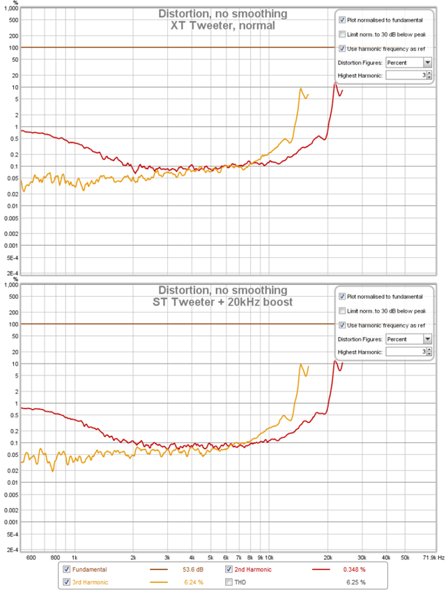

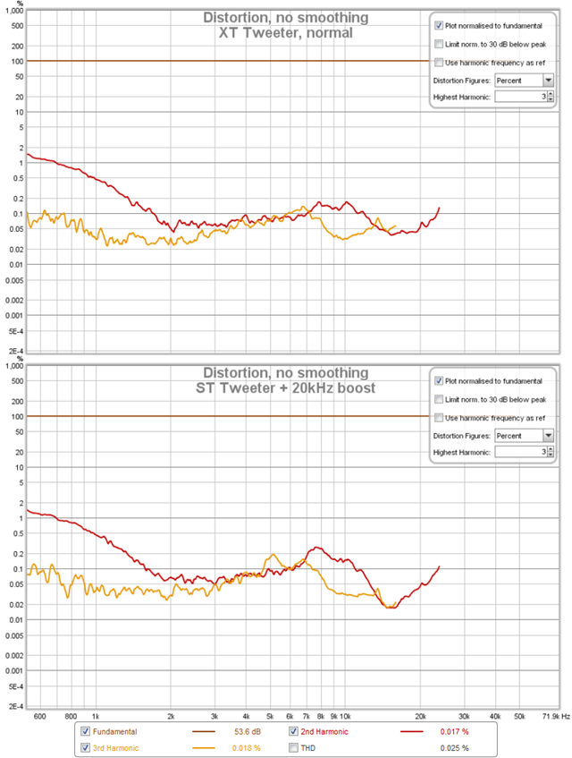

… distortion results are now more relevant. 2nd harmonic shows a peak of ~0.2% at 1.2 KHz, 0.6% at 310 Hz, and 1.24% at the 150 Hz crossover frequency I've been using. Looks like I should move that crossover up a bit to rely more on the woofer array at 150 Hz. No sign of a distortion peak at the 2.5 KHz kink in the magnitude response.
Congrats on persevering and getting your planar line sources up and running.

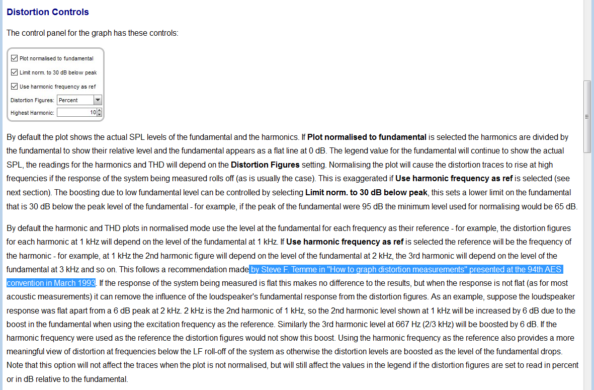

For best accuracy when measuring distortion with the swept sine method, you need to adjust the microphone preamp gain and/or soundcard input gain such that your signal peaks within 6dB of full scale. Not sure if you have zoomed in and looked at the “pre-impulses” generated for each of the harmonics…they are really tiny compared to the fundamental impulse. You need all the headroom you can get. I have experienced distortion levels changing as much as 2 orders of magnitude when a watchful eye was not kept on the soundcard input level.
It is highly possible that the distortion peak at 1.2kHz is caused by the response behavior at 2.5kHz. REW actually has some control settings for normalizing the distortion curves relative to the response level at the stimulus frequency, or at the harmonic. I attached a snapshot of the relevant REW documentation. If anybody is interested in further ready on the topic, you can download copies of the Temme paper and B&K Appnote here:
http://www.pearl-hifi.com/06_Lit_Ar...pers/How_To_Graph_Distortion_Measurements.pdf
https://www.bksv.com/media/doc/BO0385.pdf

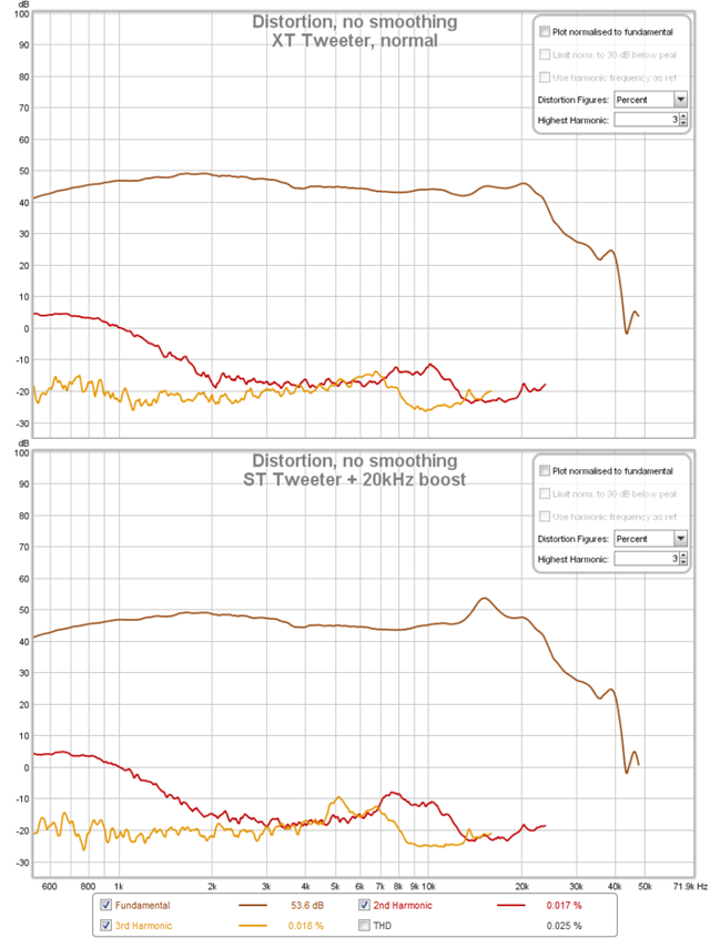

Actually, now that I think of it, I have a set of example measurements I took with an XT tweeter that may be of interested. I put them together to illustrate the differences between the 3 REW distortion plot options. Each attachment shows measured distortion with and without a 15kHz EQ peak inserted in the signal path.
Attachment #2 Plotting harmonic distortion without normalization allows you to see the fundamental response. You can also easily see peaks in the 2nd and 3rd harmonic at 7.5khz and 5 kHz respectively when 15kHz EQ boost is added. Note that there isn’t any accompanying distortion peak at 15khz since boosting at that high of a frequency doesn’t cause the voice coil to move outside its linear range.
Attachment #3 Normalizing relative to the stimulus frequency and you get harmonics plotted in % with fundamental at 100%. It still looks like there might be some distortion issues at 5kHz and 7.5kHz. Notice there is a dip in the distortion at 15kHz since you are normalizing relative to a boosted stimulus response.
Attachment #4 Normalizing relative to the harmonic frequency and the distortion profiles look virtually identical with or without the 15kHz EQ boost. This verifies that the distortion peaks at 5kHz and 7.5kHz are due to the non-flat frequency response at the harmonic frequency rather than some localized distortion mechanism.

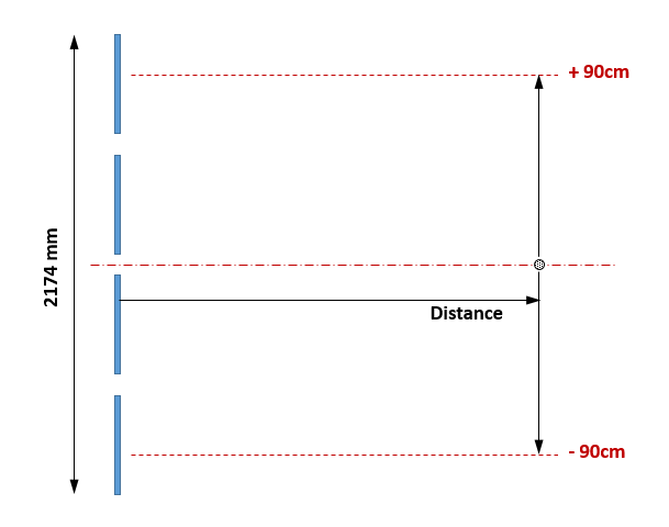

If you can tell me the width and height of the radiating area of your planars, and the height of the 3 gaps between the 4 radiating areas, I can run some vertical polar comparisons between a continuous radiator and your 4 spaced radiators at a few distances. My experience with ESLs is that they nearly exactly match the finite line source behavior documented in Vanderkooy's paper, AES E-Library The Acoustic Radiation of Line Sources of Finite Length. Depending on the size of the gaps relative to the height of the planars, there might be some added "wrinkles" in the response that shift with position and frequency.… I'm sure some of what I'm seeing is from reflections but I think some of it may be inherent in the summing of the signals from different parts of the speaker. On the one hand the diaphragms are continuous, on the other hand there are three gaps separating the four drivers. I'm wondering how much those gaps are complicating my results.
Oh, also meant to ask, for your measurements at stepped distances back in post #87, where exactly was the mic placed height-wise relative to the 4 planars?

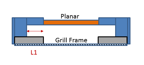

Nice job tracking down sources of the spurious reflections.I've tracked down the reflections, I think….The felt really cleaned up the 6.5 KHz junk. I was even able to reinstall the grills, front and back, without the old 2.5 KHz problem reappearing.
I’m not sure if the exact dimensions and layout of your rear grill frame, but if it is anything like the attached cross section view, it is possible the 2.5kHz issue is due to a 1/4Wave pipe resonance. For a 2.5kHz, L1 in the figure would be about 30mm when accounting for end effect of the “pipe”. Looking back at your measurements, the 2.5kHz feature always seemed to be a closely coupled peak/dip, which seems to jibe with response summation with a resonator which has a phase reversal going thru resonance.
Adding felt to the pipe cavity could damp it out nicely. Alternatively, when experiencing a similar grill frame related resonance on an ESL, I found that simply filling the cavity up with a piece of MDF solved the problem.

Bolserst, great to have you in on the discussion! Thanks for all the very helpful advice. I was not careful about input levels or even about knowing what the absolute SPL was when experimenting with the distortion measurements. I mostly wanted to make sure I knew how to get REW to provide them. Based on your explanation and examples, there's clearly more there than I realized so I'll read up, figure out how to do an absolute SPL calibration, and give it a more careful shot the next time I measure distortion. I should definitely check to see if my felt addition had any impact on the distortion above 1 KHz. I think of harmonic distortion as indicating nonlinearity and I'm not yet catching on to the idea that a reflection can lead to nonlinearity. More to learn, no doubt.
I've dimensioned a photo in the hope that it makes clear what's what. Let me know if anything needs some explanation. All dimensions are in mm. I'd be very interested to see what a model predicts. Is there anything Vanderkooy didn't publish on?!
I believe my stepping-back measurements were made with the mic centered on the second diaphragm, counting up from the bottom. Now that you ask, though, I don't think I made careful notes of that session. There's a slim chance the mic was from halfway up the tower.

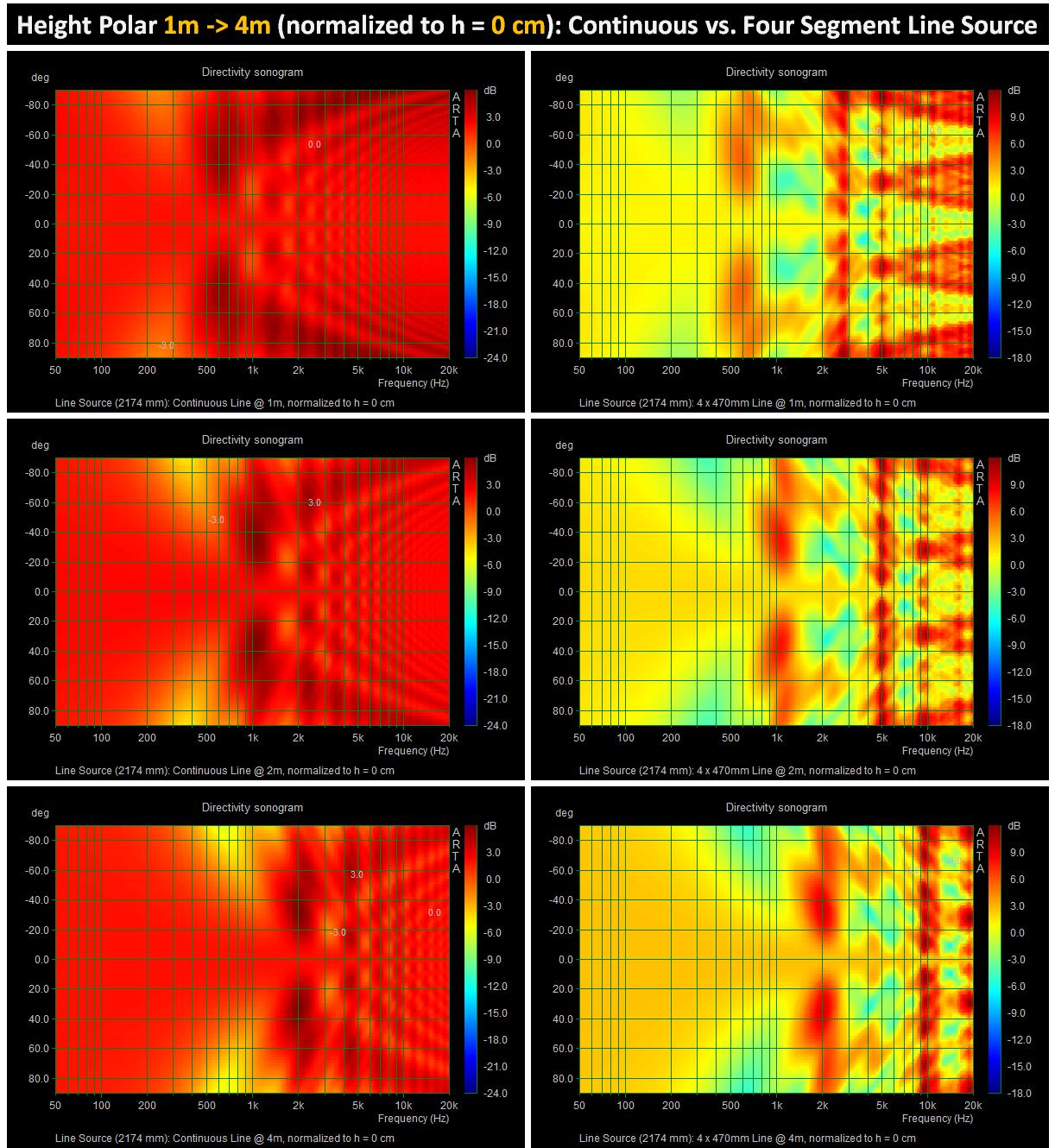

All dimensions are clear, however I forgot to ask for distance from bottom of lowest planar to the floor, and from top of highest planar to the ceiling. These would be needed if we want to add in mirror reflections to the calculations. For a first pass, I just ran the array of 4 planars with no floor or ceiling.I've dimensioned a photo in the hope that it makes clear what's what. Let me know if anything needs some explanation.

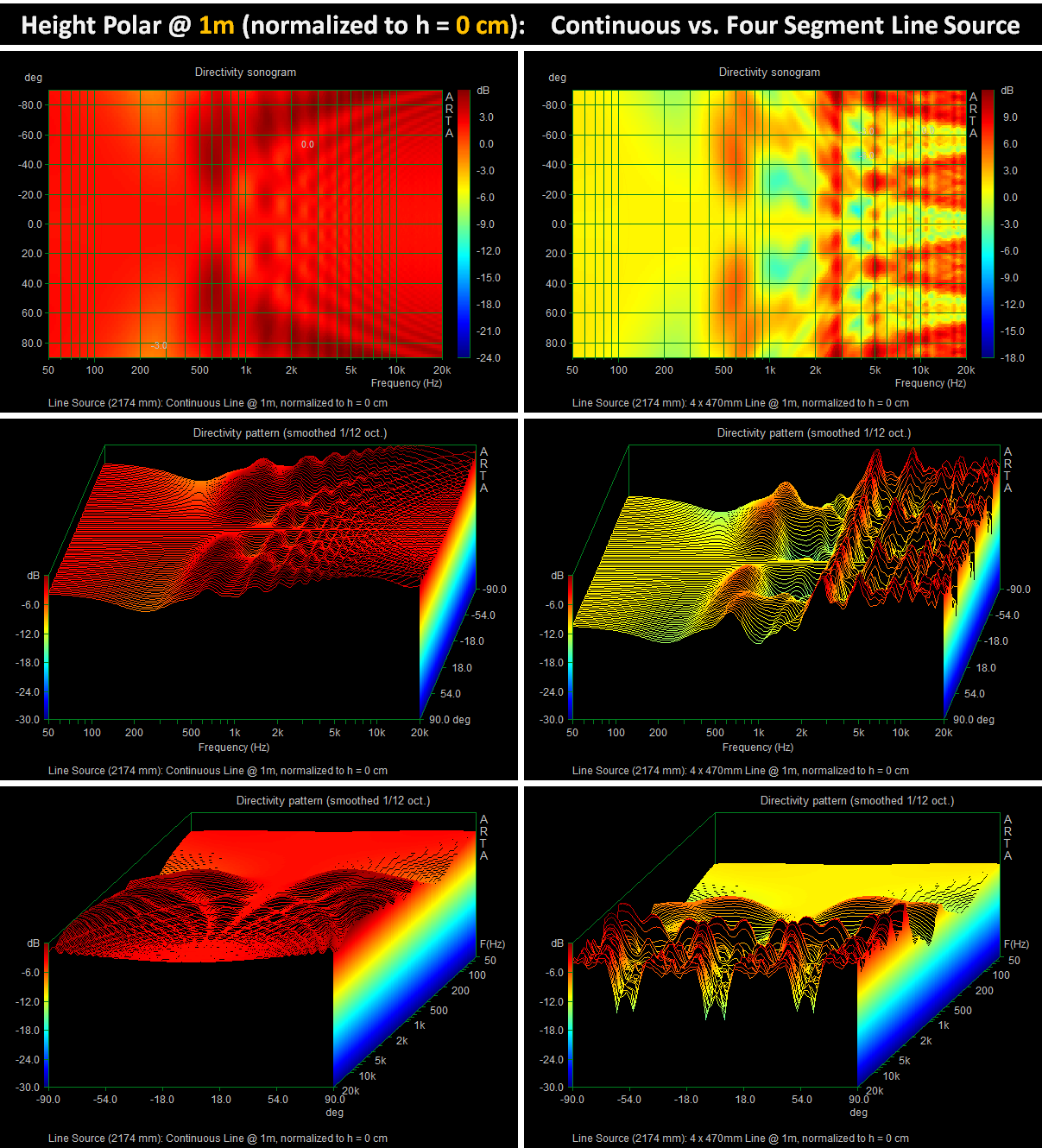

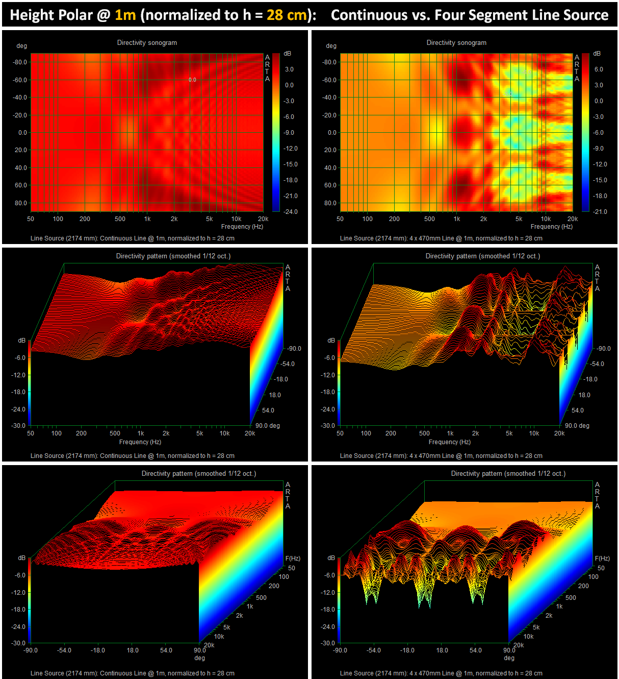

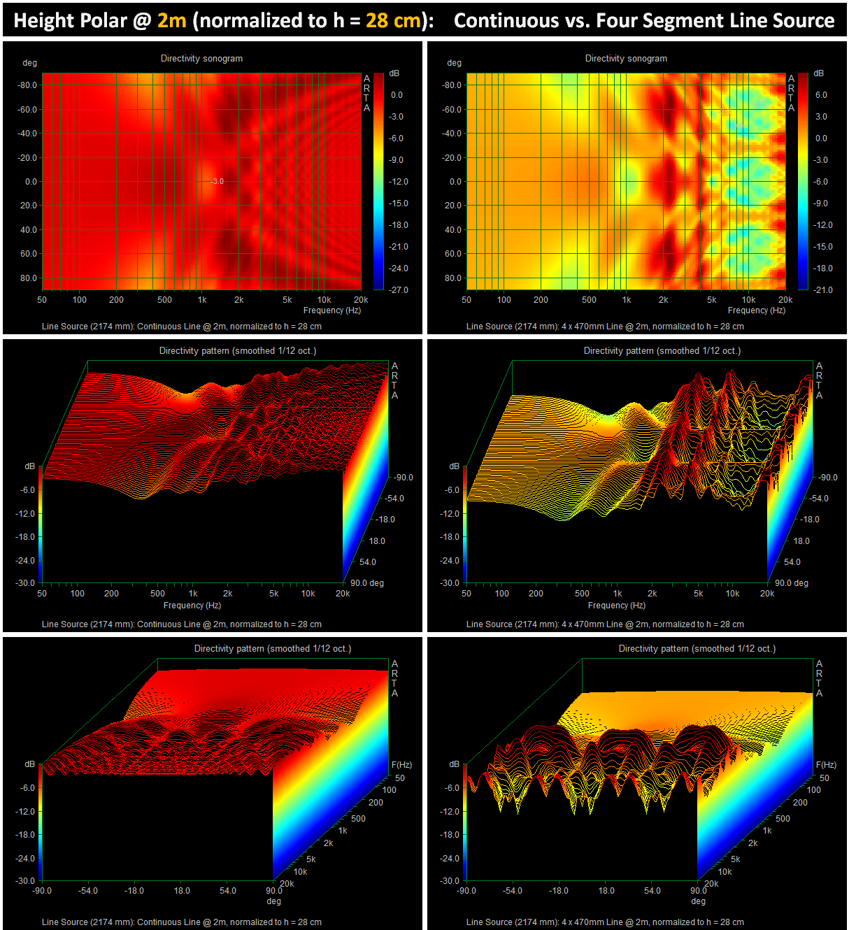

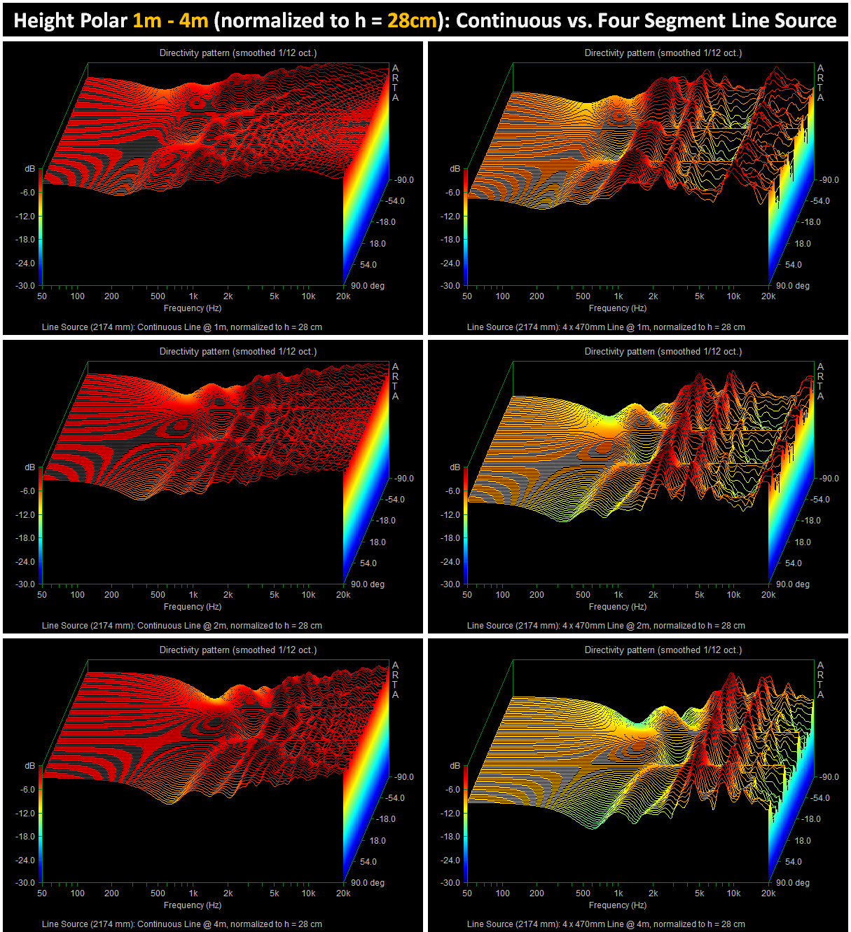

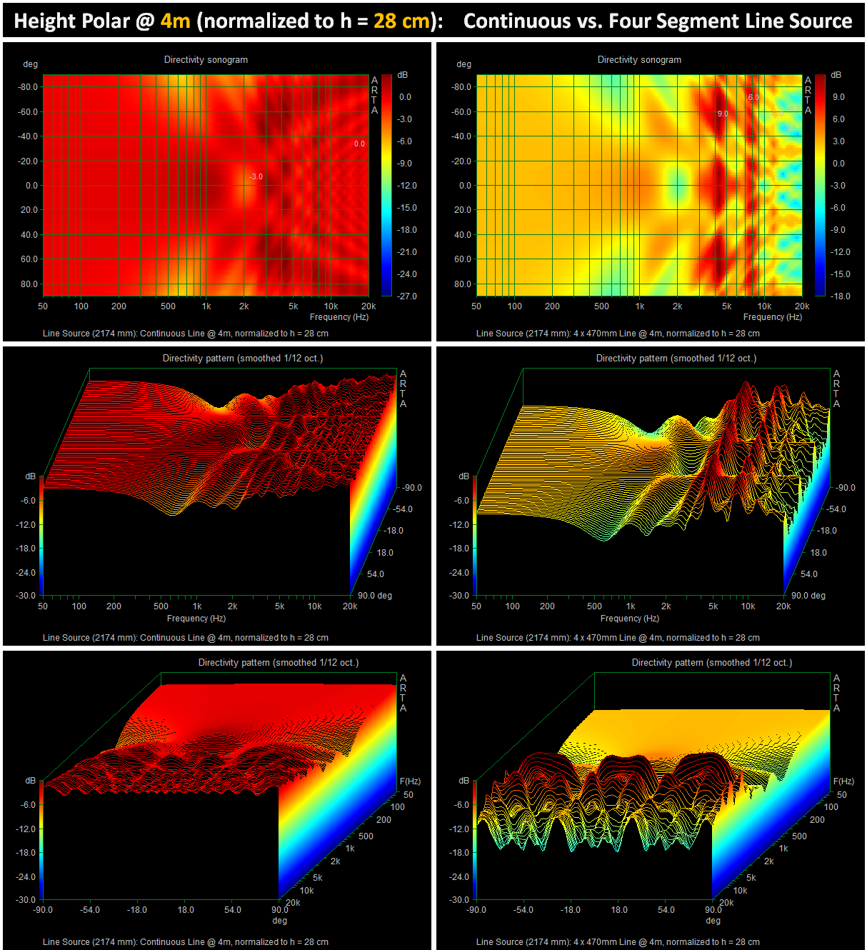

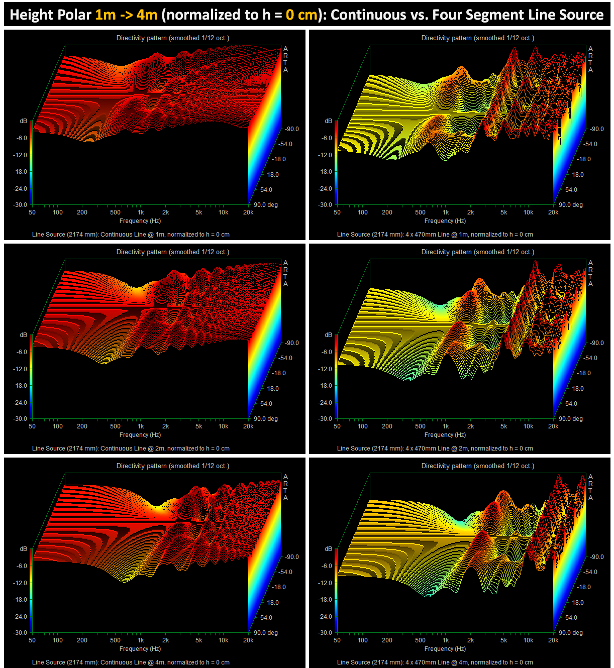

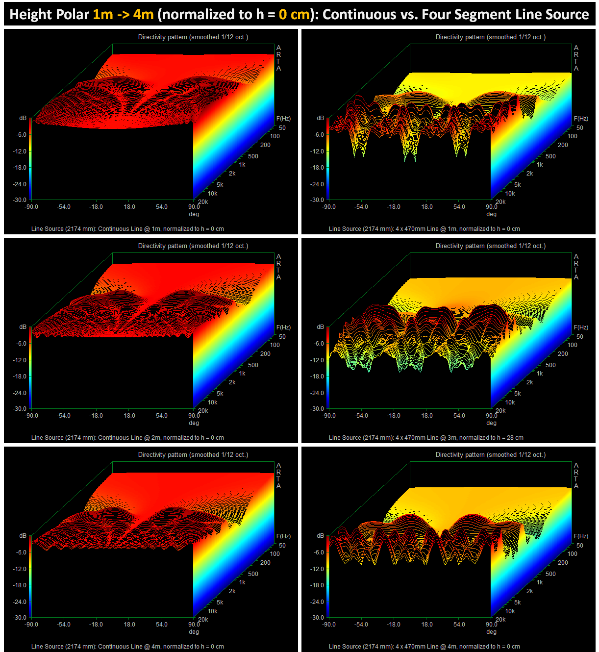

I wasn’t sure what type of visual you might like the best, so chose 3 that comparison on this first posting. Let me know what you like best and any additional plots can be trimmed down in size. My personal preference is the sonogram.
Attachment 1: Although the plots are labeled in degrees, the calculations were performed at a constant distance with height varying +/-90cm
Attachment 2 - 4: Height Polars @ 1m, 2m, & 4m with response normalized to h=0cm (ie center of array)
Attachment 5 - 7: Height Polars @ 1m, 2m, & 4m with response normalized to h=28cm (ie center of 3rd planar)
The continuous line definitely has less response variation with height.
The usual recommendation to listen in the middle third of the panel height looks about right...ripples staying < +/-3dB in that window.

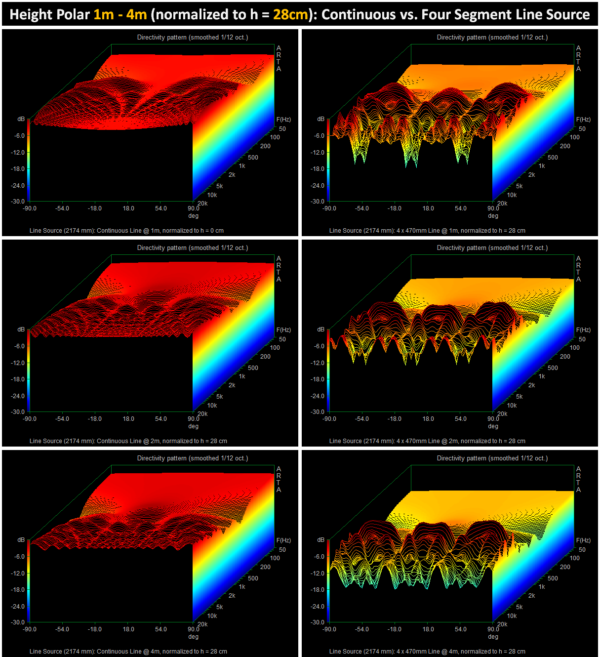

Here are some additional plots of the same data but arranged to see trends with distance for the 3 different formats:
Attachment 1 - 3: Height Polars distance trends normalized to h=0 for 3 different plot types.
Attachment 4 - 6: Height Polars distance trends normalized to h=28 for 3 different plot types.

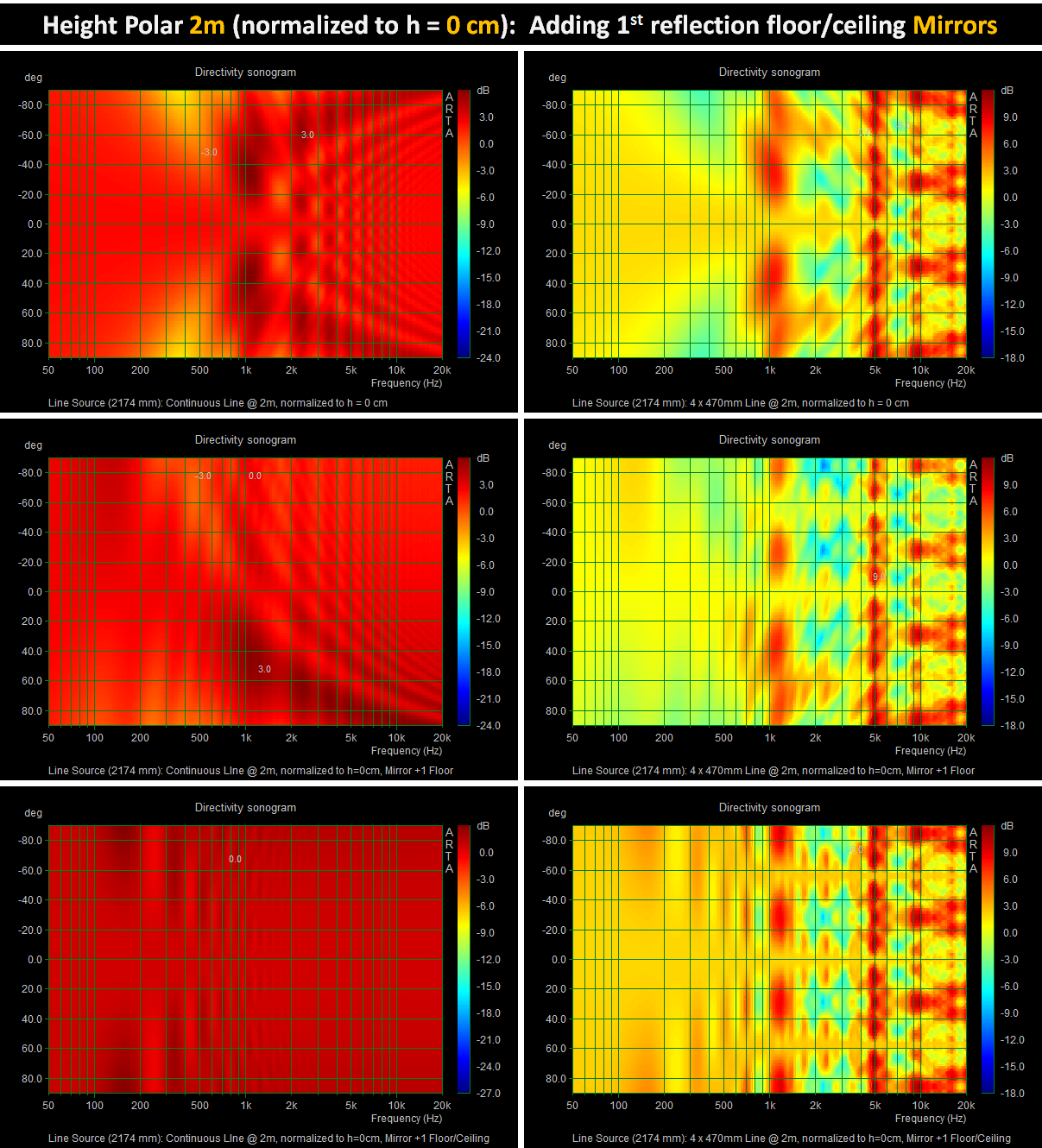

Correct.… Just to be sure I'm starting out on the right track, in each figure the left column shows three ways of viewing the response from a continuous line source and the right column shows one with panels and gaps like my towers. Do I have that right?
I use Excel to crunch the numbers/summations from the Vanderkooy paper and a short VBA script to trundle through the varying parameters of interest(height, distance, angle, etc...) and output binary *.pir files that ARTA needs to make the pretty plots.what did you use to create the simulations?
As golfnut mentioned, ideally you would like to have a floor-to-ceiling line source which will behave like an infinitely long line source with repetitions of any source gaps you have. Stepping our way to that ideal mirroring situation, I added just the first floor and ceiling mirror to the calculations with floor and ceiling placed exactly at the top and bottom of the line source). The first row shows the finite line response with no floor or ceiling mirrors from post#132. The 2nd row adds the first mirror from the floor. The 3rd row adds the first mirror from the floor and ceiling. You can easily see why floor to ceiling ESLs are desirable.When I get home I'll measure the height of the bottom of the lowest panel. The room has 10' ceilings so there's a ~2' gap above the top of the tower.
Adding the first mirrors to your spaced planars pretty much cleans up the undulations below 1kHz, but the issues above 1Khz will remain because of the gaps. I’m wondering if a carefully selected spacing with the floor and/or ceiling could help out (maybe 1/2 the planar-to-planar center spacing?) . I will play with that a bit once I hear back from you on what the actual gaps are.
