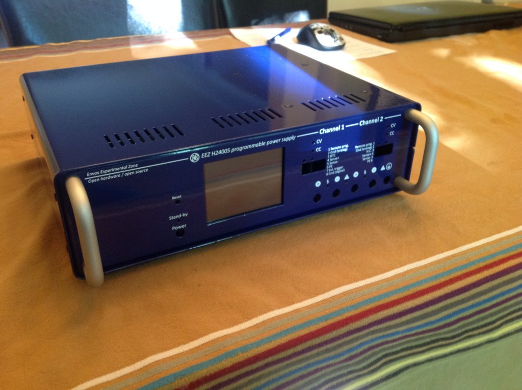

6. Enclosure redesigned and ordered!
This is a nice one. It was on hold for some time mainly because I told Varisom that I’m not in hurry with getting enclosure for this project. In one moment I started to wondering what’s happening and call them to find out if they are still interested or not. Varisom is family business in all positive way what that term means and they indeed care, and it’s different from corporate carefulness (for me as consumer, environment, world peace, etc.). I was on Skype for a couple of hours with shared desktop observing drawing of the new enclosure with all corrections and some new parts. I looks like this (you can also use Adobe Reader to open 3D model in attachment):
Their proposal include:
I already make an order, if someone is interesting please let me know.
- 4-part enclosure 1.5 mm from galvanized steel, drilled and painted in one color
- Two 3-part heatsink, 2 mm Aluminum (they are mounted between top and bottom plate that improve mechanical strength and heat convection)
- Two 5 mm Aluminum thermal bridge (between pre-regulator PCB section and main heatsink)
- Four rubber feet
- AC/DC modules mounting rail
- Two front panel handles
- Printing of front and rear art in one color

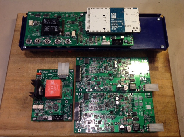

Assembled new boards and enclosure
I spent some time over the weekend assembling power boards and Arduino shield. You can see the results on the following two videos:

New custom made enclosure is arrived
The custom made metal enclosure is arrived two days ago from Varisom in Portugal. It looks nice (color is RAL5022) and it's well manufactured, robust and should survive real mechanical stress. It was my first try to order a custom made mechanical part and there was few issues that I'll cover in some of the next posts. In the meantime take a look and let me know what you think:

Arduino Shield assembling
Until now I assembled three sets. Lots of soldering, but that is really relaxing. There is a few thing that require additional attention so I'll try to create something like "building instructions" page that could help in the process of assembling. In the meantime I'd like to share few things on the Arduino board that should be taken into account immediately:
1. Additional capacitor is recommended. There is no place on current PCB revision but it's simple to add it like this:
2. The Ethernet connector (X18) has to be right angled otherwise it will collide with CH1 heatsink 🙁. But, when right angled connector is used as on the picture below there is no possibility to put a screw to fix TFT display.
Fortunately that is not a big issue since TFT is fixed on all four corners because of 11 mm spacers:
3. Push-in connectors (X12, X14) are 4 mm apart from front panel surface. That does not mean that their pins are not accessible. It's more a question of visual appearance and you can fix that by modified cheap DIL16 sockets. You need to cut it since distance between pin rows in not 300 mils. You also need to adjust their height to 4 mm (my version is 5 mm). That can be done in a matter of minute using sandpaper.
X12 and X14 are not soldered on the PCB but inserted in modified sockets:
... and the end result looks like this:

Chassis is all assembled, nice fit and finish. Most parts for the Arduino are on order, including the processor. There are some very small smd IC to solder! I'll have to take my time.
Keep you posted and Thanks again

Hi. Look what I just completed 😀 After more than 800 SMD parts It is getting close to completion. Front Arduino shield and touchscreen are working, thank to Denis that helped me trace a defective configuration jumper that was causing problem with the screen. All mods are done, now time to test the Aux PS and both Power boards. But first I need to build the wire harness. Thanks to Denis for his excellent assembly guide and instructions. BTW the instrument screen and menu are very nicely made and are a pleasure to use.
Very nice! One thing that I'd like to point out is placement of X2 connector (DC power input) that is here soldered on the top side. I put it intentionally on the bottom side to ensure as much as possible air flow from cooling fan. Idea is to make everything as cool as possible that fan is not run with higher speed so often. For the same reason I'd like to recommend usage of thermal pad as shown on Fig. 20 in the Building instructions.

I'll put the connector on the other side then. Still waiting for the delivery of the last few parts to try the boards. The diode DFLS1100-7 is still B/O at Mouser, but they are expected soon...
