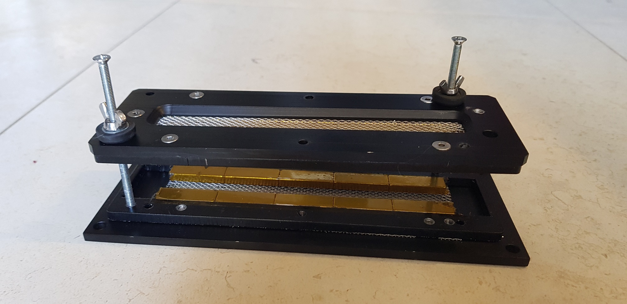

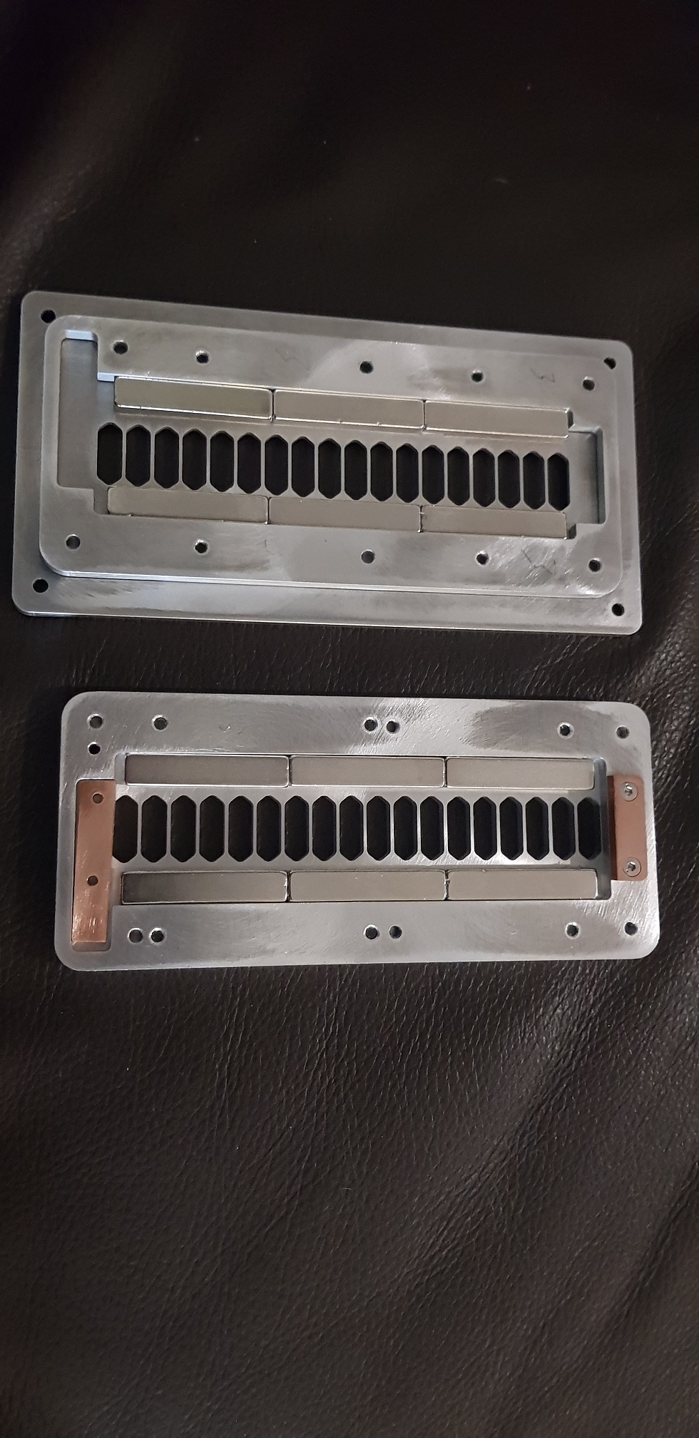

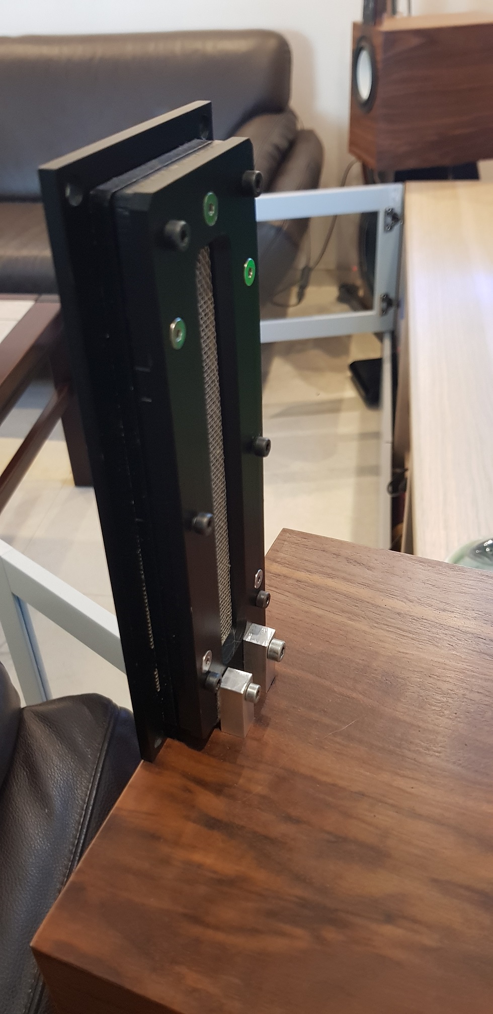

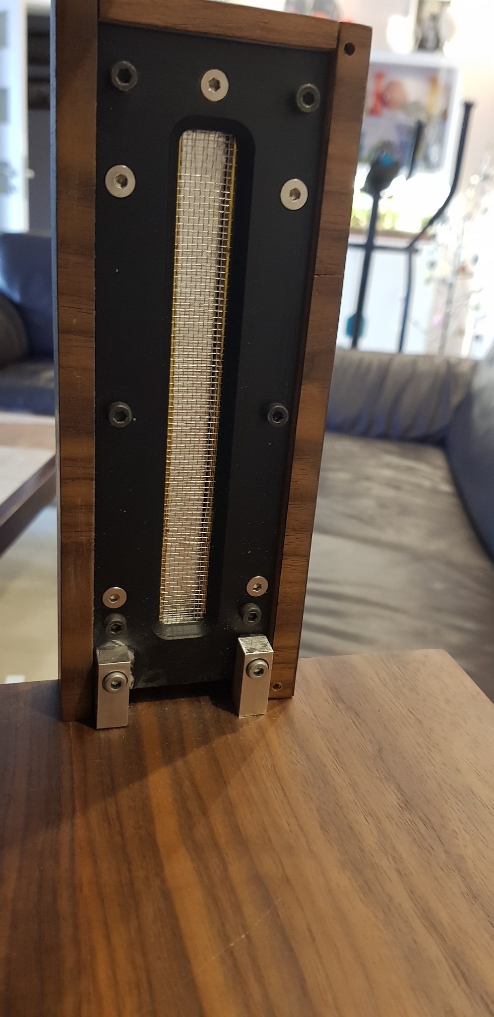

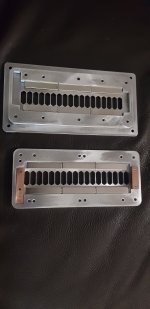

just want to show you how is made similar dipole Ribbon with double magnets and air gap between them. Magnets are little bit different in size 30x10x5 with magnetization through 10mm also custom made. Magnets are not glued but used special device to mount them together.

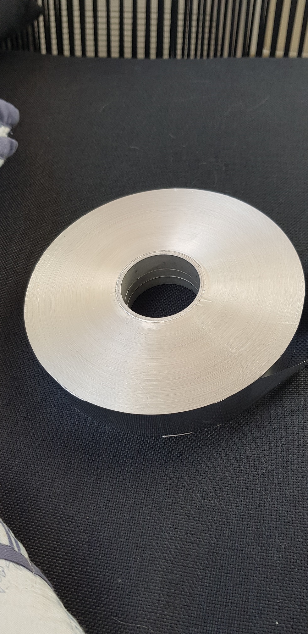

Ribbon tape is 5micron. custom ordered. Body is made of black anodized 5mm aluminium. Crossover is adjusted at 1500 Hz and minidsp 2x4HD used.

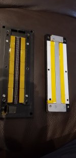

You can see white plastic 1mm between magnets. Membrane is exactly in the middle of this plastic. Difficult to see on photo.
OK, so not in the centre of the gap - right?
What is the sensitivity? Do you have measurements?
Wrong, it is in the center of the gap. I have calibrated microphone but not calibrated sound level. In my DSP level is decreased 4dB. So I assume that sensitivity could be 94dB. Here is youtube link. It is recorded in mono by measurement microphone.

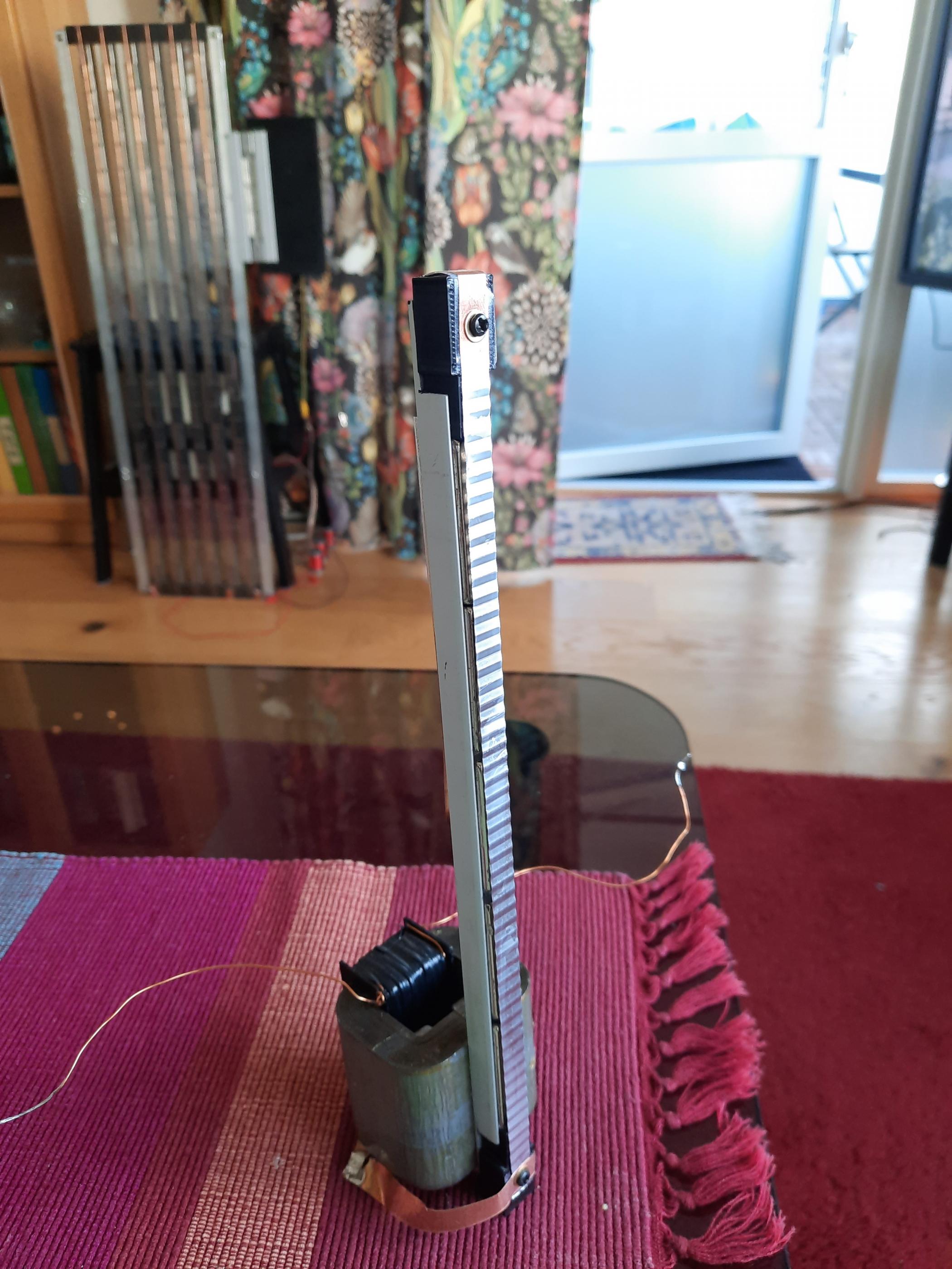

My picture shows a one-row magnet tweeter with poles pointing to left and right, using the field between. Sounds quite good dispite its looks! The transformer core is from a deceased Quad Els-63.
Aha - behind that white plastic is also magnets?
Magnets are glued to aluminium I suppose?

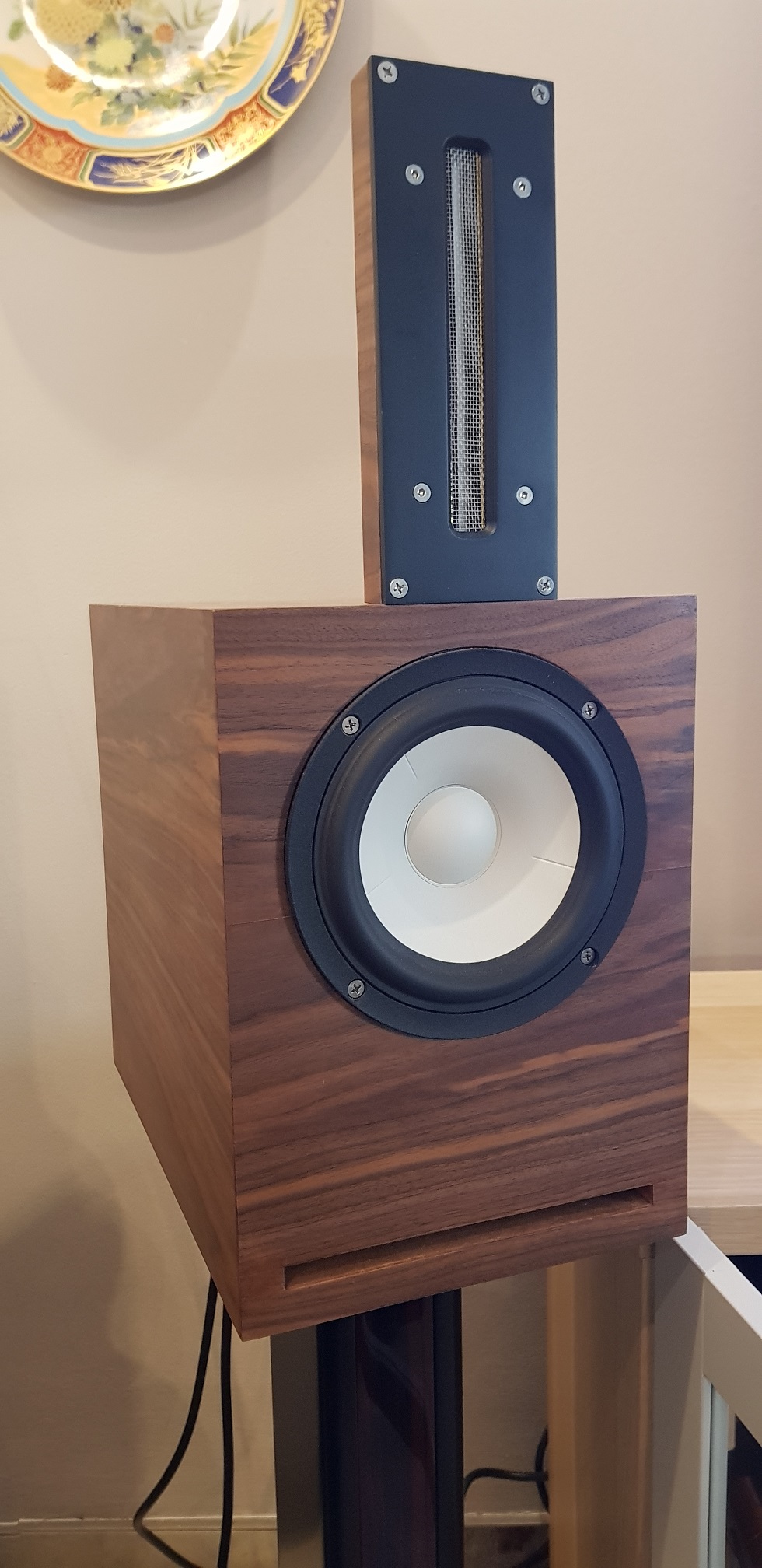

Can you tell the name of the woofers? The sound in the youtube video is awesome!

I think with this construction you losses sensitivity but front dispersion is better. This core is probably amorphous. I also use amorphous core 6.4
Yes behind the plastic is also magnet. Magnets are not glued. Metal frame hold them.
The sensitivity of my tweeter is around 90 dB, but can get to 94 dB with different transformer configuration. Even higher with bigger powerful N52 magnets..
I know that judging sound from a video is stupid, but if You have the knack of 40 years of video listening, you can tell if speakers sounds good or not..
Woofer is ceramic driver from SB-acoustics SB17CAC35-4. Ribbon dipole is sounding so good that can't be compared with anything on the market.

Many things are important to get higher sensitivity. Transformer, magnets, size of ribbon and wire length between transformer and ribbon.
I agree, and in my opinion and experiments, there´s a optimal ribbon lenght also at around 140 to 200 millimeters.
My ribbon is 150x14 mm. In youtube video you can see also my big OB system with ribbon 300x25 mm. Long ribbon is problematic and doesn't keep uniformity. It is supported on the middle.

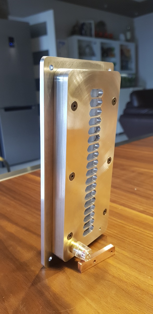

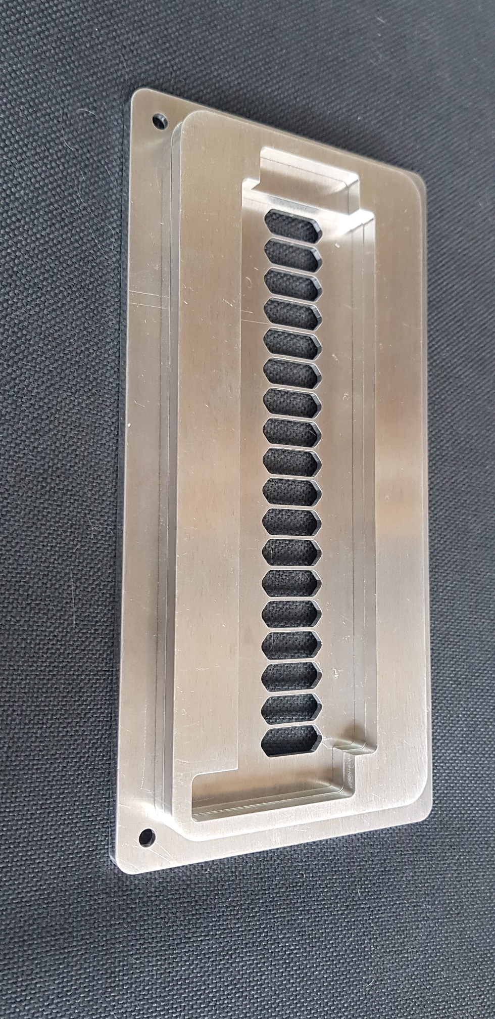

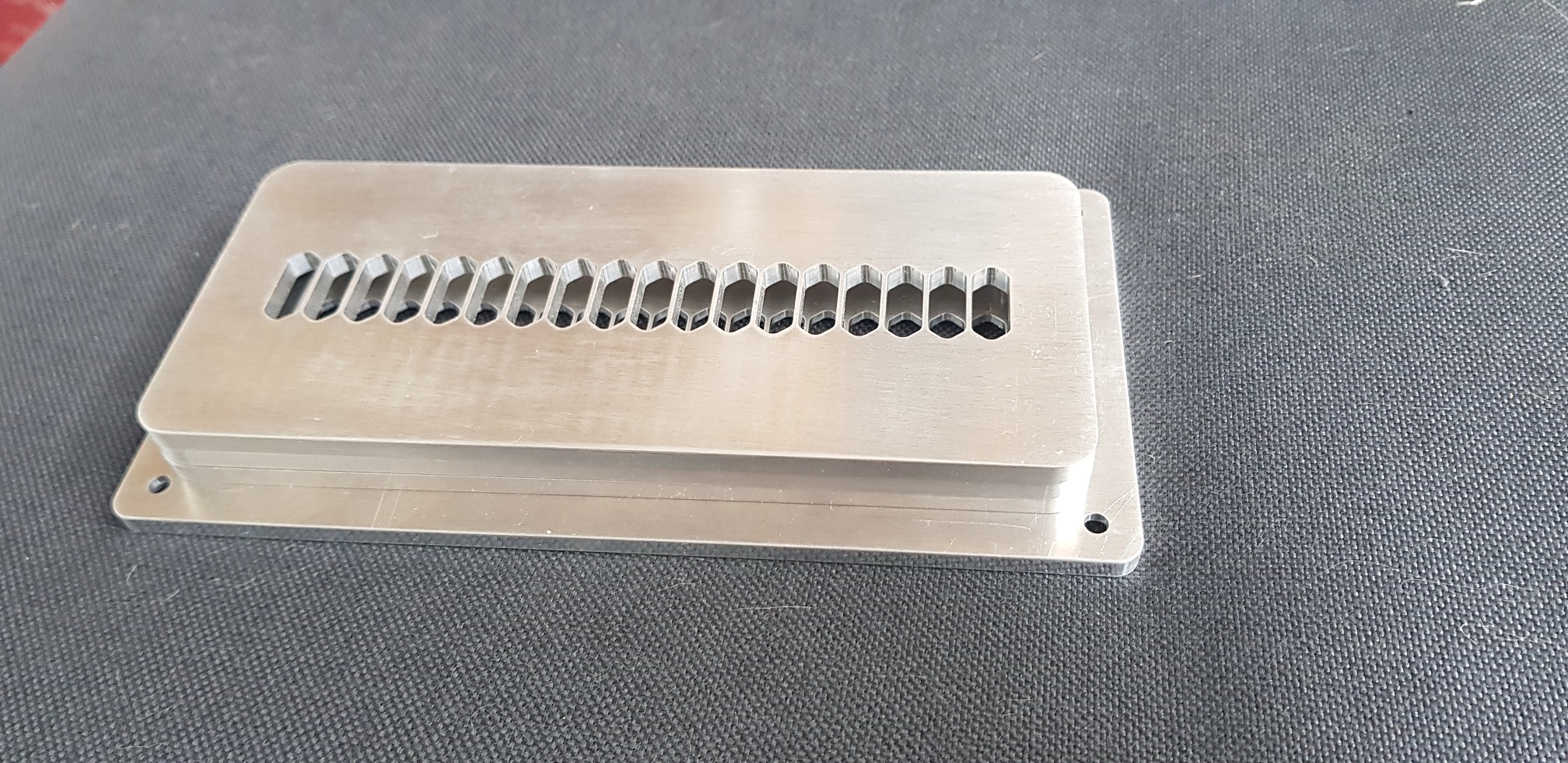

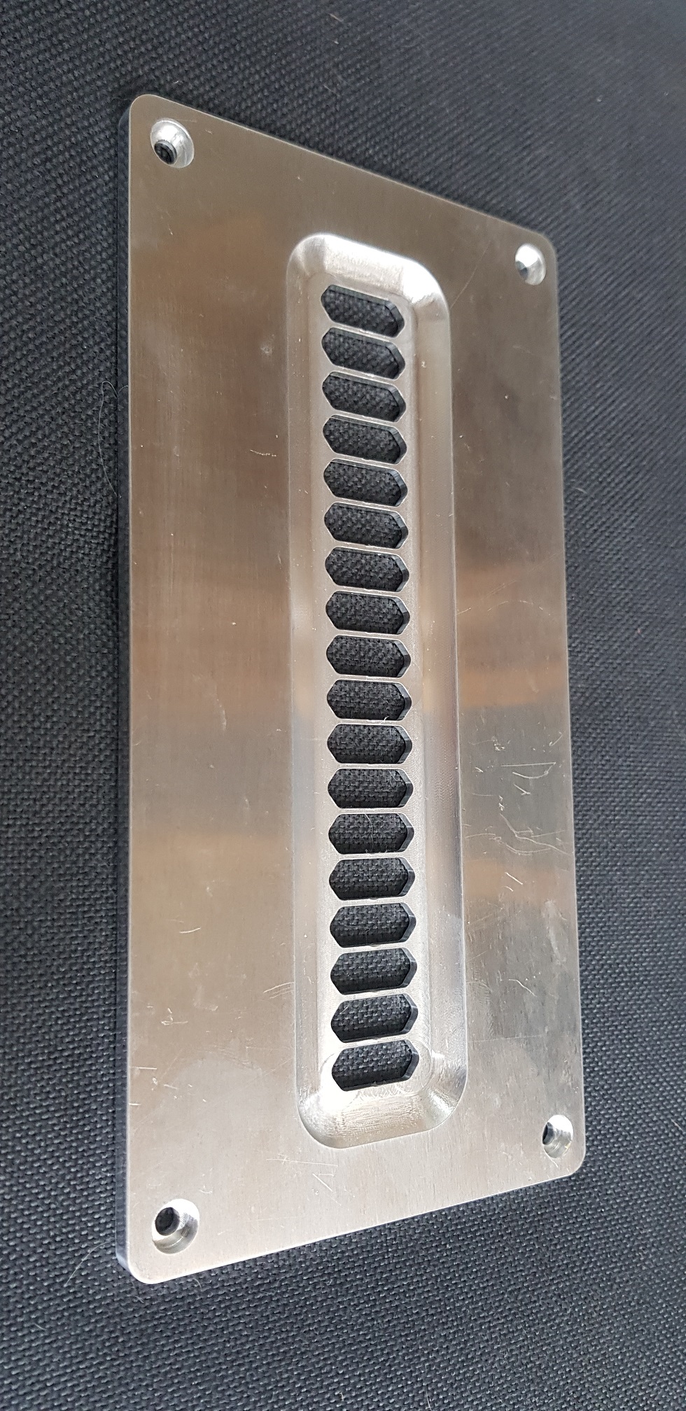

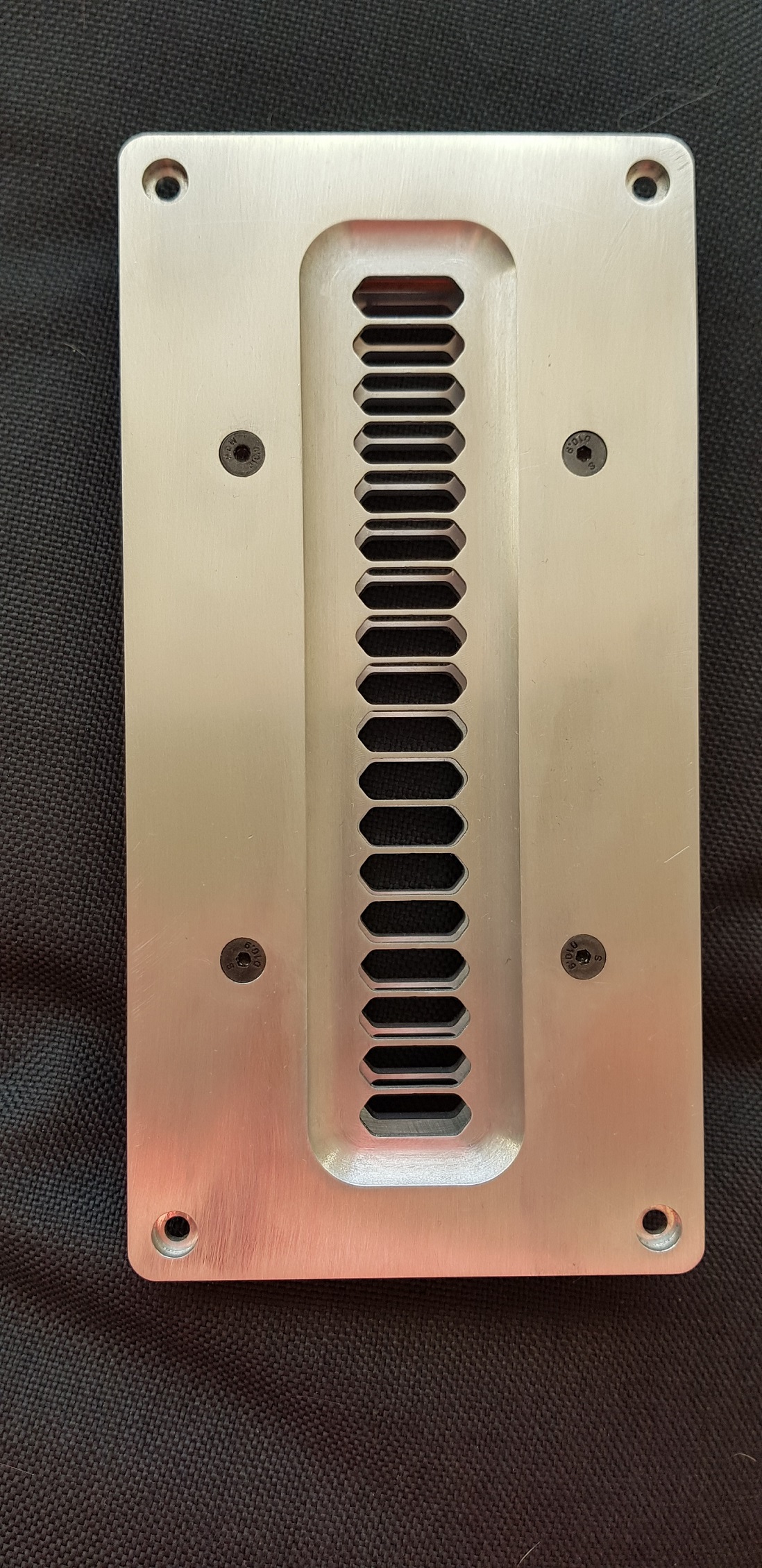

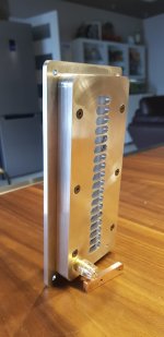

I meant to say this when you posted. That is a thing of beauty! I can only imagine they sound as good as they look. I look forward to seeing your report on performance when finished.This is my new ribbon design. CNC milled aluminium.
cool design, it used these double magnets with a small space in between them to create a more even and wider fields like the Dahlberg Audio Design one >? believe apogeee used it in there midrange to. its ideal for the type of construction you made with a back plate with magnets and spacer forming sort of one half of the construction. interesting !!
You can see magnets in double constructions. Design is flexible and can accept double or single magnets. Foil contacts are not anymore aluminium. Now is made of copper with 100% pure tin plated
