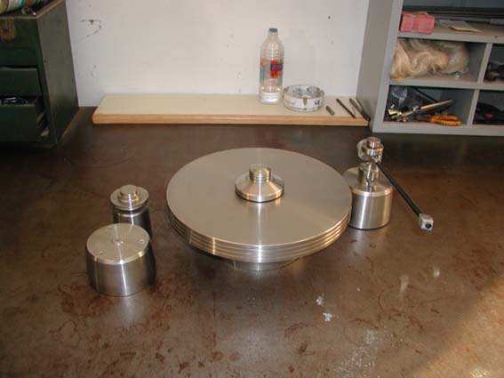

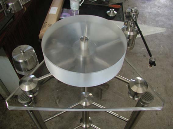

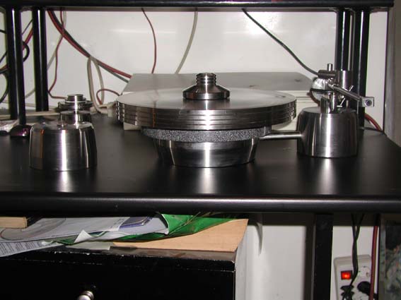

DIY Turntables and Schroeder tonearm clone.
Here are some pics of my DIY Turntables and Schroeder tonearm clone. I'll post some more detail pics as soon as i get my digital camera back (Did you heard that Chris?:goodbad:).
Meanwhile, anyone want details of the cosntruction feel free to mail me.
Regards
Konstantin
ktzivleris@hotmail.com

WOW! That is beautiful work.
I think many here will be interested in the actual machining plans in terms of how the magnets are connected to the base and arm :bigeyes:
As a side note to Hartmut, I recieved my magents yesterday - although very strong, they dont seem to have 10KGs of attraction. One set, about 8mm wide and 6mm tall could lift about 2KG. Ones about 12 X 10 mm - I could not seperate with hand strength.
Konstantin, any comments or advice about the magnets you used?
Regards
Mike

Mike,
There is absolutely no way to drill these magnets without destroy them. Neodymium is Very hard but is also very corrosive and even if you drill them you will take of some of the hard Chromium they have on the surface to prevent corrosion. What you can do is to order predrilled magnets as i did. 6mm X 6mm rod with a 1.5mm hole in the middle.
