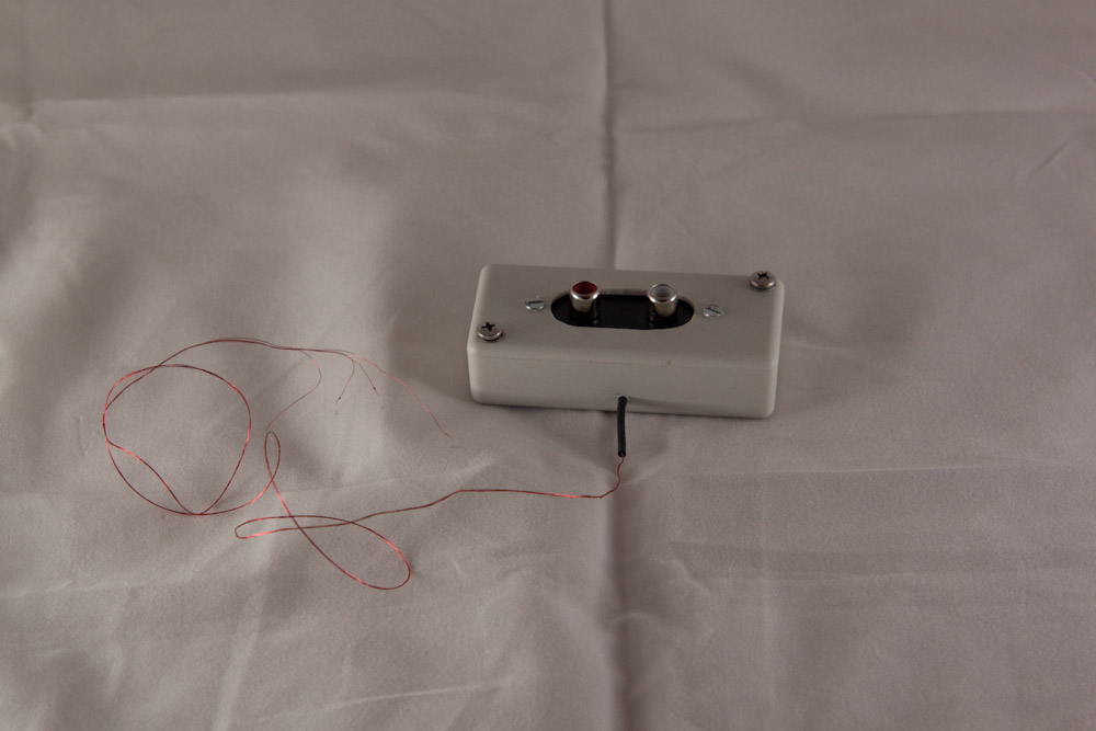

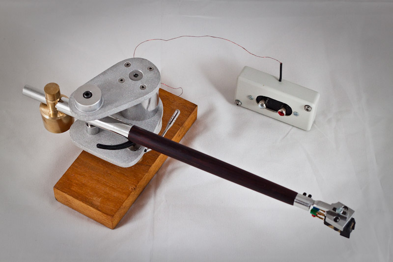

I did the wiring loom for the arm today. I'm using some incredibly fine transformer wire - the original wire is about 30 or 40 of each strand together. Anyway, its what I used on my air-bearing arm and to my ears it was better than silver in teflon or cardas stuff. Its very fine, so working it is a pain, both for keeping it together (hard to even see it LOL) and for working it. A little tug and it breaks. But in 2 years of use on the air bearing arm, there hasn't been 1 problem - and it certainly won't interfere with the arm movement.
Anyway some pics included below. Next up is the counterweight which is weighing in at 165g.

hi Fran i see its really coming together now. and i know from my own work it can become quite exciting as you've done it all yourself. your carts sound quite exotic and expensive for a poor engineer like me but who knows in the future. i cant wait to hear about how they sound good luck.
Bravo Fran!
What gauge wire is that? Very fine indeed and looks to be a PITA to work with.
Please continue posting pictures, they are inspiring!

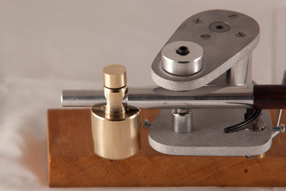

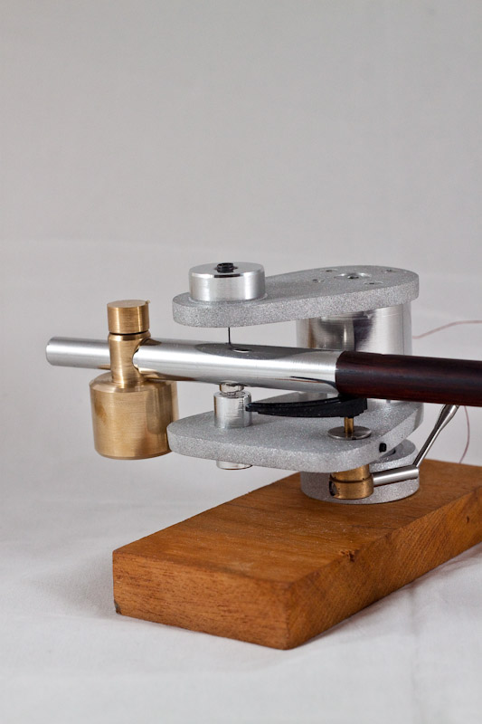

Anyway, moving swiftly along!! Counterweight pics:

Ohhhhhhhhhhhhh, I like the sandblasted finish. good thinkin'
Coming along very nicely, I dare say I'm jealous of your progress. How much of your build was done at a machine shop? or do you have a metal lathe yourself?

Renron; sandblasting = no sanding and polishing on bits that I can't hold in the chuck and spin!! Not redhead, black (well I like to call it black, hats left of it)

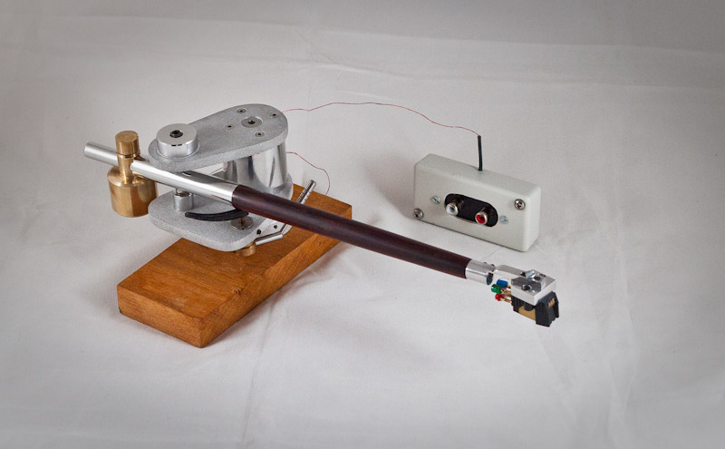

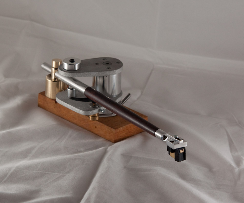

I got her finished, cleaned and wired tonight. I'll be taking a few pics tomorrow night all going well.
Fran
The Denon DL110 and 160 are fine performers in general at low cost. Haven't tried them with this arm though. They are a bit brighter sound, maybe more detailed than the 103, more resolution. Not quite as musical maybe, but its a all a swings and roundabouts game anyway.
Anyway, as I mentioned above, I did my final assembly last night and took some pics this evening. More p*rn for you lads!
Fran

Hi seanb, i use a 103 in my 12inch version, and a DL110 in the 10inch, but sound excellent, even when compared to more exotic fare.
FWIW, i find the 103 to have a bigger more solid sound with more body, and perhaps more dynamic on rim shots and such. Either way, both very enjoyable.
Nice work Fran!!.
