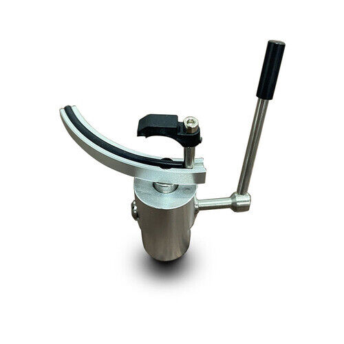

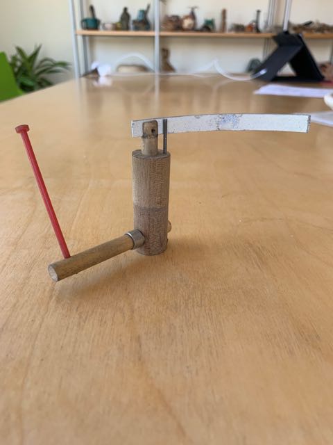

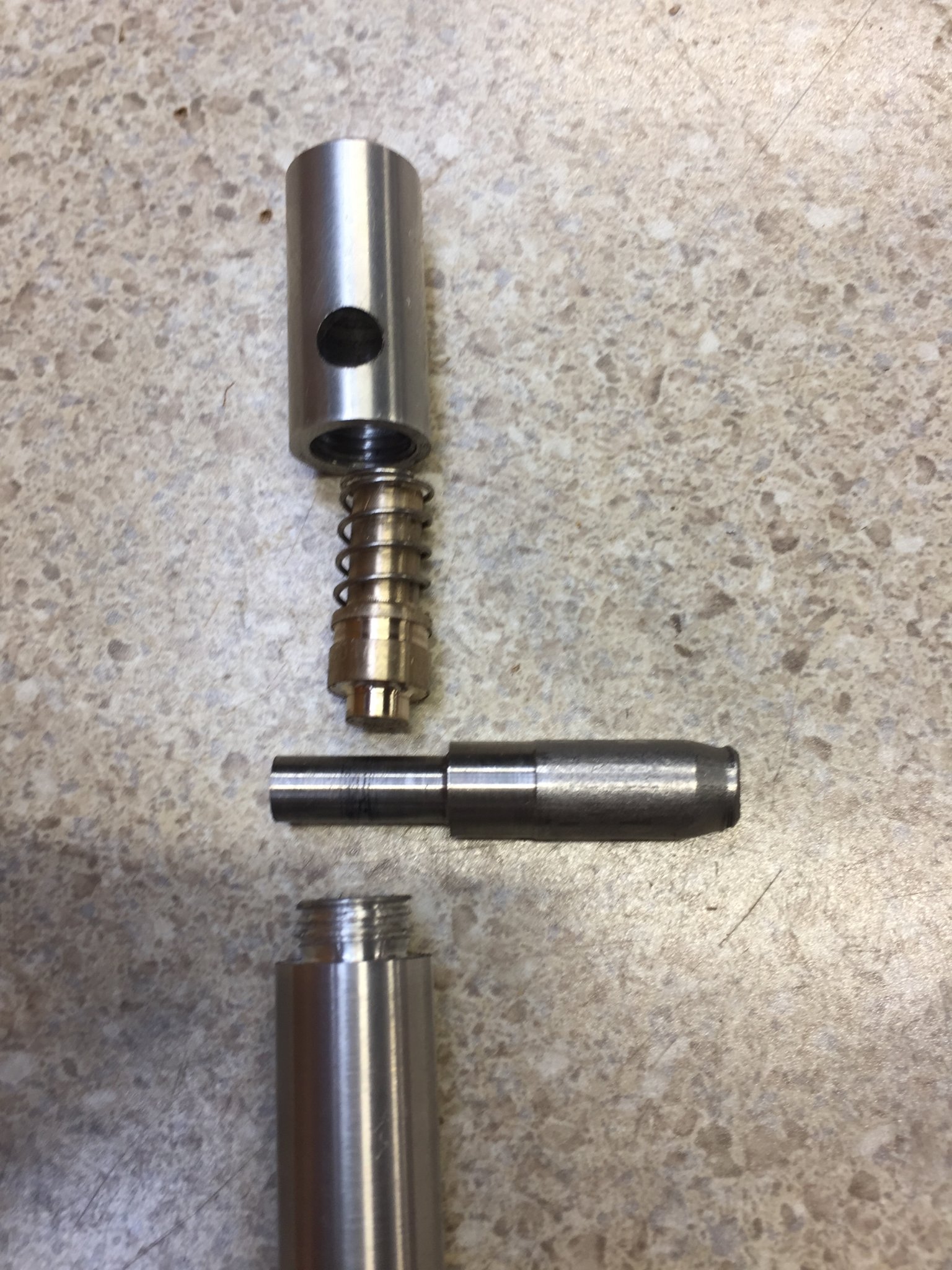

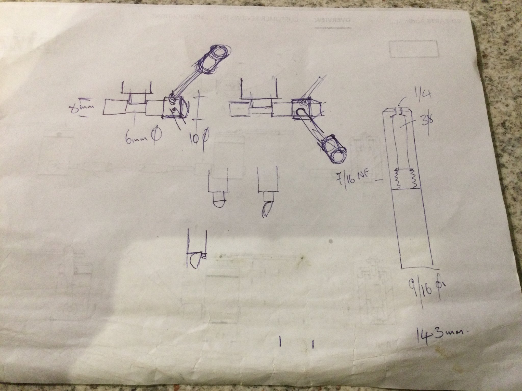

I used a readily available Rega armlift and modified it to suit how I wanted it....I needed the arm not to be able to slip off.

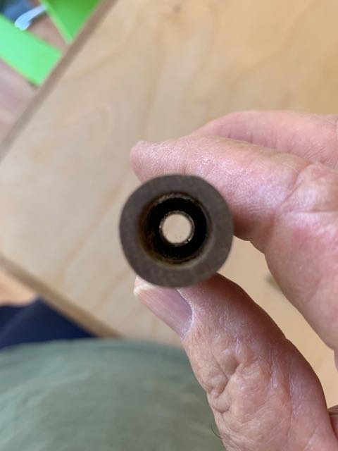

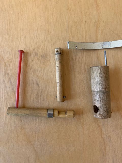

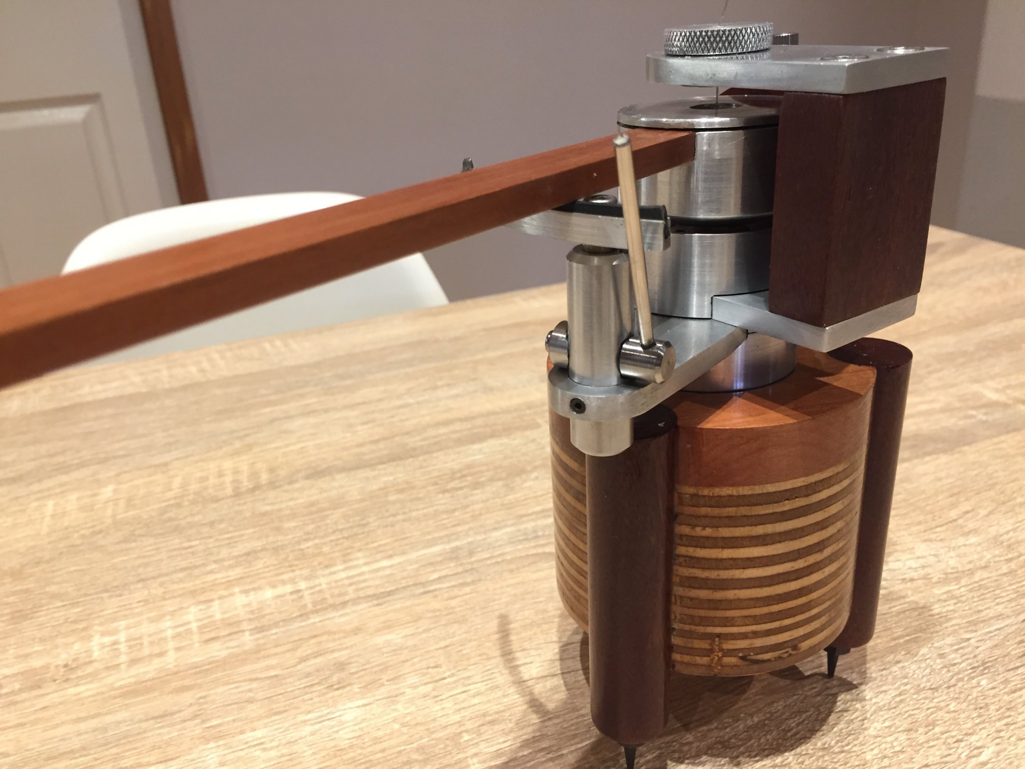

I built mine similar to a design that I found online, it works fine.
First effort from a while ago, but the principle is the same and it does work. Even though I wouldn't allow it in the same room with the beautiful Schoeder clones in this thread, it has the advantage of being build-able with a drill press and hand tools. The inner spring is missing. Your proposed materials should work well. I found that a pin to keep the carrier from turning is helpful.

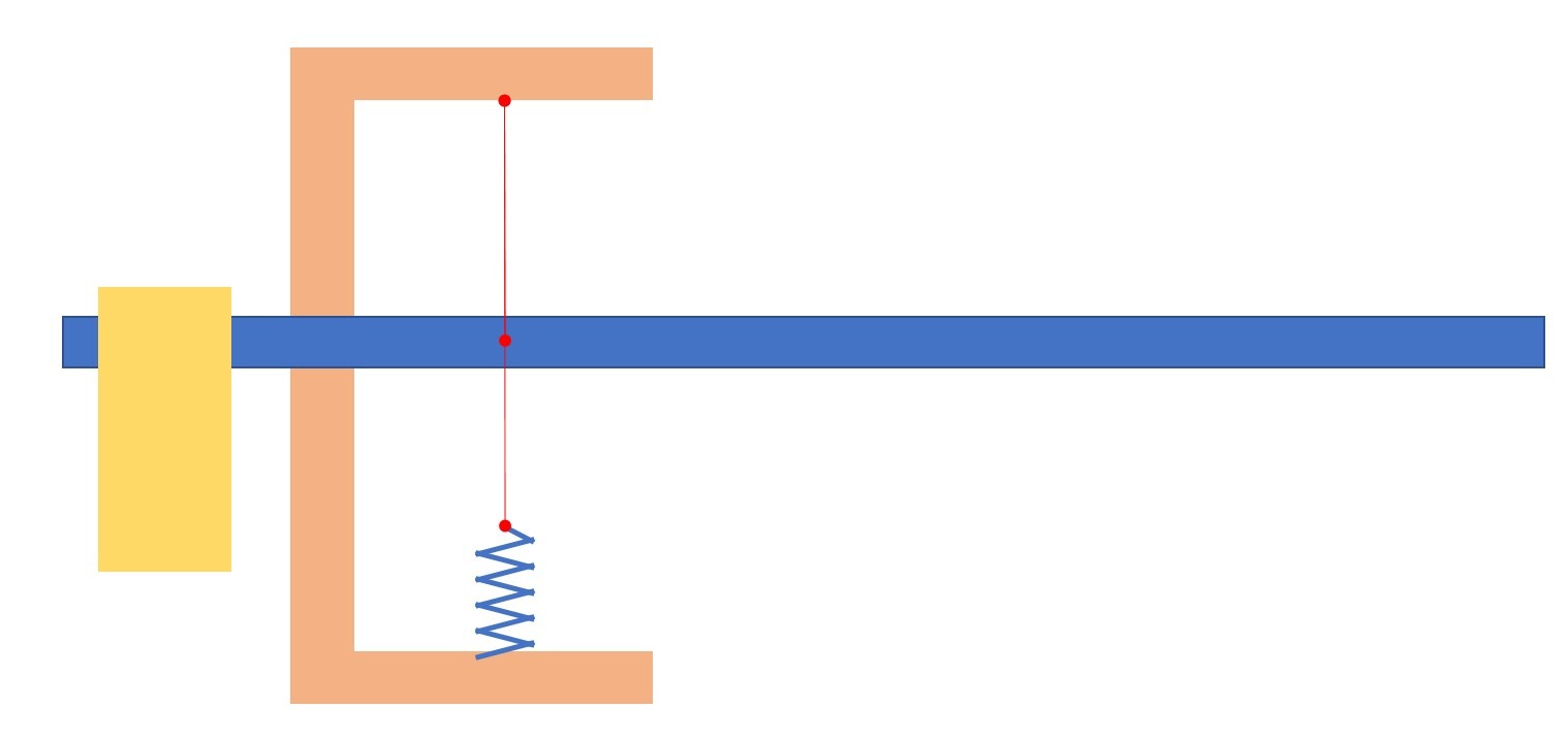

Hi everyone here. I just found this thread and was impressed by all the hard work you did. I must admit I haven't read all 1500+ posts, and maybe my question has been already answered, but I'll ask it anyway: Why all the effort of dealing with magnets? The role of the attracting magnets is to keep a vertical fishing line under tension. Why can't this be achieved using a spring???

In fact I think the magnets solution was preferred not because their charm, but because it allows the magnet end of the string rotate freely, thus helping the anti-skating function of the string. A wire rigidly mounted at both ends (the spring can ultimately be removed altogether) makes the wire much stiffer in terms of torsion.

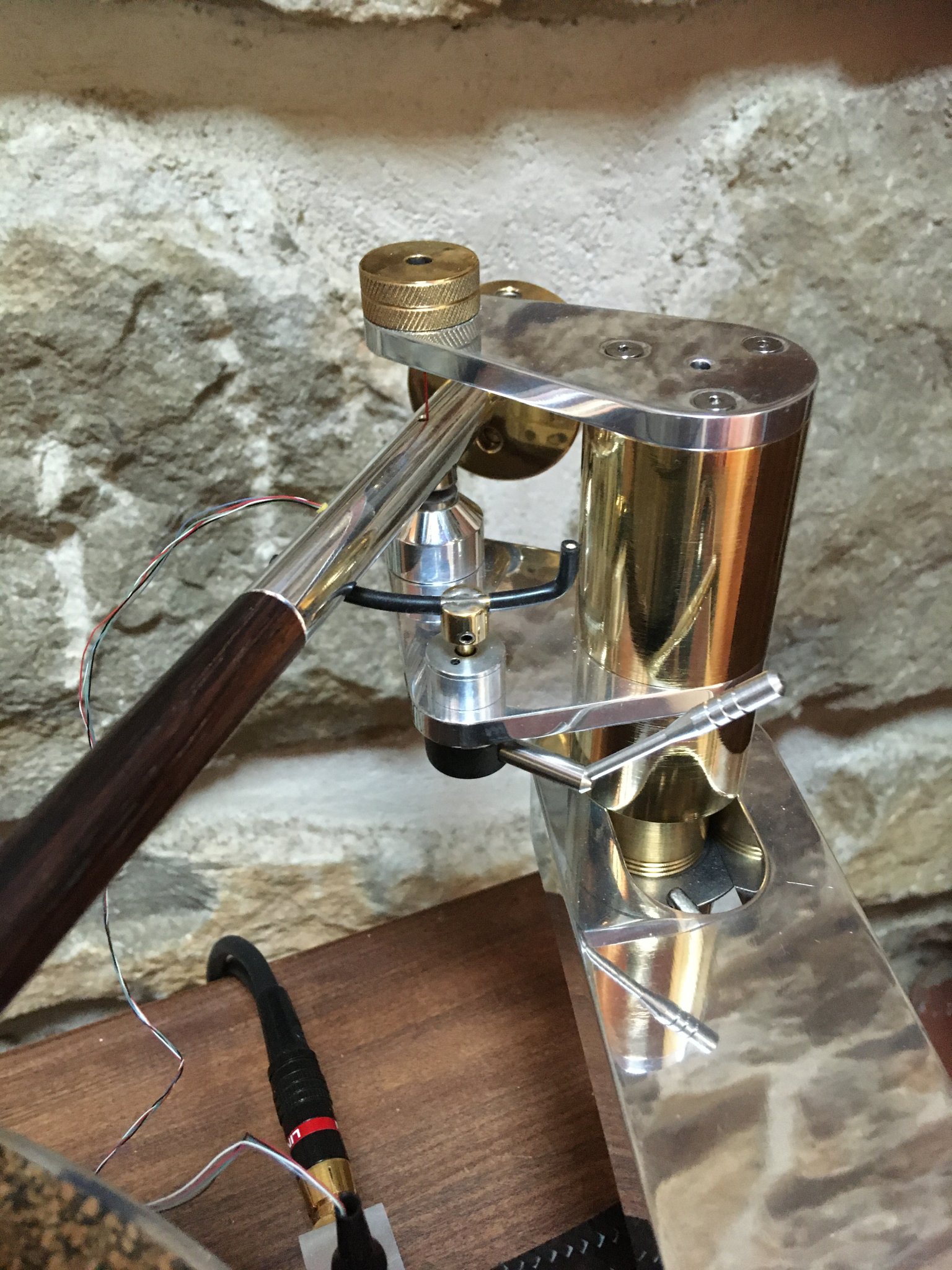

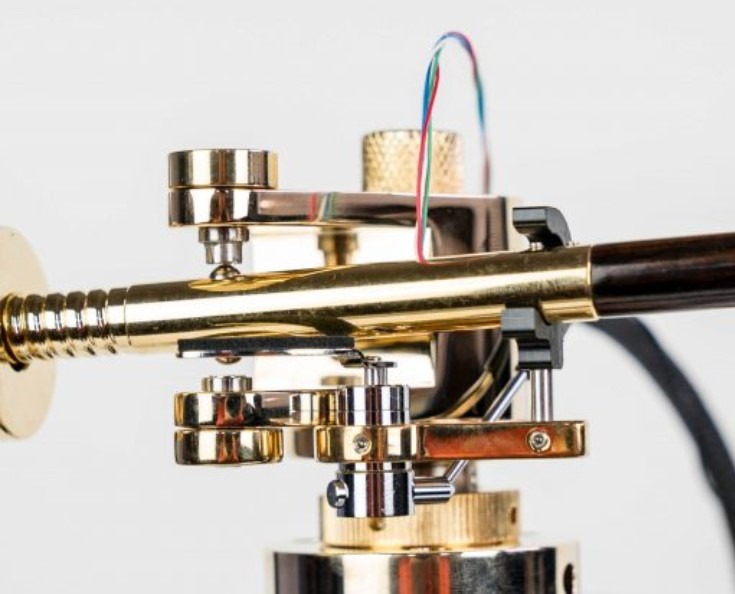

Unipivot, yes. Repelling, no. The TA is suspended by attraction to the top magnet and attracted by a bottom magnet just as much as needed to maintain a correct azimuth. It's genius idea. No friction, no bearing chatter, just free movement! I had a close look at the few YT movies covering this TA and I think the anti-skating is also magnetic, although in one of the movies one dealer claimed anti-skating is done by the audio cables, which is laughable for a $20K TA
Reactions: alighiszem
Seriously ? $20k. ?
That is an obscene price for a flawed design. The fool who pays that price without being fully aware of the problems with it deserves to have their money taken from them.
Herr Schroeder will make them three tone arms for that price I would imagine ....and they would work properly.
Having run my clone now for quite some time I know that , if I had the money , I would put my name down for a proper Schroeder made Schroeder in a heart beat.
( roll on that lottery win !!! )
Reactions: Adelmo

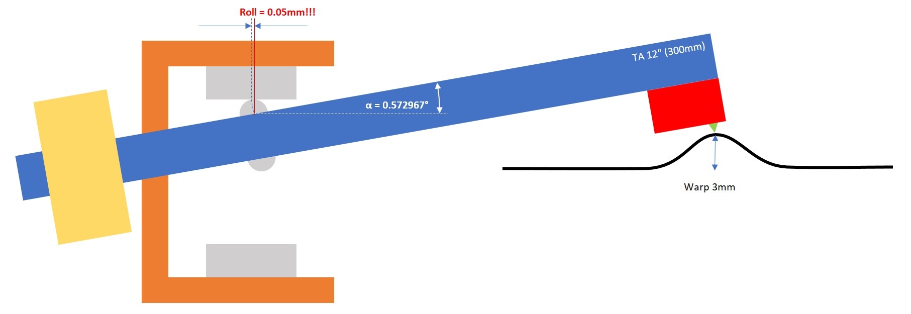

The tonearm rolls on the upper bearing when vertically moving.
Not good.
My dear, I understand your concern and theoretically, at least, you are absolutely correct. BUT! In real life, engineering design in general, and tonearm design specifically, is an endless chain of approximations and tradeoffs, the most obvious being the huge 2.5 degrees tracking error of the pivoted tonearms.
My engineering background doesn't allow me to buy into hypes, no matter if positive or negative, before crunching the numbers.
And here are the numbers. The roll you mentioned is a mere 0.05mm. Please keep in mind that the width of our hair is more than double at 0.12mm!
And to be honest, I doubt that even a high end turntable setup by trained professionals using the manufacturer's protractor could attain such precision of the spindle-pivot distance in the first place!
Of course the drawing is not to scale and hugely exaggerated in order to make that roll visible.Triangleart_Osiris_MK2_Roll.jpg
